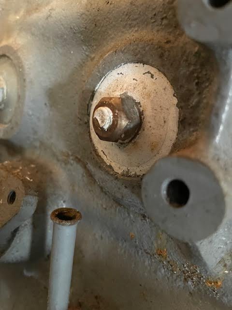

Need a little help here. What I'm guessing (I live in Florida) is one of three freeze plugs on the right side of my Austin A engine went flying, followed by flying coolant.
The conditions were: Sitting in the driveway, reving the engine following a carb adjustment, just passing 140 F, about when the 7 PSI/160 F thermostat cooling system pressurizes. The disk (first photograph) labelled 1014 and 1 5/8 (its diameter) flew off, with the coolant following very promptly. Hate to have that happen while I was driving. My other engine (second photograph) has bolts through the disks that go to bars on the back side which may be holding the disks in place.
So, do I drill a hole in each of the three plugs and rig a way to hold them in place? Are these things frequent fliers? I hesitate to simply press the plug back in place.

If you go the way the 2nd engine is, you have to figure a way to seal that bolt hole...
I'm assuming that it's the "flat" style of plug, just a slight dome to it
By the picture of the plug on Moss, there should be a step in the hole for it to sit against. It just taps down to that , and then you use a blunt punch in the center to push the dome in a bit.  I don't see a mark from that being done last time. It will push the rim out a bit tighter in the hole.
I haven't done one in YEARS, but our go to sealant was always Permatex #2
If the bore is straight all the way (no step) it's a cup style. They just drive in, dome to the inside. Use a big socket to drive them

A friend much wiser on these things than myself advised that I only use brass core plugs, rather than the more commonly found galvanized steel.  The last engine I left at the machine shop (a shop that I trust), replaced the cam bearings, measured and hone the cylinder, etc. replaced my core plugs with brass.  Being the material they chose corresponded with what my old friend suggested, I figured the shop chose wisely. ;-)
As usual, wonderful help. Thank you. The air-borne plug has been slightly flattened but I think will tap into place. I'll let everything dry, then put a little Permatex around the edge, tap it into place, and then give it a couple of moderate whacks with a socket, 1/2" extension, and two pound brass hammer. I've already hosed the driveway (dogs get poisoned on ethel glycol; it tastes sweet) and showered off all the coolant I got in the face. Unfortunately, the plug that thought it was a frisbee was immediately above the dip stick, so an oil inspection is on order as well. Hey, this is not the first time that MGA With an Attitude has had a very informative article.

I don't think reusing a core plug is a good idea.  Do you think the others will stay in place?  I suspect there is something amiss about the installation or the plugs, or the seal had sucom to corrosion, and it would be the same outcome for all eventually.
I'm not in the brass camp. I think surface prep and proper installation is key regardless the material.
Tim, this isn't your fault,  but I wouldn't trust core plugs past 20 years.  Most cars don't last 20 years, so it's not common to see them fail.

I've had to replace several decades old steel plugs that had eventually failed/leaked due to corrosion from rust through (not the edge). I use a finger wipe of rtv on the edge before installation. The plug metal is very thin sheet metal and the first thing to go from rust. If you don't have good access with a hammer, pick up a 1-1/2 rubber plug at your local store. Here is a link to 1-5/8 but it may need to be slightly smaller to clear the recessed lip.   https://shop.advanceautoparts.com/p/dorman-help-rubber-expansion-plug-1-5-8-in.-size-range-1-5-8-in.-1-3-4-in.-10232/22140133-p?product_channel=local&store=3841&adtype=pla&product_channel=Local&store_code=3841&&&&&msclkid=cfb785ea93e114756d3ceccab7900024&utm_source=bing&utm_medium=cpc&utm_campaign=b_shopping_all_dorman_gen_gen_gen_evergreen_eng_aap_us_all&utm_term=4580221855580131&utm_content=Bing_All_Dorman - Innovation_Body&gclid=cfb785ea93e114756d3ceccab7900024&gclsrc=3p.ds

Thank you both.  I think I'll proceed with the plug as a temporary until two weeks from now when I'll be driving by an Advance Auto Parts. It may be a cold weather job getting the other two out.

I'd take a screw driver to try to clean the rust scale/deposits while they are out and flush with a water hose and the lower hose off. They tend to collect in the corners furthest from the water pump and can break free to clog radiator tubes.

Never use a freeze plug a second time . The brass plugs don't corrode like steel ,and the rubber expansion plugs will pop out
