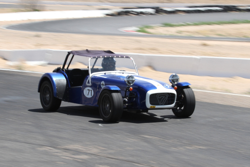

redursidae Posted April 3 Posted April 3 Thank you all for the warm welcome and answering questions on my first post. I've learned much about the car thanks to your help and reading around the forum. The story with this Caterham started after a fantastic 2 day trip to Arroyo Seco Raceway in January where I met Josh from Rocky Mountain Caterham, Nathan Down, and 4 Caterham owners that were very welcoming to me hanging about. It was a very special weekend to say the least. After the trip I knew it was time for a se7en and the Chief Financial Officer didn't object too harshly to the idea. But wasn't sure how or when to make it happen. I was interested in MK Sportscars with Miata components because I know Miatas well and were within my budget, but a few days later I get a text: Quote At a birthday party thing last night I encountered a guy who is selling his Caterham. And his trailer. He's emailing all specifics to me. What's your email? I went to look at it with friends, and seemed like the right fit. Much man math later, one car sold, and I was able to bring the Caterham home. It is a 2006 Caterham SV with the Ford Focus SVT engine. Has regular floors, adjustable Bilstein dampers, 15x6.5 wheels and 195/50/15 R888R tires, Raceline wet sump, and had 1335 miles on the odometer. I don't know where it was built or whether it has an LSD. The previous owner did not drive it on the road much and most of the 800-900 miles he put on it are track and autocross miles. It is well broken in I've spent the last month getting acquainted with the car, catching up on maintenance and definitely not plotting mods. Some items addressed so far have been to install the headlights, fix a couple of issues with the tail lights, a quick ride height adjustment, replaced the timing belt and a fresh oil change. The front ride height was too low before, at 130mm and 25mm rake. It's now 140mm front and still 25mm rake. More adjustments, an alignment and corner balancing are needed. The timing belt was original from 2002 and I did not feel comfortable driving with it, even though it looked ok. Also put fresh spark plugs to have a baseline. The plastic end-tanks in the radiator were leaking, so ordered a new aluminum radiator. A few "while I'm in there" happened and I swapped all the clamps for some without hose-eating slots and replaced a heater hose that was cracking too. Also found that my radiator fan has the shorter style mounts, and had to get new extensions. I'm currently waiting on the extensions to arrive so I can finish the job. Before the radiator job started, I did an oil change to Amsoil 5w-30, because the weekend prior I drove it through the mountains and oil pressure was right at 1bar at hot idle. A bit too low for my liking, and figured a fresh change would be a good starting point. The first drive on the new oil seemed promising but that was on a cooler day. I have driven the car 170 miles so far. The power and torque is awesome, and definitely the fastest car I've owned. The suspension feels better after the ride height adjustments but it is still a bit stiff. The exhaust sounds good and pops a lot on decel which is growing on me. Next thing is to keep driving it to shake out the gremlins, dial in the suspension, and do an autocross and trackday to find what to do next. But I do have a wishlist for once I have the Miata's engine finished: - 13 inch Apollo wheels + Nova tires (wet sump clearance is a concern though) - Soft Bits for Sevens Half Hood - Aero screen - New belts - Tillett seats - Trackday roll cage - Standalone ECU still to be decided (Leaning Haltech or Link G4X) - Borla Induction or AT Power ITBs But overall very happy, and glad to have finally joined the se7en community 6 1

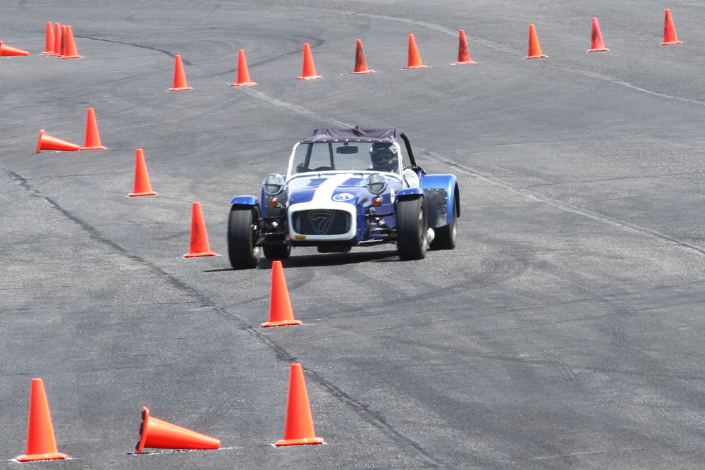

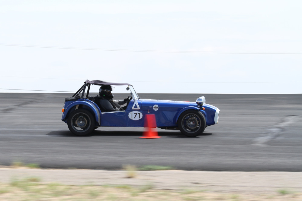

redursidae Posted April 3 Author Posted April 3 One more picture taken by my friend in our first blat together 2 1
redursidae Posted April 3 Author Posted April 3 HA no, not yet. I’m still building condidence with it. It did very well in some hairpins in that mountain drive, so that’s promising.
