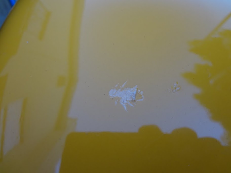

When I had the car repainted 3 years ago, I covered it all with Aeroguard polyurethane paint protection film. This is one of the 3M retail versions of the ClearBra and apparently 3M has bought up all brands of such films, anyway.
After only this short time, maybe 15,000 miles (admittedly with maybe 100 miles dirt road), the film looks pretty ratty on the rear wings (see pics). Obviously from small rock blasting and occasional large rock gouging. Surely better than paint chips although I can not say if the paint below is unaffected.
Anyway, I was just wondering if that is common. The thin solid rubber sheet I have in the main impact area below is almost undamaged. Also, the original Birkin gel coat did not look that damaged after 10 years, just a bit sun-bleached.

Clear Bra can not take the full firepower of the front wheels. I use it to surround the aluminum shield, and it works well. However while doing a tiny course at a British car show, I hit a cone at low speed. It scuffed the Clear Bra-- and scuffs wont buff on that stuff. (I won BTW)
So here's my view: Clear Bra helps a lot to avoid 'chip outs' and reduces the sandblasting effect, but it is definately not immune to turning ugly. Its great on the leading edge of the nose cone and around the rear fender metal shield.
There is no perfect solution to the rock damage to the rear fender paint. My aluminum has real dents in it and is getting so ugly I am going to replace it in spring (one more winter to beat it up). The dents are so big that Clear Bra would not have protected against those rocks and I'd have to repair and repaint without the metal shields. I may redo the clear bra when I replace the shields, and add some to the nose cone (wish I had before). I had it done by a shop and it was too expensive. I'll do it myself from now on.

After the first 1,500 miles the stainless rock shields on the rear fenders looked like they had been in a war zone. I had them covered with bedliner and at 14.5k miles they look like new. The clear bra around them has taken a beating but looks much better than an area at the bottom of the fender which didn't get covered which has almost no paint left on it. Next time I will have the bedliner applied directly to the fender in a slightly larger area than the rock shields.
There are a few cuts in the nosecone clear bra from sharp edged rocks, one even went through the paint to the primer.

I have the clear bra on the endire car and while it does its job of protecting the paint it is "non-repairable" if it gets scuffed. I have a couple of places on the hood and top of the fender where some plastic car parts from a wreck ahead of me came sliding up and over. I've tried everything to get the scuffs out to no avail. Also two spots on the lower section of the nose where the same debris left large "bubbles" in the plastic film. The top scuffs would have buffed out of paint, the two on the nose would probably been less visable on paint and touched up.
As for protecting the lower outer edges of the rear fenders, all but gone and looks worse than nicks would.
I'd be 50/50 on doing it again if the car was ever refinished again to a solid color. With metalic paint I think it is probably a good idea as repairs are harder to match.

Thanks guys, looks like that is quite normal. The film suppliers just leave one with the impression this solves all the damage problems. I will keep this film on until it looks too ugly and then replace it, maybe with the thicker headlight protection film. And I may extend the rubber shield a bit further up the rear wing.
