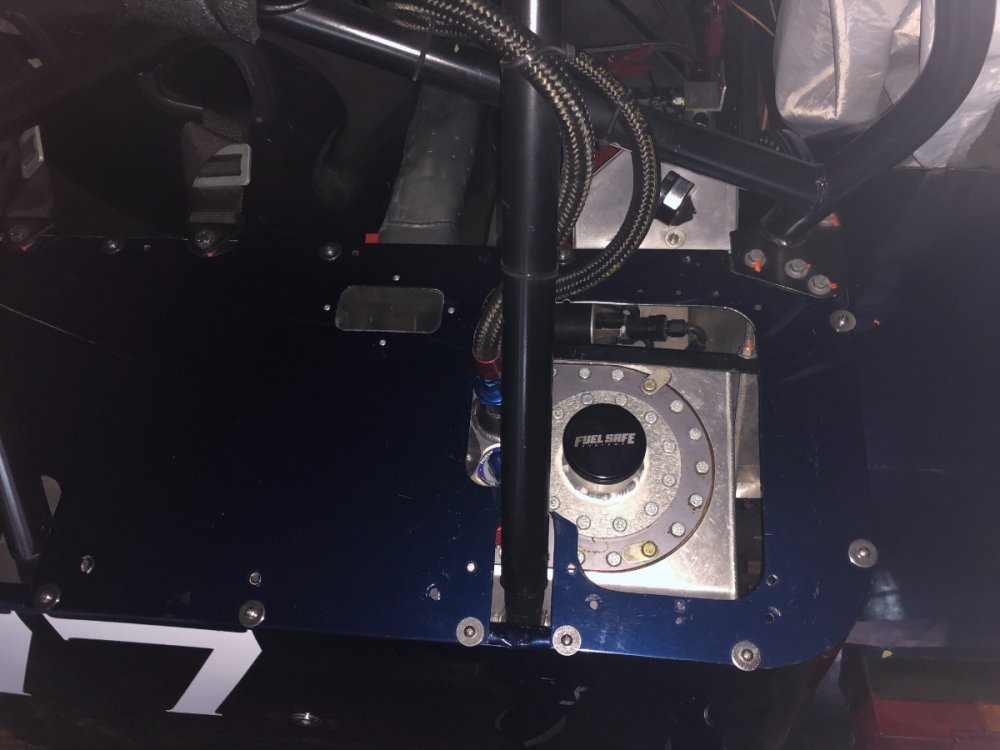

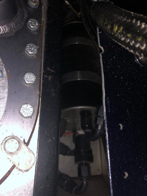

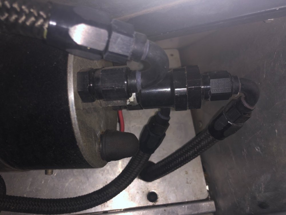

  12. A couple of more shots: Top silver cylinder is a small feeder pump that sends fuel to the surge tank. The bottom shot of the larger cylinder is tge surge tank itself, which has a large pump inside, and a check valve out side, the 2nd shot of a black cylinder is a 100 micron fuel filter that compliments the factory filter. The fuel regulator is in the engine bay. And contrary to my earlier report, I don’t have a swirl tank, the surge tank solved the fuel starvation issue. All of which is to explain why I never attempt mechanical repairs myself (and should avoid offering mechanical descriptions of my Caterham:)).

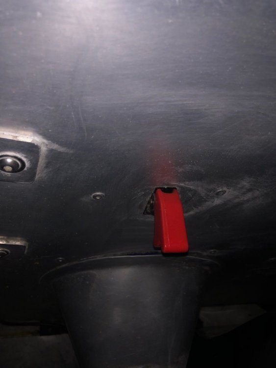

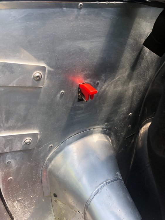

  14. Here are a couple of shots of my fuel cell setup. Not sure it helps. It is a return system. All built by my mechanic, I have no info on the details or setup. The fuelline hose that runs up along the rollover bar is the overflow line, not pressured. Tom Carlin runs these thru the hollow bar, which is much more elegant/tidy, on his Birkins. There is a catch can by the drivers’ side rear suspension. The red switch on the rear bulkhead is a separate off/on for the pump.

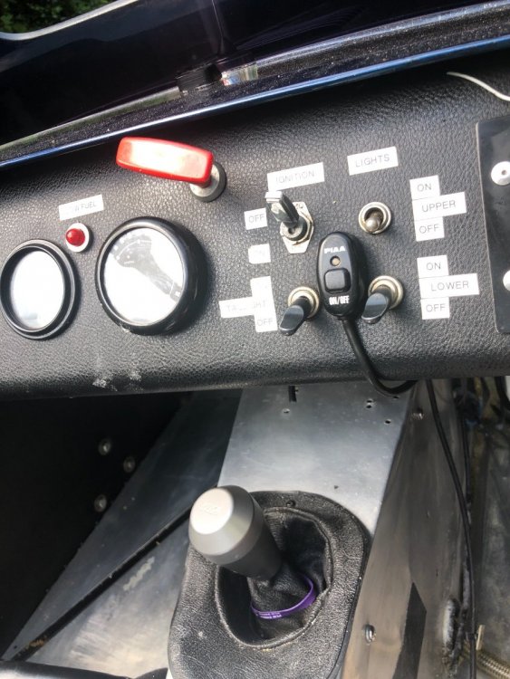

  16. The lights location has no effect on cooling. Here are some more pics of other quirks/mods that the car came with. In addition to the 21 gallon fuel tank, for endurance racing. The third photo shows 2 hooks on the passenger side of the roll cage. I use one to hold the steering wheel, the other to hold my helmet. Surprisingly helpful. The bottom photo is an off/on switch for the fuel pump. Helpful when starting a flooded engine. The 4th photo is a dash shot. I have a combo oil temp/ water temp guage. The oil temp shows the oil takes at least 5’ more to warm up, after the water temp says the engine is fully warmed. Also in that shot, at the top, is a rev guage/shift guage ( a bunch of green LEDs, then 2 reds). When the reds both light up and then flash, it’s time to shift. I totally rely on this guage on track and ignore the rev counter. The 4th picture is a custom jacking point. Very helpful in a 24 hour race, otherwise irrelevant, tho I do use it to change tires. The top picture most importantly shows the tiny low fuel guage between the 2 large circular gauges on the far left. This has save me from running out of fuel inumerable times. It starts to blink when fuel is really low. Nothing is more embarrassing than pulling off due to low fuel, and having your entire run group flagged into the paddock, while you are retrieved (I suppose…..). The red pull lever triggers the fire suppression system. So far it has not been needed. It also vaguely shows an A/F ratio guage. Helpful as a level of protection when doing chassis dyno pulls. All in the for-what-it’s worth category.
