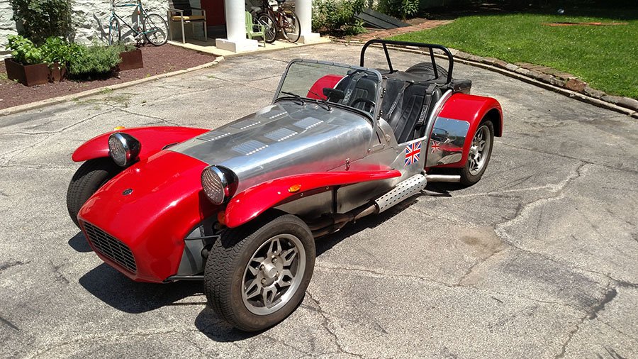

it's a phone camera effect. the height is correct.
