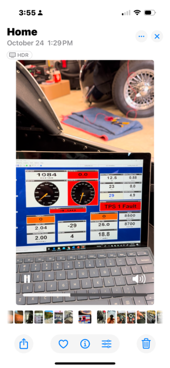

It’s really more like maintenance, but my 7 started running like crap all of a sudden. Connecting to the ECU revealed a TPS sensor fault. Once removed, it felt really “crunchy” when the internal disk was rotated with a screwdriver. It took a little sleuthing to find a proper replacement, but once I had on in hand and installed it my 7 fired right up like it used to, and showed no more TPS fault. It runs like a scalded cat again! A small victory, but I’ll gladly take it! -

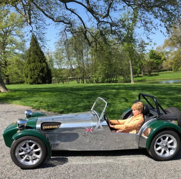

Very interesting... I had frankly never thought about heat from the radiator getting into the intake. I have a pretty large gap ahead of the filter, and I bet hot air is flowing out right into the intake. I'll have to see what I can do to improve that. Here's what mine looks like. And yes, that's Jane Pauley making racy noises
New TPS and it's running great. Thanks guys!
Hi Croc, I have an MBE 9A4E ecu.
So my Caterham started running like crap. Rough idle and won't rev above 2,000. I connected to my ECU and saw a TPS fault. I removed it, and it feels "crunchy" when I rotate it with a screwdriver. So, I need a new one, but what is it? Can anyone help me here? The engine is a 2.4L Hasselgren build with a Cosworth barrel throttle. The only markings visible on the TPS are 343 and 2038 in white paint and CBA embossed in the plastic. Any help is greatly appreciated! Best to all, John B
