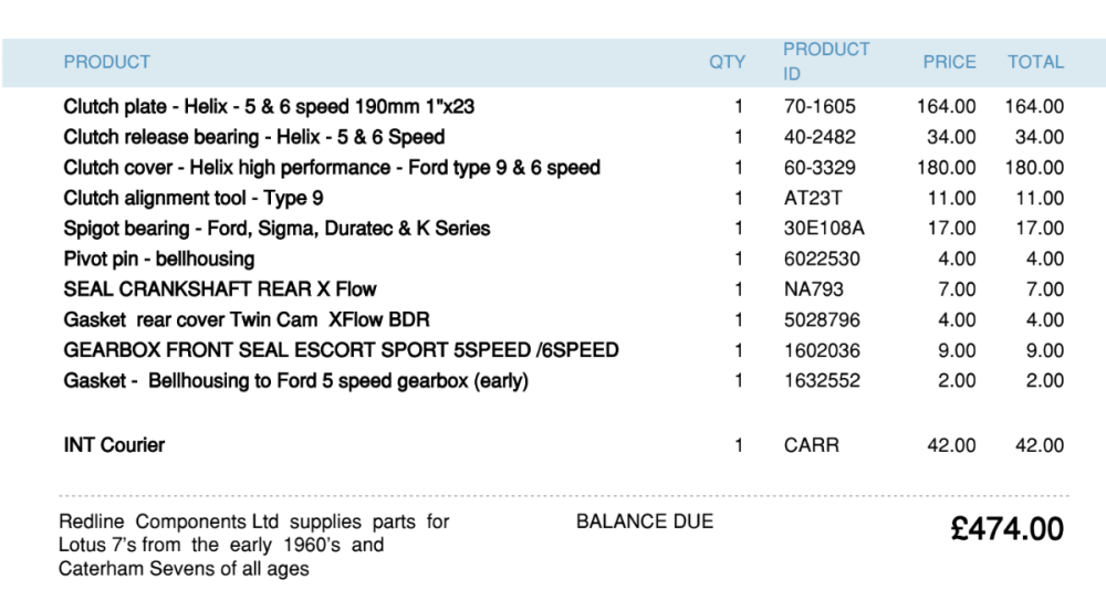

  10. If it's of any help, here is a screenshot of the Redline invoice, perhaps the part numbers can be of use (the clutch was Helix): Cheers, -David
  11. My last email exchange with Redline was in January for the purchase of a water pump. Chris was on that email thread. The clutch was purchase in August or September. -David
  12. My car is essentually the same as yours, a 1990 DeDion Caterham with the 1700 SuperSprint X-flow and T9 gearbox. In September I pulled the engine and gearbox to replace the clutch and a few other things, and after getting quite confused about what were the correct parts, I just bought everything from RedLine in the UK. I didn't specify part numbers, I just told them the spec of the car, and everything was exactly right. I bought a clutch disk, pressure pate, throw-out bearing, pilot bearing, some gearbox seals, gaskets, a clutch alignment tool, and even a clutch arm fulcrum pin. I got a few other bits and pieces from Burton, but RedLine got me what I needed. I had talked to Dave Bean, who were musing about not being able to supply 71/2" clutches, and Catertham USA didn't have parts either. So kudos to Chris (I think) at Redline. Total price was quite reasonable as well despite shipping to California. I found a local machine shop to reface the flywheel for $40, and I got replacement ARP hi-strength flywheel bolts from Pegasus racing. The engine went back in the car and it works great. I can probably find the part numbers if that would help. Hope that's helpful, -David

  19. Well, it's two years later, but I fixed my clutch problem. This Fall I pulled the engine and gearbox and replaced the clutch with parts from RedLine Components in the UK. I replaced the clutch plate, clutch cover assembly, throw-out bearing, pilot-bearing, and the clutch arm pivot pin, and also had the flywheel refaced. None of the old parts were obviously broken or worn out, but after reassembly (and repalcing a bunch of other items while it was all out), the clutch is fixed, it no longer drags when warm! That was a big relief. As mentioned earlier in the thread, all the hydraulics were replaced first, but that didn't help.
