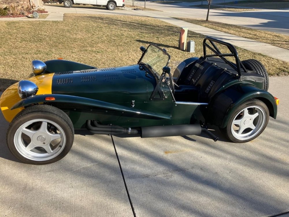

  1. This for an S3 caterham late 90's build with De dion and wishbone front end...the HPC Vaux 2L model. What is available as I'd like to raise the body a smidge. Tried a search but nada showed up. Bilsteins. I'm not sure if this is the wide footprint or not btw. Pics are for model ref. reference.
