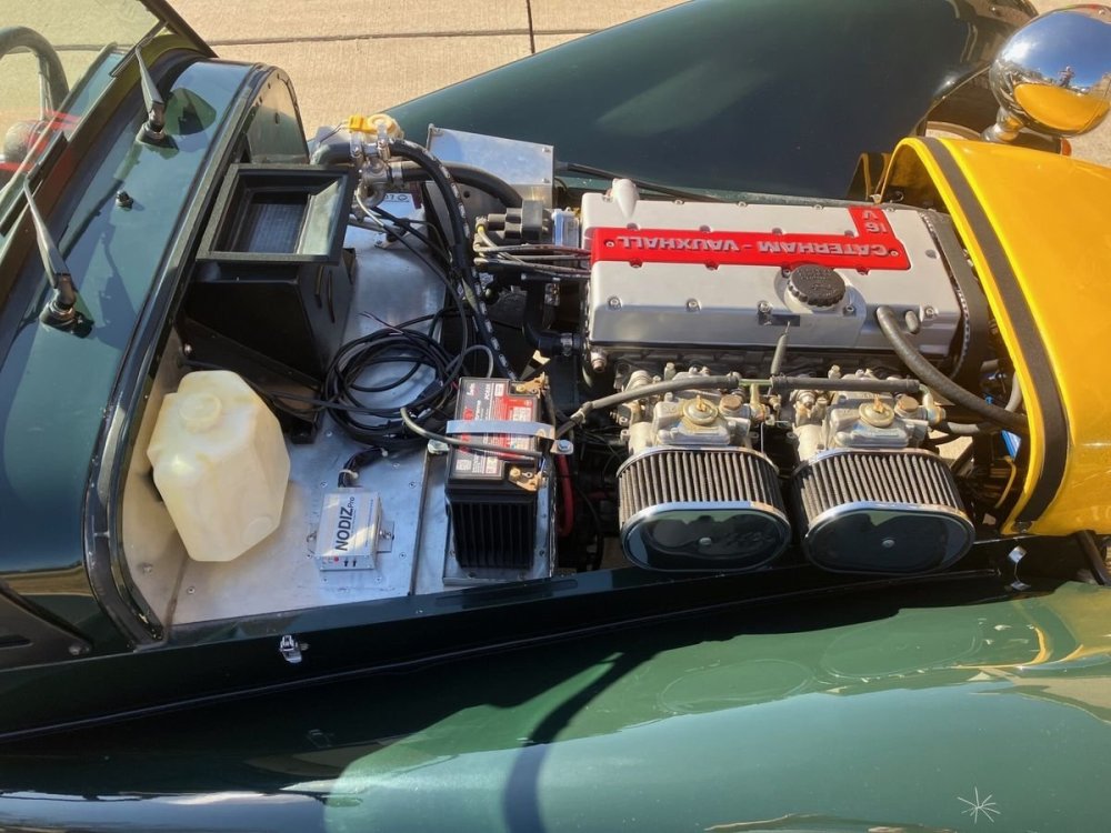

the header is on the driver/opposite side...for a good pic I'd have to remove one of the carbs. V belt. I'll remove the front and get a pic but it will not show the wiring.
