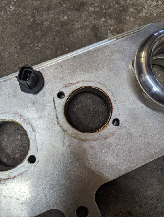

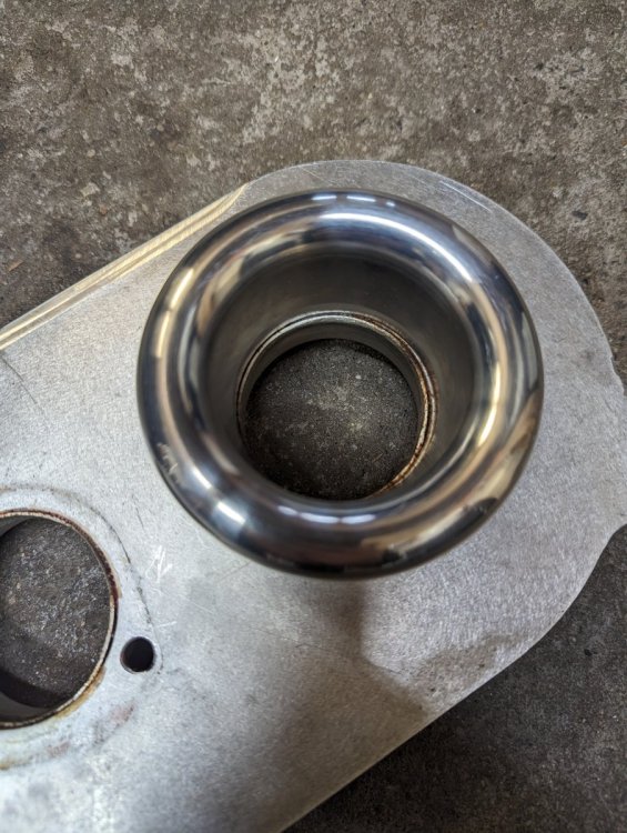

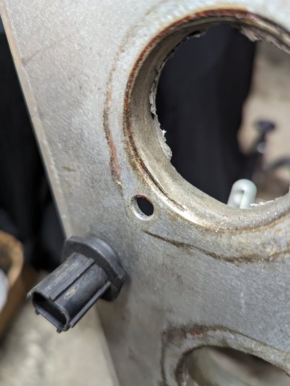

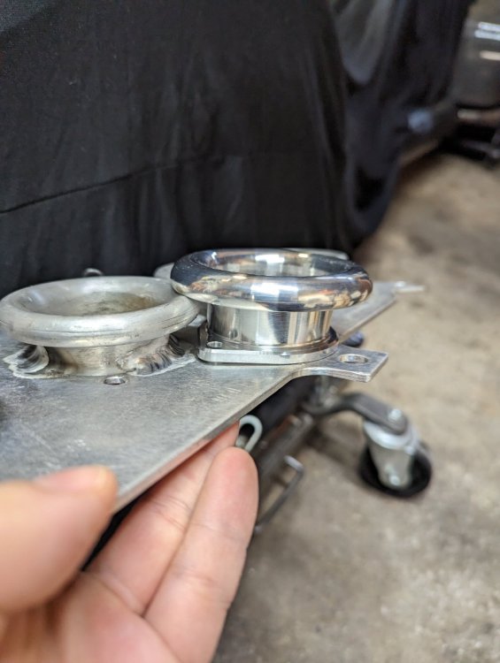

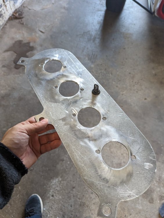

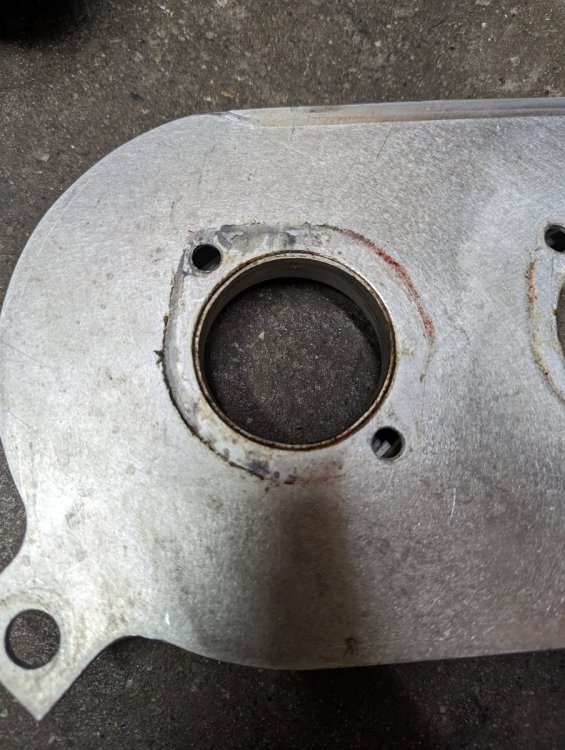

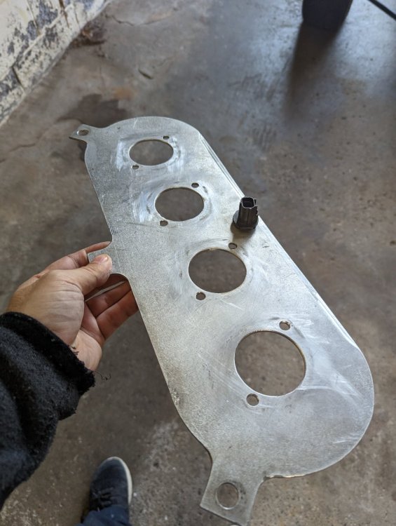

Vovchandr Posted April 29, 2023 Author Posted April 29, 2023 So my lack of power in the car and the comment by the tuner that it's chocking even though it's on ITBs made me reconsider my velocity stack arrangement. The ones on there now are slightly smaller than the runners and aren't OEM, but were rather a quick fix and were welded on. So here comes the fun
Vovchandr Posted April 29, 2023 Author Posted April 29, 2023 While this is unlikely to fix my power problems it made me feel better 1
