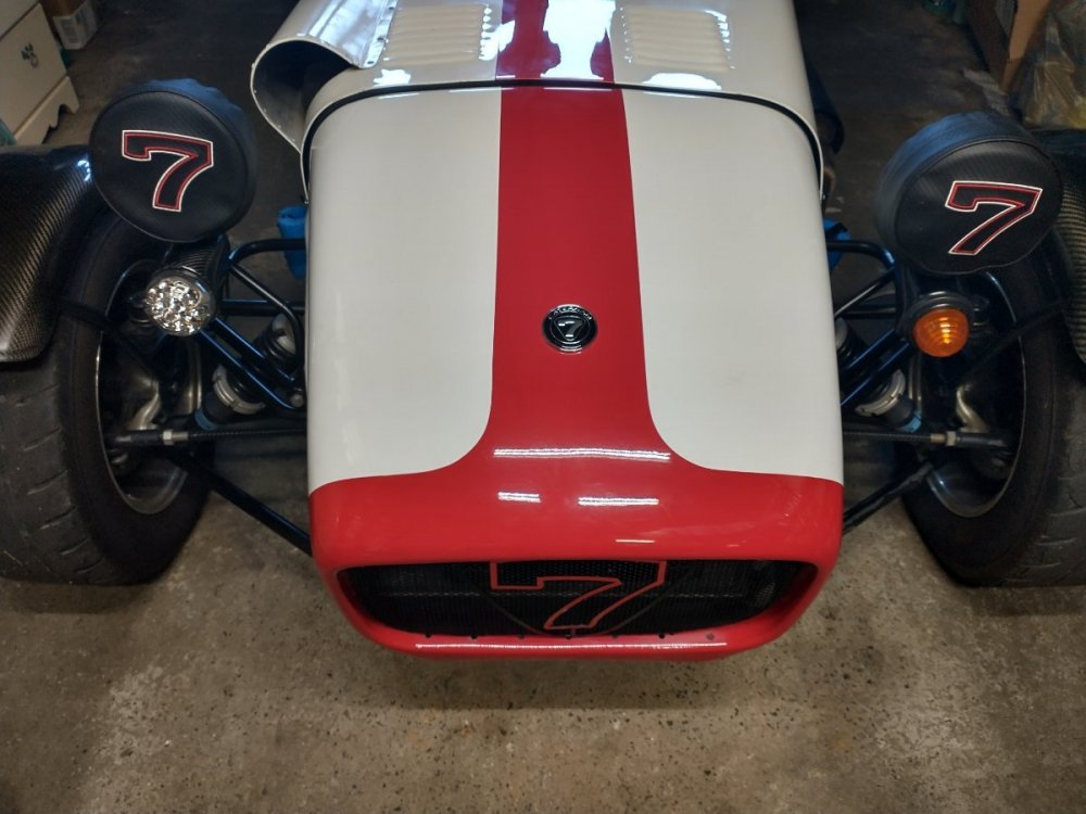

Out with the yellow, in with the red!

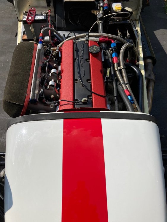

On a more serious note, finally got the car on a dyno to find out that I have a very under performing motor. After getting everything dialed in, I was at about 140 horse on my "200hp" package with the headwork, cam work, ITB's etc. About 20hp is missing somewhere. Compression is strong, everything else checks out.
Car is faster than ever on the top end but stops building power after 6k.
That means that likely up until this point car was under 100hp before tune and sorting out issues.

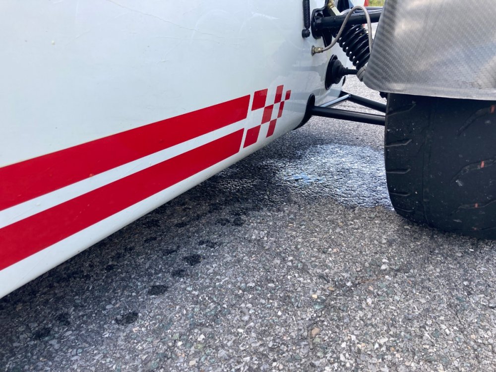

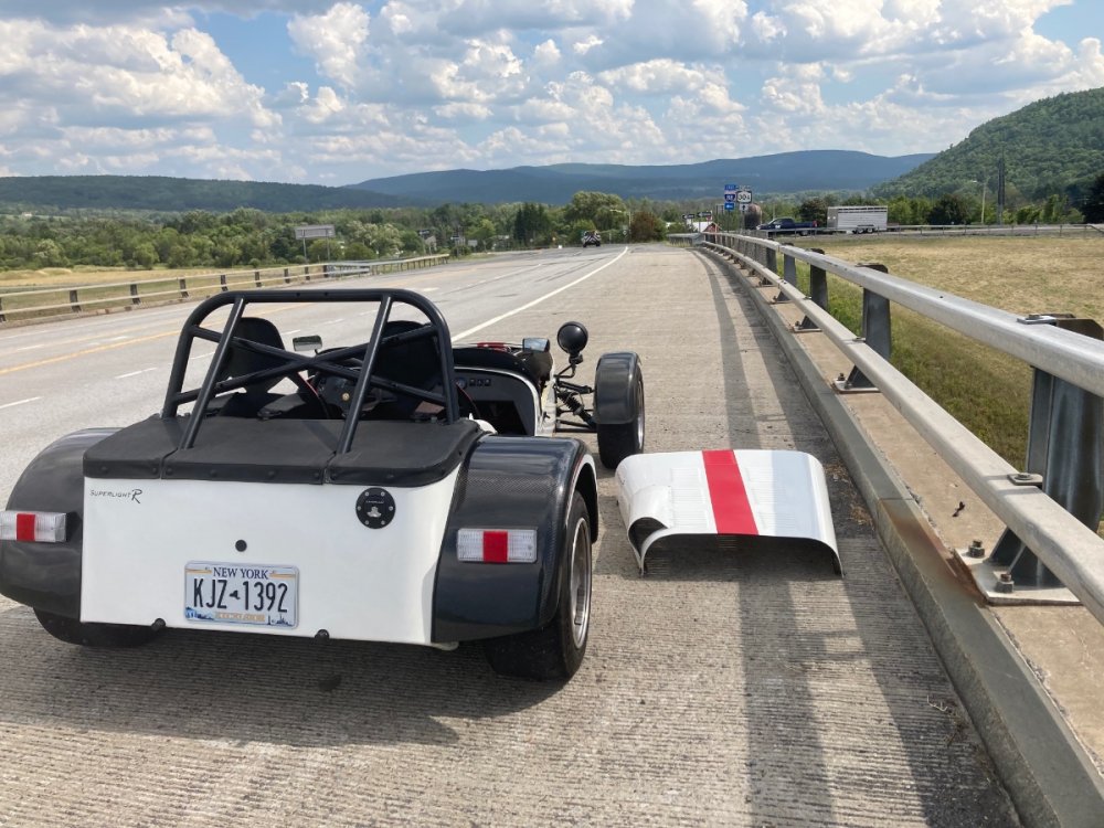

Recent road tests found me on the side of the road again. (I'm genuinely not complaining, good stories to tell and I typically have tools with me to fix misc issues)

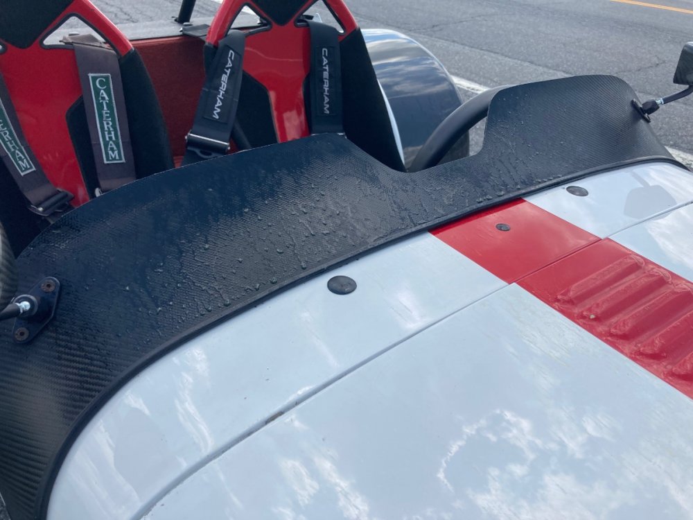

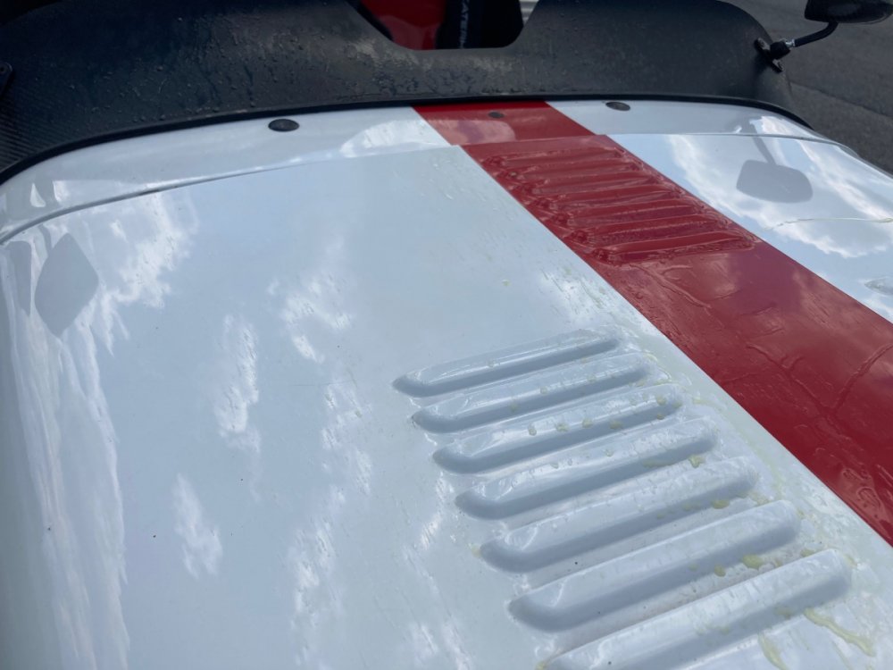

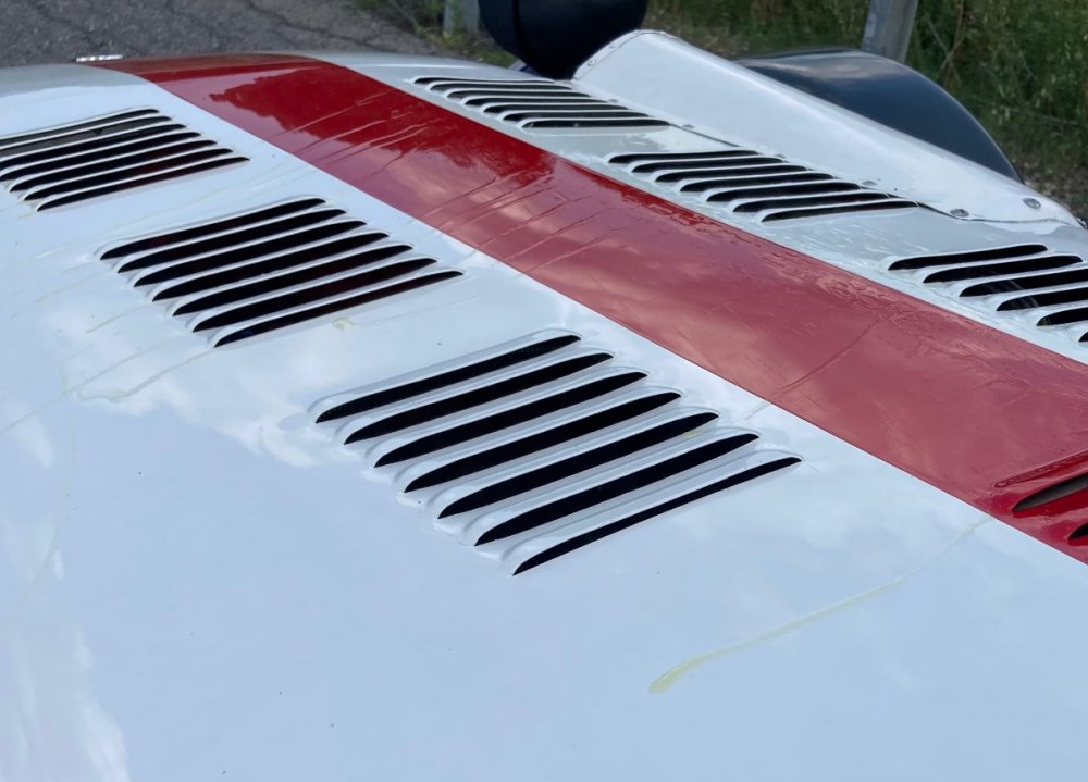

As I was driving down the highway I started to see a little bit of water forming on the bonnet vents then seconds later it turned into a new feature of a car - a new windshield washer squirter has appeared! Only problems is that it was forming on the bonnet and the fluid was coolant.

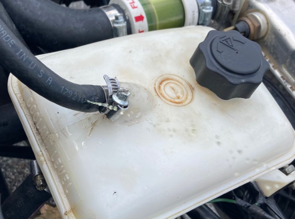

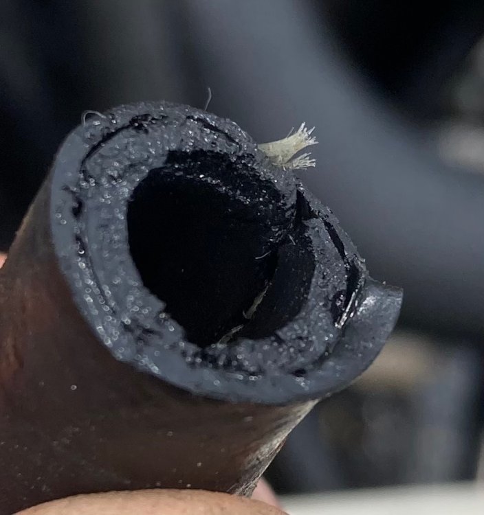

Pulled off the highway to discover a pinhole size hole formed on the coolant return line to the overflow and was shooting coolant a considerable distance.
I thought to myself - no problem shorten in to bypass the hole and go on with my day. However once I've done that it wouldn't stop seeping past the hose clamp. Investigated further and found out that even though the hose appeared to be fine on the outside, there was a propagating deterioration crack inside. This couldn't be bypassed with the length of hose that I had remaining. Luckily a 7 attracts curious minds and a very nice gentlemen that was concerned about me broken down in the heat said he had a garage near by and he'll be right back. Brought back new hose and even clamps in case I needed them
All fixed!

Coated in coolant

Visuals
Green is the most delicious right? One of the rare times I wish I had a windshield
The troublemaker caught in the act!

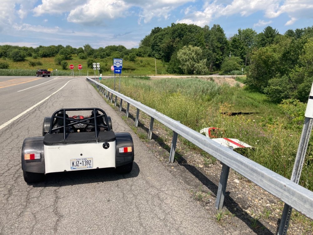

Area of refuge
You can see the crack further in the hose on the inside

I carry silicone tape in my toolkit for road trips.  You could wrap it tightly around the length of offending hose and stop enough of the leak to get yourself home.

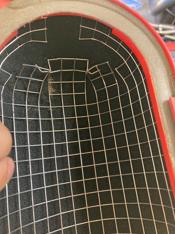

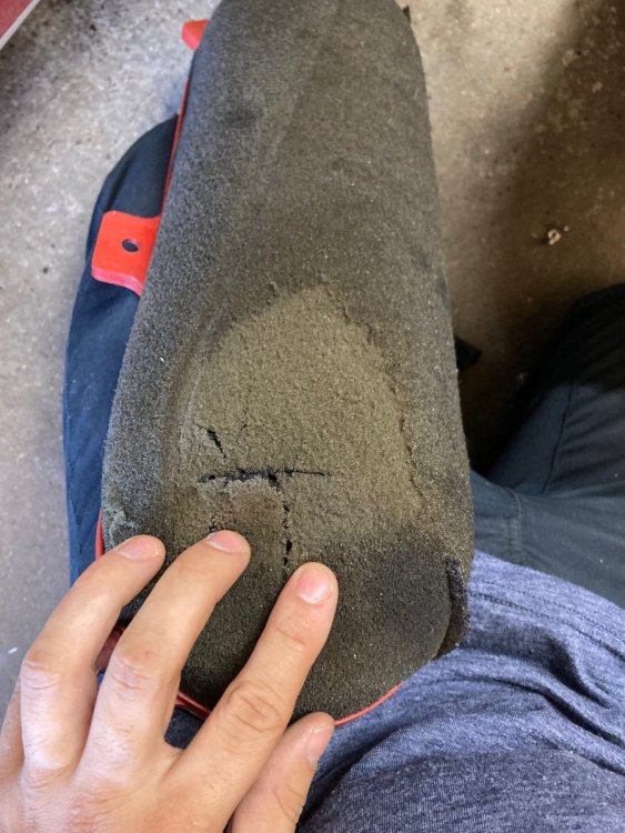

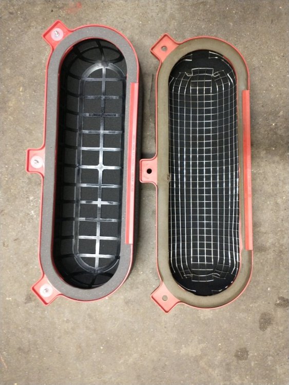

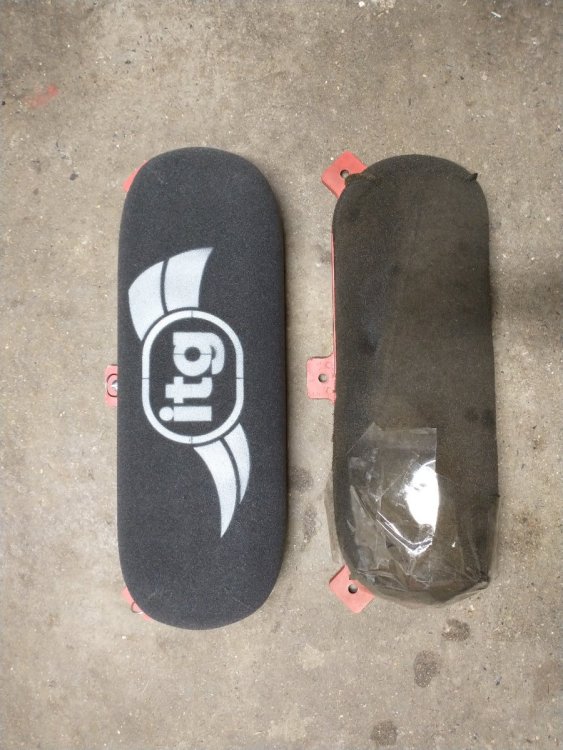

Something interesting I discovered today. Failure of the air filter on ITBs.
Caught this out of the corner of my eye as I was about to put the hood back on. No idea how long it was like this or what could have lead to specific failure other than wear and tear from the hood.
doesn’t appear that any pieces went in

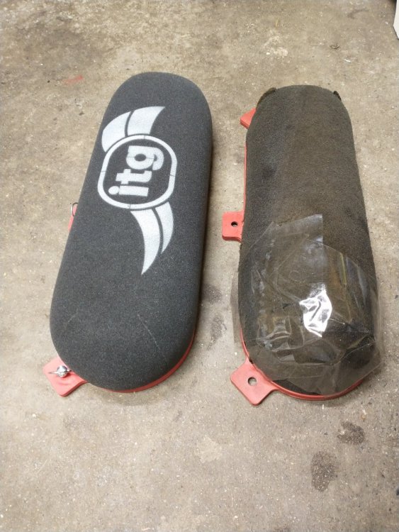

i wanted to do a test run anyway so I jimmy rigged a solution to go out for a quick test

This might not be curse but rather operator error. I'm finding out these filters are supposed to be reoiled. Maybe the lack of that lead to failure. Oh well. The more I know.
No old covid mask to strap on the front for temp fix?
 This car (and filter) has been through a lot with the PO(s). It looks like aggressive cleaning and possibly a passer-by poking his fingers in there (neighbor's child named Dennis?).
Unoiled makes the filter less effective but has no effect on foam wear. No damage from ingesting the small amount of missing foam, but you could fit screens to the trumpets if it is a concern.
Foam filters normally are fully supported inside and have a protective mesh over the top that would have prevented this failure. Piper cross is a supplier for a replacement but likely just as delicate. Borla makes a well designed carbon air box but that is all it is and would put the filter outside the bonnet.
I'd make a K&N type (unpleated if keeping sausage shape) replacement. I'm surprised nobody is making one for this.

Thank you for that info. I'll be less concerned about new filter going unoiled.
It was less than direct to find a replacement but ordered the same unit except they switched to plastic for inside structure now
