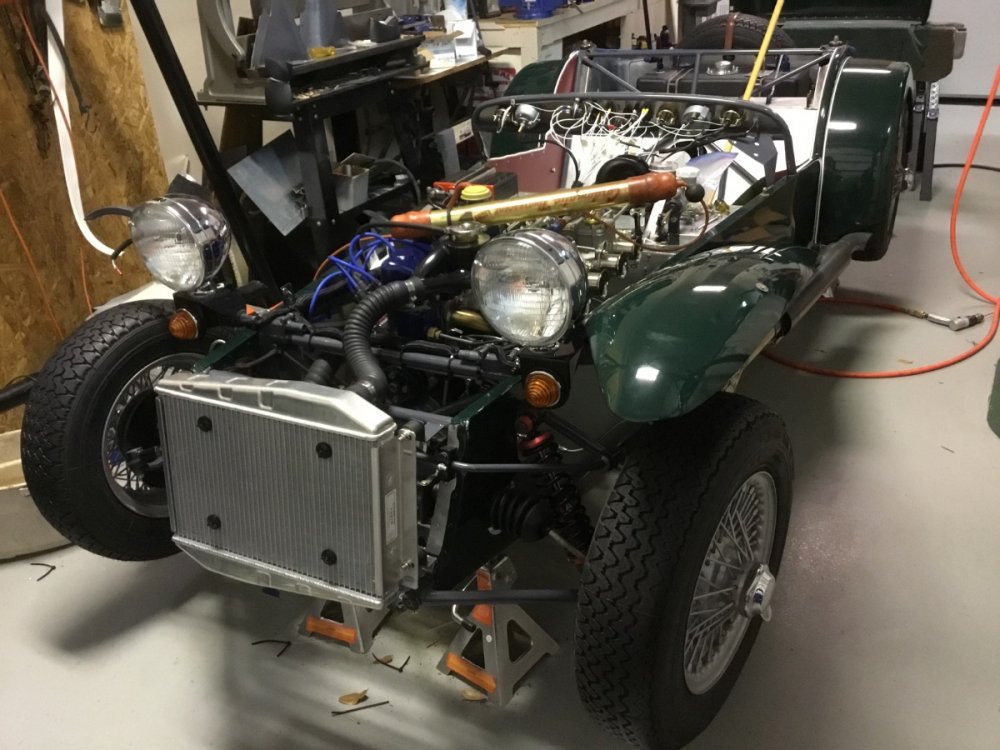

Stevensonjr Posted September 11, 2022 Posted September 11, 2022 I ordered the radiator from Caterham, specifically for a series 2 super 7, then fabricated 4 mounts to move it as far forward as the nose cowling allowed. I had to weld a 45 degree (about) angle on the bottom water hose tube to clear the frame crosspiece. Also mounted a thin 10” electric fan with shroud to pull thru the radiator, not much room but it just fits. Don’t remember where, just an Amazon fan google. Bill 1

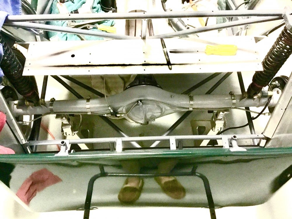

Stevensonjr Posted September 11, 2022 Posted September 11, 2022 I found a junk yard in Arizona with a TR7, 4 speed rear end. (Not the 5 speed rear end,) shipped it to Chris Beebe in Wisconsin. He cut the housing and axles down, cut off all the TR7 mounts and welded the Lotus 7 mounts in place. He had it gray powder coated and also changed the TR backing plates and studs to 7 parts so I could mount the original Lotus 7 front and rear brakes. Bill You can find Chris Beebe on the internet, I found the TR junk yard on the internet too. Bill

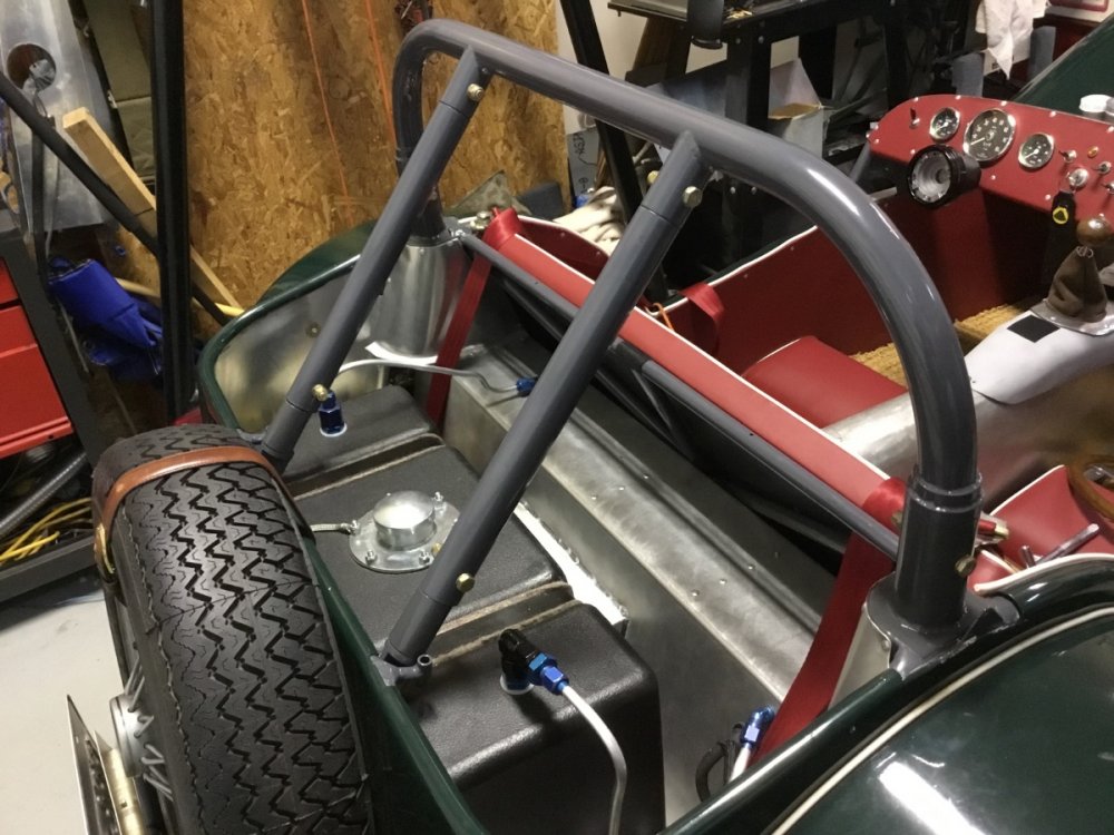

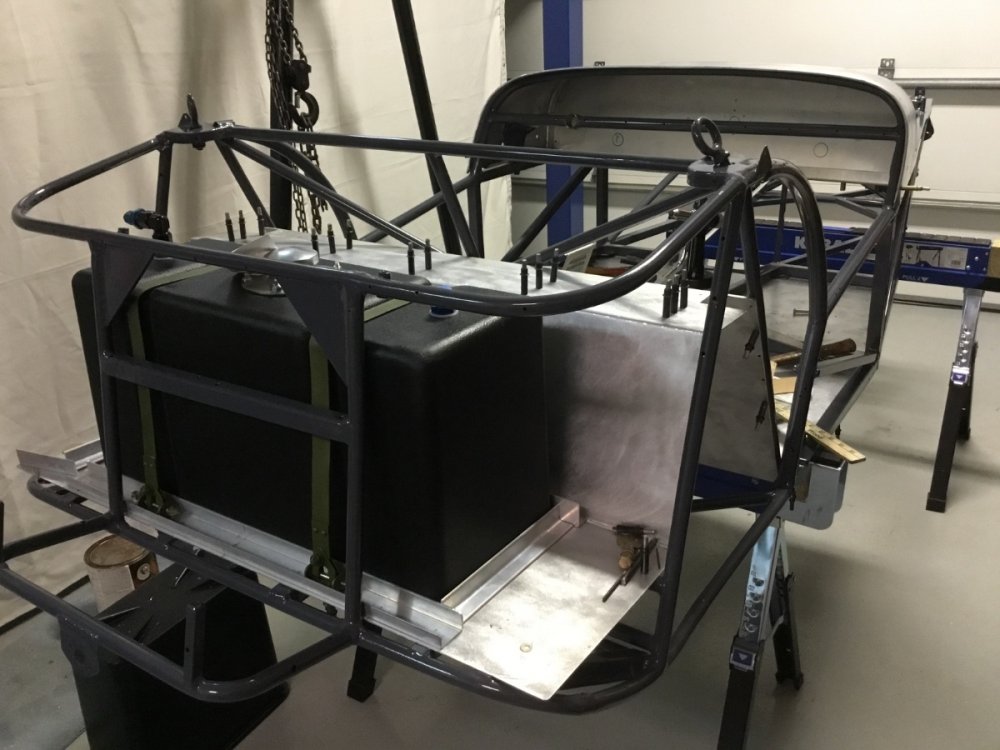

Stevensonjr Posted September 11, 2022 Posted September 11, 2022 Fuel cell is from Summet Racing, 10 gallon. Bill

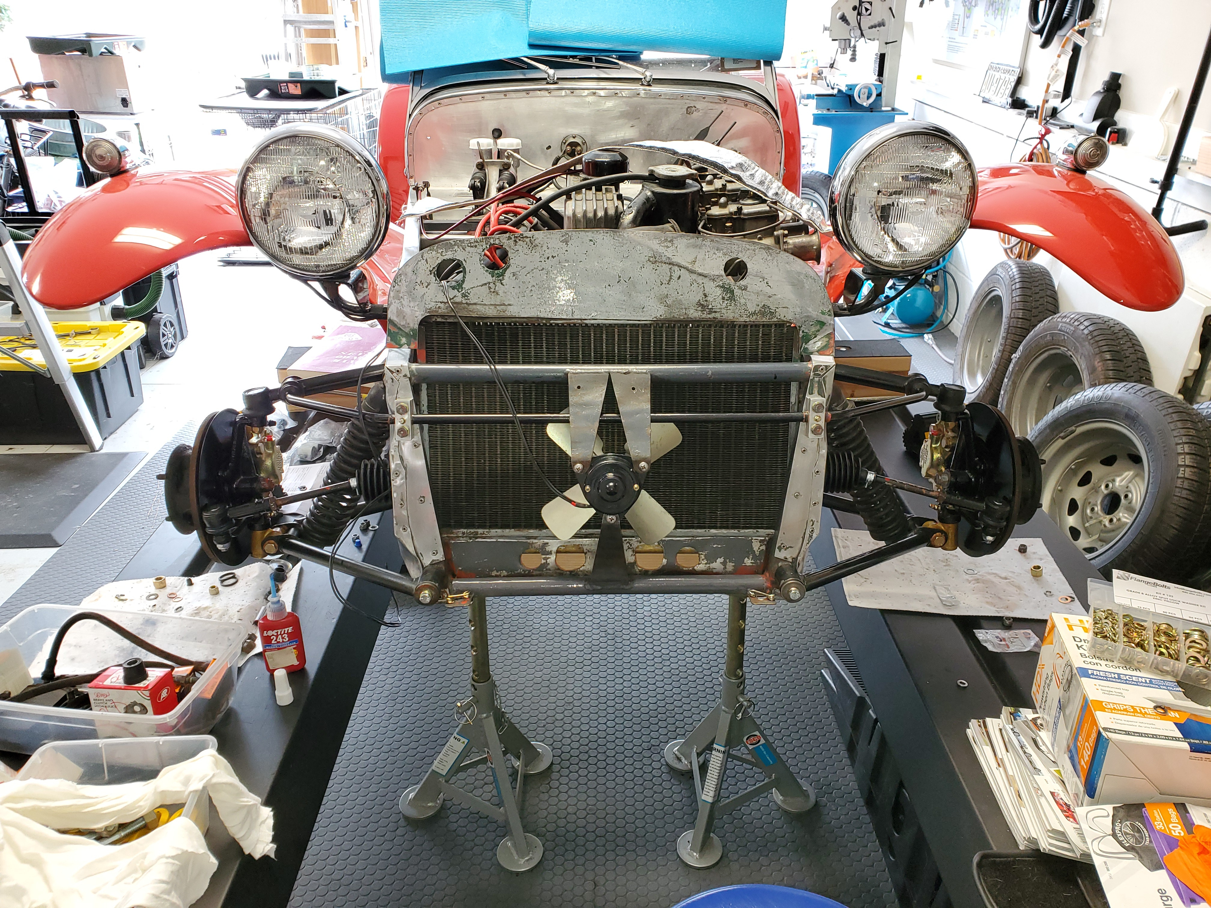

IamScotticus Posted Tuesday at 03:43 AM Posted Tuesday at 03:43 AM On 2/14/2020 at 6:06 PM, SENC said: Confirmed KAR 965C, registered in 1965 within days of ex-works date. Should finish the steering rack rebuild this weekend, thought I'd share the attached pdf as it may be useful to others, too. steering rack rebuild.pdf 464.08 kB · 54 downloads Also found a correct cooling fan and blades: Henry, did you happen to record any part numbers or OEM car source for this fan and motor?
SENC Posted Tuesday at 12:55 PM Author Posted Tuesday at 12:55 PM 9 hours ago, IamScotticus said: Henry, did you happen to record any part numbers or OEM car source for this fan and motor? The fan and motor were also used on early Lotus Elites... I'm not sure what other cars, but I'm sure they were. I understand the motor is also the same as used on Elan, Elite, and Seven heater boxes - I'll see if I see it listed in any of the Lucas parts manuals/crosswalks. I'll also see if I have any pictures of part numbers on either before installing them (or if they're visible now, grab pictures).
IamScotticus Posted yesterday at 03:42 AM Posted yesterday at 03:42 AM 14 hours ago, SENC said: The fan and motor were also used on early Lotus Elites... I'm not sure what other cars, but I'm sure they were. I understand the motor is also the same as used on Elan, Elite, and Seven heater boxes - I'll see if I see it listed in any of the Lucas parts manuals/crosswalks. I'll also see if I have any pictures of part numbers on either before installing them (or if they're visible now, grab pictures). Very appreciated. I have an S2 for this. As well as filling in a data point to feed the AI knowledge mass aggregation.
