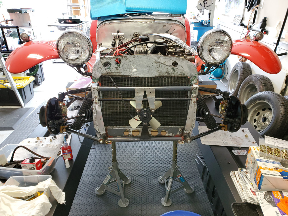

With rear brakes back together, I started dismantling the front suspension and steering.
It is in surprisingly good shape for a 55 year old car. Wishbones and ARB in excellent shape, really don't even need much cleaning and probably won't waste time putting paint on them right now. I'll clean and repaint the vertical links, caliper brackets, steering arms, and dust shields, but they are all solid. Vertical link threads show almost no wear at all!
The front brake calipers were visually ok but pistons seized. Not knowing the history, I'm taking the safe road and having them fully reconditioned and rebuilt (or more accurately exchanging them for a set already reconditioned). I debated doing it myself, but reconditioned type 12s are fairly inexpensive and it is worth it for piece of mind.
Steering unit likewise looked pretty good on initial disassembly, just tired grease and muck of age but nothing a good cleaning and fresh grease won't handle. I suspect I'll find the same when I pull out the pinion assembly and rack.
The car does look a little funny, though, with no front end!
