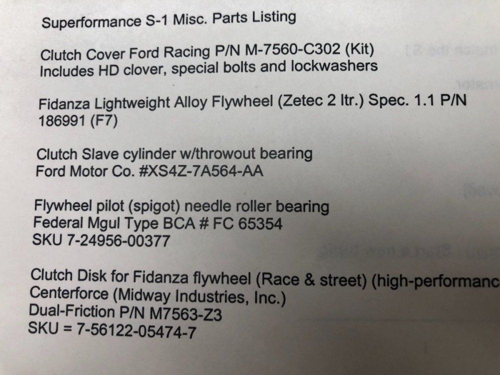

S1Steve Posted September 8, 2021 Posted September 8, 2021 Carl and Mike, I’m not sure what I exchanged with Mike, but this is what I thought may help. My S1 has the standard Zetec flywheel,( wish I installed a lightweight one), a Ford Motorsports clutch and disc. At the time I thought that would work fine with it’s almighty 139.3rear wheel HP and curb weight of little over #1400. I’ll attach information another S1 owner decided to use…. Hope to see you at NJMP.

Croc Posted September 9, 2021 Posted September 9, 2021 @S1Steve Thanks Steve - that is exactly the piece of paper I was remembering.

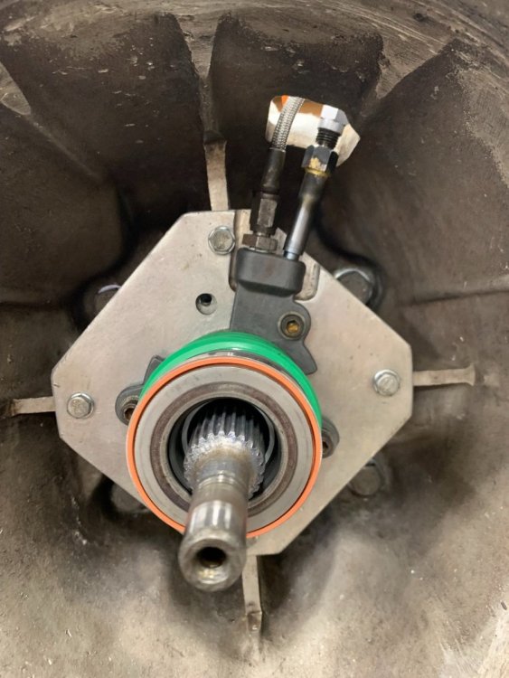

MV8 Posted May 27, 2022 Posted May 27, 2022 My two cent contribution: They probably still sell the tools to check these things but no need to get fancy. I would lay a straight edge like a ruler or carpenter level across the bell with a helper to hold it in place or a spring clamp. I would take dowel or ruler in one hand across the straight edge with the end against the hrb (hydraulic release bearing), then push the hrb to compress the spring in the green bellows as far as it will go, keeping the dowel against the hrb and my finger nail where the dowel and straight edge meet on the front of the straight edge. Mark the dowel then measure the length plus the straight edge thickness. This is the maximum pressure plate (pp) finger distance from the block to bell mating surface (may include a shim plate if you have one). This measurement should be greater than the actual finger height with a new clutch because as the clutch wears, the finger height increases. If it can't move away, the pp will eventually cause the clutch to slip. How much extra space is required depends on the pp finger ratio and the clutch design. Typical pp ratio is 3.5:1 and a clutch is typically worn out after .030" of wear, so add .120" to the max finger height to prevent slipping before it is worn out. Place a straight edge across the pp fingers and measure to the block to bell mating surface on each side to take the average distance or use spacers on the block to bring the straight edge just above the fingers and measure down to them. Fingers can be slightly bent and uneven. If it is a larger/smaller number, machine/shim the hrb adapter plate. The shim must fully support the entire base of the hrb and would be clamped by the hrb. I believe the high finger pp applications started around 2002.
parsonsj Posted May 27, 2022 Posted May 27, 2022 (edited) @MV8 Thanks very much. I've done exactly as you described, and I have a -6mm problem +/- 1mm. It's not as simple as just machining the bellhousing or the HRB adapter plate. The HRB rides on the gearbox input shaft housing, which has a shoulder, so that will need to be turned to allow the HRB to slide farther back. I've got the tools to make these sorts of modifications, but I wanted to talk with some experts in case there's a simpler solution. Edited May 27, 2022 by parsonsj
CarlB Posted May 27, 2022 Author Posted May 27, 2022 The clutch I installed last year is fine. It is the pressure plate used in 2 L applications. That is not what Caterham used. They had a smaller diameter clutch. I didn’t have to do anything to the throw out bearing. Everything worked. I do not know if the clutch master people made the fingers sit lower or not. I did not have a stock clutch to compare. The only thing I do not like is the clutch disengages at the top of the peddle. That could be fixed with a smaller master cylinder. I would get in contact with Bruce Beachman. I know he was trying to get the correct clutches from the UK.
MV8 Posted May 27, 2022 Posted May 27, 2022 1 hour ago, parsonsj said: @MV8 Thanks very much. I've done exactly as you described, and I have a -6mm problem +/- 1mm. It's not as simple as just machining the bellhousing or the HRB adapter plate. The HRB rides on the gearbox input shaft housing, which has a shoulder, so that will need to be turned to allow the HRB to slide farther back. I've got the tools to make these sorts of modifications, but I wanted to talk with some experts in case there's a simpler solution. The input shaft spline engagement and pilot may tolerate a 5mm block shim. I assume these come with a plate that fits between the block and bell that is installed before the flywheel on the block. I've not seen any domestic that did not have such a plate. I believe the thickness is typically about 3mm and affects starter pinion clearance on bell mounted starters versus block mounted. A thinner flywheel may also be an option or some combination. How is your crank end play?
parsonsj Posted May 27, 2022 Posted May 27, 2022 @MV8Crank end play should be perfect. This is a brand new Dunnell engine, with about 10 minutes run time on it. The flywheel and clutch are also Dunnell provided parts. You're right about the plate -- it was there on the old engine, but Dunnell did not provide one with the new one. In the meantime, I've gone ahead and turned the gearbox input shaft cover to allow the HRB to move back 7mm. Tomorrow, I'll set the bell up in the mill and lower the HRB adapter landings. I'll take some "perfect" measurements to make sure I cut just the right amount. I hope.
MV8 Posted May 28, 2022 Posted May 28, 2022 Hooray! Since the full travel without damage on these oem hrbs is usually only about 12.2mm, the minimum hrb extended height/length is important to ensure full release with a new clutch and a given pp. To check the actual finger position necessary for full release, tape a lot of .030-.040" washers evenly across the pp ring face and install a new clutch.
parsonsj Posted May 28, 2022 Posted May 28, 2022 (edited) OK, so the HRB height issue is fixed. I had to mill and turn 9mm to achieve the proper clutch depth. All is well now. Thanks to all for the help! Edited May 28, 2022 by parsonsj
