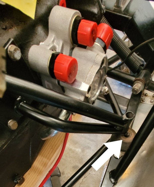

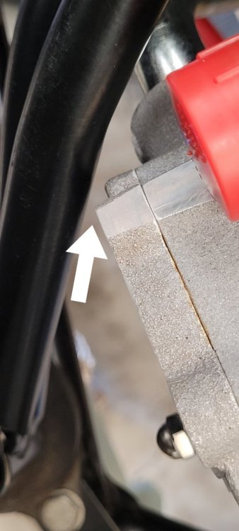

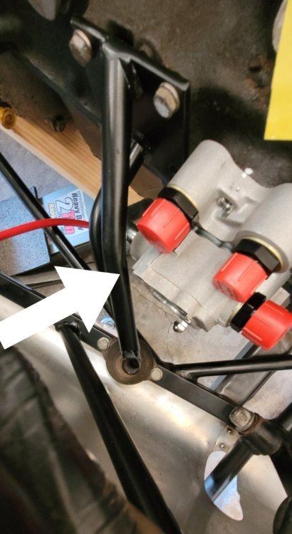

Today was windscreen, alternator, exhaust, and test fit the 5 port dry sump (DS) pump and the DS engine mount.  The edge of the pump came within 1/4" of the mount,
This will be expanded as l found the mount to be 1/4" too short necessitating a spacer between the mount and engine.
I think I will have my welder buddy attach a plate to the back of the mount and drill the holes through. Then repaint.  It's probably powdercoated.  It will be fun watching the aircraft remover let me peel that off like hot taffy.  I hate powder coat.

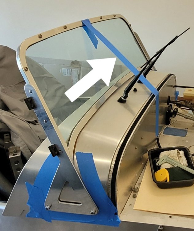

But all that stuff was easy.  The near disaster task was removing the wind screen (WS).  This is near disaster territory because if not done well with the appropriate precautions, the scuttle, AND YOU, will have new artwork to live with.  Every day like a brick on your face.
With lessons learnt from the past, here is advice for the intrepid.
Firstly, realize the WS assembly,  when tightened down, is under tension.  This is either design carelessness or English genius.  Designed to take the buffeting and stresses of the wind at speed, the tension provides the rigidity to withstand it and not shake apart.  This tension is good in its place, not good when trying to install or remove the WS as there are scuttle panel angles that will be in conflict with the stanchion angles. The WS assembly is twisted in the tightening process, providing the tension.   The screw bases in the frame sides are soft metal, I believe,  and prone to damage if tightened under tension, thread damage can occur.
When assembling the WS and stanchions,  you will notice that if you tighten the upper frame screws, (you should have attached the hinges first) the upper sides are perpendicular to the WS frame, then the lower stanchion triangles will not be parallel to the scuttle panels and the triangles will gouge the scuttle, should you try to set it on as such.  I suppose it can be done with a friend on the other side to pull the triangle back and place the rubber strip correctly.  But we are usually doing these things alone in our splendid isolation, perfectly at peace in our task, oblivious to the world.  Until one of two things break the tranquility...  the wife screeching over the dishes not being done, or the windscreen crashing down into the cockpit,  scratching up the once pristine scuttle.  Or both at the same time.  This is why you should not have any cats anywhere near while you are working.  Or wives.
Anyway, I will suggest that the assembly and disassembly are similar in that three things are necessary:

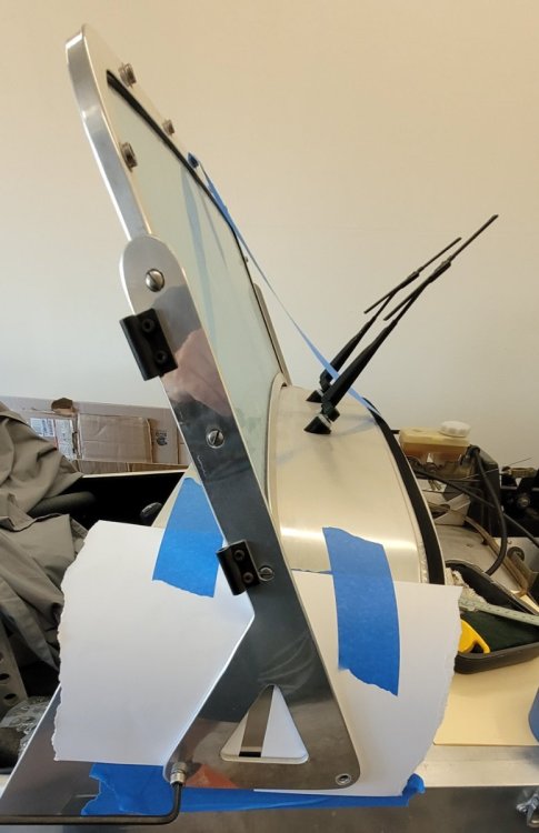

1) masking tape and paper.  Tape and paper the area to prevent scratches, especially under the stanchions,  you can remove it before you tighten it down.
2) assemble loose.  Do not tighten bolts until WS is in place.  Upper frame first, lower triangle second.
3) wood pegs. No, not your nickname in High-school.    wood rods to insert into the lower stanchion holes to keep the thing from falling over.  These are easily inserted or removed with one hand while the other hand holds the screen.  These, and tape across the top is your third hand.  You need friends that do what they are supposed to do.
Removal...
This being a hand fitted car, the WS is perhaps the worst of it.  Removing is easy.  Put tape across the top to help hold it up and loosen the lower triangle bolts first, then loosen the upper six WS frame screws (because you had relieved the tension below), insert a dowl in a lower hole or it may be stable as is. Repeat evenly on both sides until stanchions are loose.
Then place sheets of paper under the triangles so you can lift the assembly up without scratches. Hopefully.
Assembly is very similar with the added complication of the rubber trim (RT).
Problems....
Older kits used to come with Oval stanchion holes that allow for height adjustment and stanchions were bolted to the scuttle with fender washers inside.
Then Caterham made the WS brackets that sit inside the scuttle,  bolted to the frame rail.  These give the WS added strength, but they don't allow  adjustability should you find the WS not matching the curvature of the scuttle.  This happens when WSs And scuttles from different eras are mixed.
In my case, the later WS is so tight against my early scuttle,  there is no room for the rubber strip.  This was not expected last time I tried fitting the WS and I couldn't compress the WS and RT low enough to engage the stanchion bracket threads.  I removed the RT and all lined up, but the WS sits on the scuttle, no gap.
What I didn't try was any heat technique.  I have since learned that the use of a heat gun to soften the RT till pliable is the technique.  How to protect a painted scuttle when doing this?  I don't know.  I would test on a loose piece of RT to see what heat level it takes. If the hot setting of a common hair drier is sufficient,  I doubt any additional paint protection is required, but may be necessary for a wrap.  If a heat gun is used, perhaps the RT should be softened on the WS frame prior to placing on the scuttle.
Alternatively, I can space the brackets higher.  The scuttle holes will need extending.
I think the combination of both will work nicely next time I fit the screen.

I'll get a picture of my oil pump vis-a-vis the engine mount. I don't recall it being a tight fit there. The oil line that arcs over it, up and back to the filter, was a bit of trick though. The hose ends are not fixed; they have a built-in swivel joint. I added a wee bit of length to the hose to encourage it to swivel upwards enough to clear the mount. (That was the hose I ended up making twice.)
