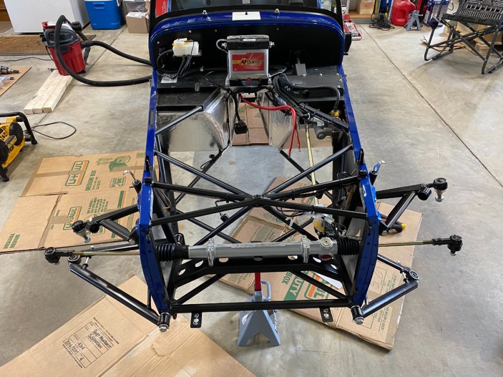

Got a lot done yesterday 9-4:30 with a lunch break- had oldest son home, youngest jumped in too.

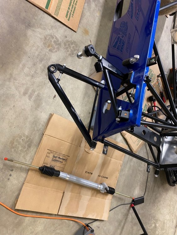

Steering rack went smoothly.
Dampers we’re tricky getting the top bolt past the body work (have to gingerly bend the body work to allow the passage of the bolt- a pucker moment, but not the worst so far, see below).
Wing stays and uprights were okay.
Horn, brake lines okay too.
The torsion bar was tricky. I put the ball ends in first, then contemplated how to bend the bar close enough to the brackets to get the bolts started? Ultimately, using a 2x4 (salvaged from crating) to press the bar to chassis wedged into the lower frame made it easy.

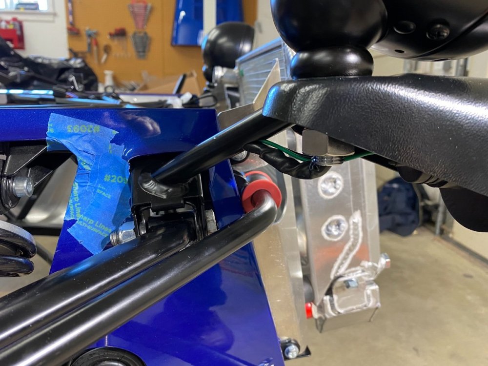

The headlight wire pull was not fun, not at all.
I sprayed some silicone grease, gave wires a light coat of grease…. Complete PITA.
I fed the marker lights wires through before the headlights.
I was able to push and pull as much as I dared until the black wrapping was just coming into the chassis. Once I got about 3/4’ of the black sheath, I used a piece of string to get a lanyard around sheath which I could pull. That was the answer. Saved what could have been hours…

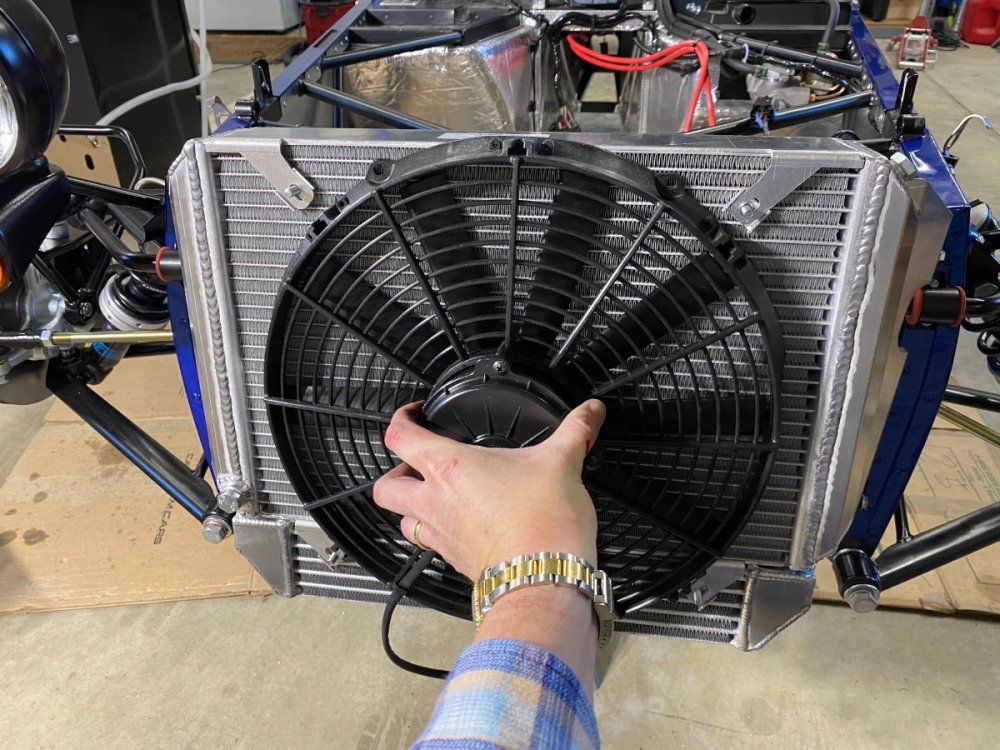

My first real impasse:
there are no directions for the 420R radiator.
I managed to find the bobbins (don’t match the visual in the directions- only 1 bolt).
getting the chassis bracket together was easy, but I have no bracket to mount fan (fan is also forward of radiator which is the opposite of the directions).
I either need a bracket which wasn’t included or I need a different way to assemble radiator / fan assembly or I need a different fan.

I'm jealous @sainthoo, I'd love to be able to do it all over again.  I would install the radiator after the engine as it is pretty easy to damage it especially when you roll the crane into position.
For the radiator brackets, see if you have what is in this picture:
@Pokey I think I might have seen those…. Will have to go rummage through some parts.
Thank you!
Edited by sainthoo
The radiator was a head scratcher for me too.  The puzzle was solved after researching the fan and finding it was a push (rather than pull) design, confirming it belongs in front.  From there it was a matter of rummaging until finding the right bits to make it work.  You will run into these situations from time to time, so best to consider it as a part of the experience and try to enjoy.

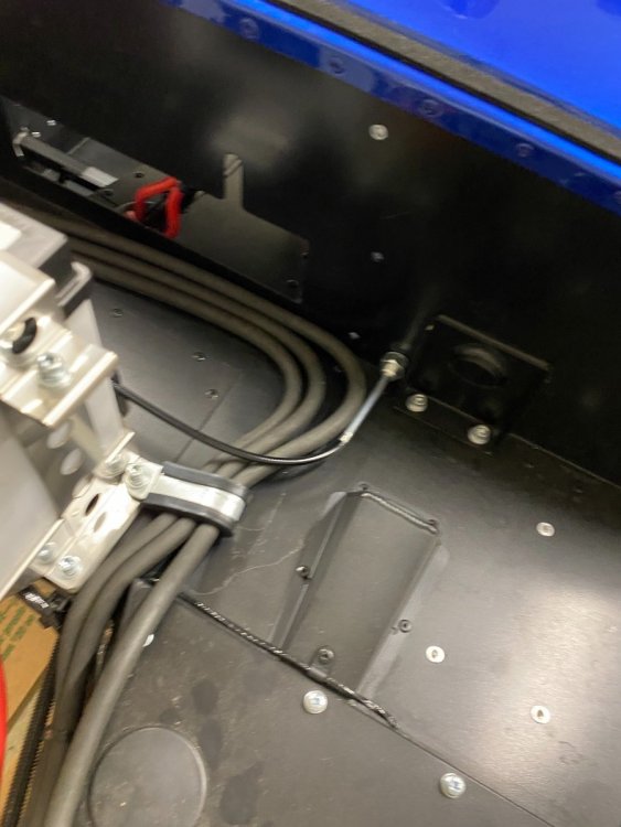

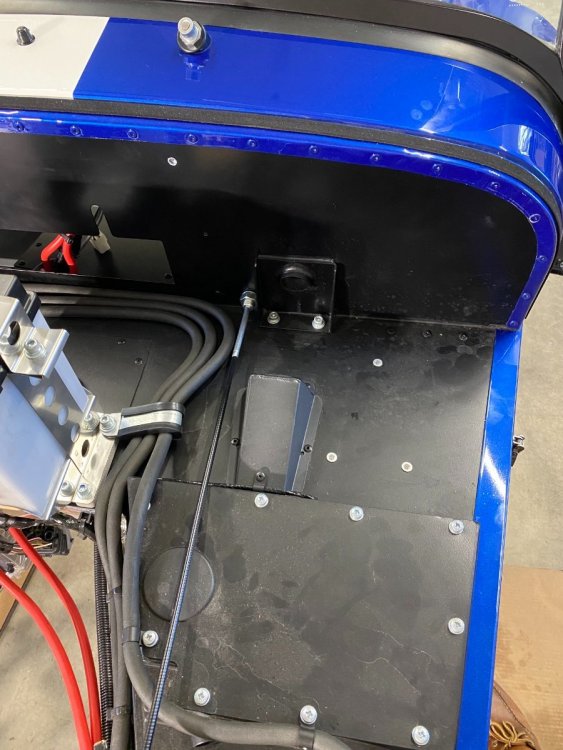

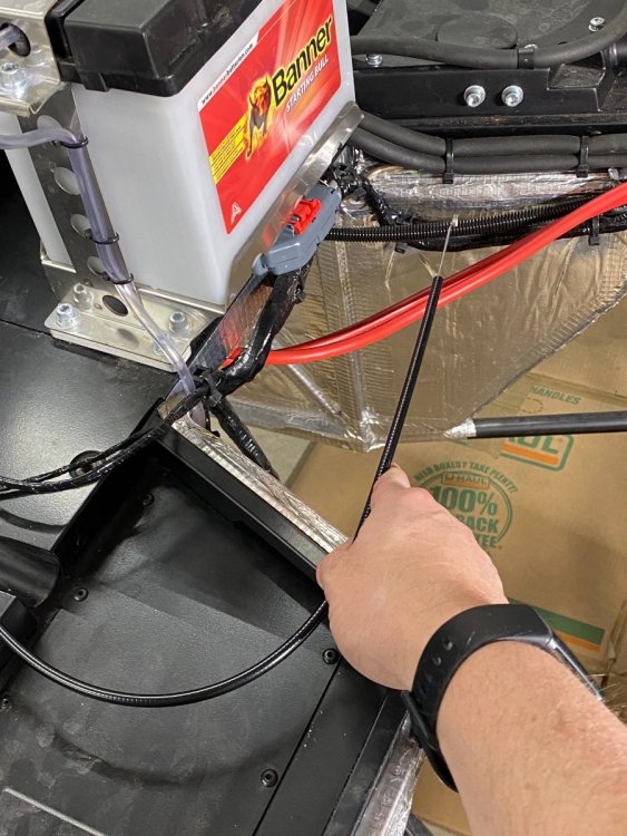

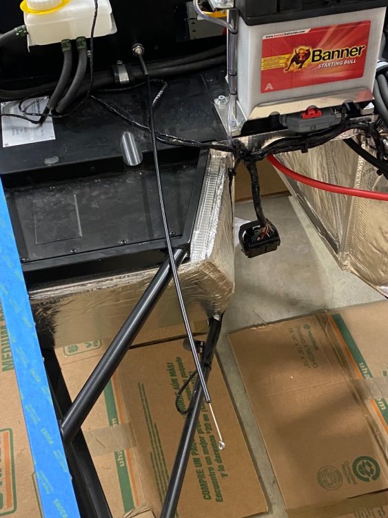

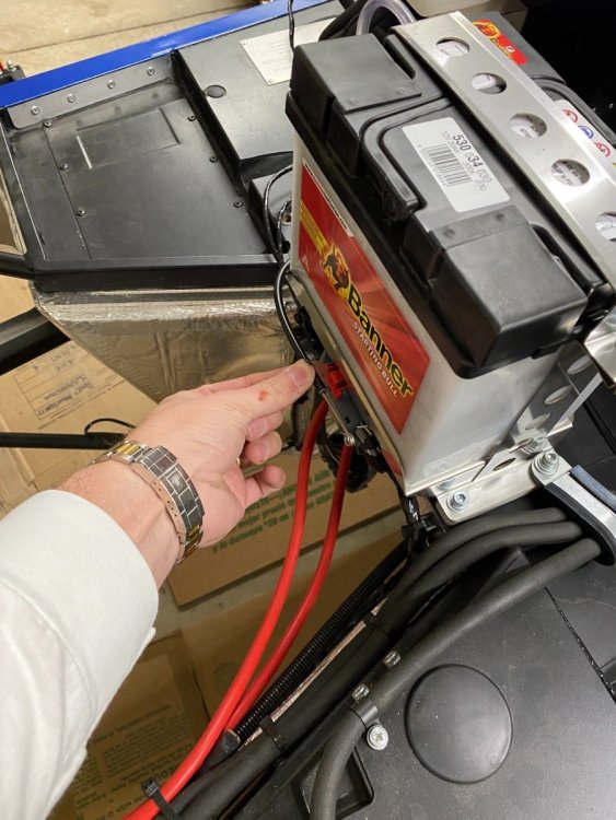

Anyone know which way to route the heater cable?
Right hand drive goes around to the right of the battery.
Left hand drive? Seems like a lot of twisting to go around battery. But, going straight and it is too long with valve having wrong orientation.
seems like a bad idea:
1D39E0C1-B983-4116-98BE-0500D7A38963.thumb.jpeg.c5c4c1a31a635b80caa80f5da196743d.jpeg13FE1692-1763-45CC-9F41-5BCF1037FE8E.thumb.jpeg.ebe7c2bc9aa37c3fd1a26bc58b67bfb4.jpeg5F88760C-5700-467F-B878-65D1C9E2315A.thumb.jpeg.1f26f481e0dc2d17ce85fb94b6a388bb.jpeg

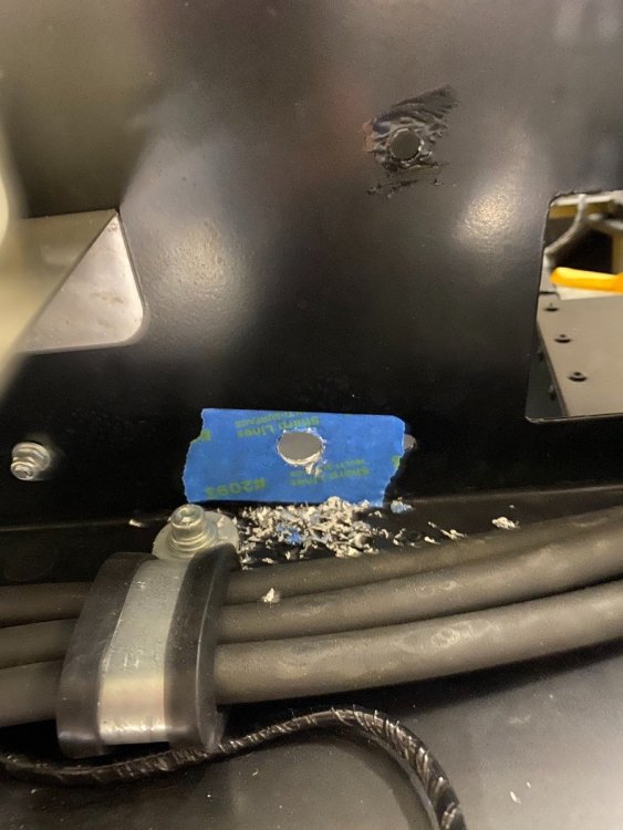

So, Josh at Rocky Mountain Caterham (foreshadowing here: think he is going to make build immensely less confusing) says you can 1) get a shorter cable (or cut the cable, I guess), then mount valve “upside down” or 2) drill a hole in the firewall on the right side to route as originally intended.
Option #2 seems most appealing. Will ponder that tonight when I get home.

Sadly, Jeremy Clarkson is my spirit animal, not James May. So, I just jumped in to drilling a new hole through the firewall in more or less the same orientation as my existing hole (just the mirror image)- no measuring, just a quick check under the dash to avoid drilling through the fuse box. I also used a foam brush to guide my height (coincidentally it was about the right height to set the bottom edge of the washer).
Before:
During:
After:5505F649-F9B4-47B6-8BE9-DC7DA4CE04B0.thumb.jpeg.62ca91b3912abe1d4938aa16a3be5234.jpeg7A6FA79A-5368-438D-9F91-295615A13C31.thumb.jpeg.095604c4deb0b224934deed9e1ff53a6.jpeg
I should also note: the predrilled holes for the heater box bolts were way too small- drilled those out too. Added a bit of Rustoleum black to all holes after filling them down a bit- again, sadly being closer to Clarkson I used my finger as the paint brush (but there is hope for me as I used a disposable glove = partial credit. Not to mention I will find something to plug the factory hole, not just leave it open).
