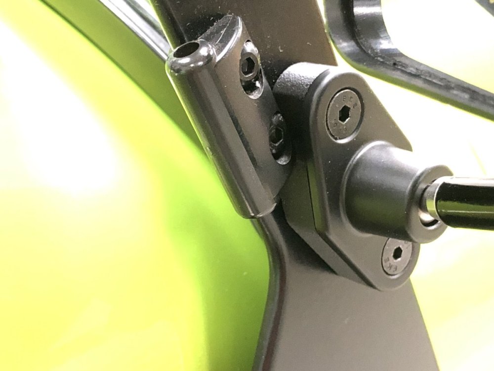

Given I'm in a holding pattern waiting on parts to arrive before I can attempt driving the car again, I decided to finish up two projects: mirror mounts and glove box.

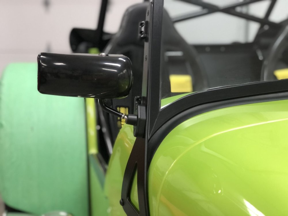

The mirrors mount fairly high on the Caterham.  Coupled with the lowered floors, the mirrors are in my line of sight when going around corners; a pet peeve of mine (PM me for the full list).  Using the lower threaded mounts rather than the ones in the middle, and printing spacers that work around the lower sidescreen hinges, results in mirrors about 3.75" lower than stock.  Still a little higher than the Westfield, but close and it's enough to move the mirror out of the way.

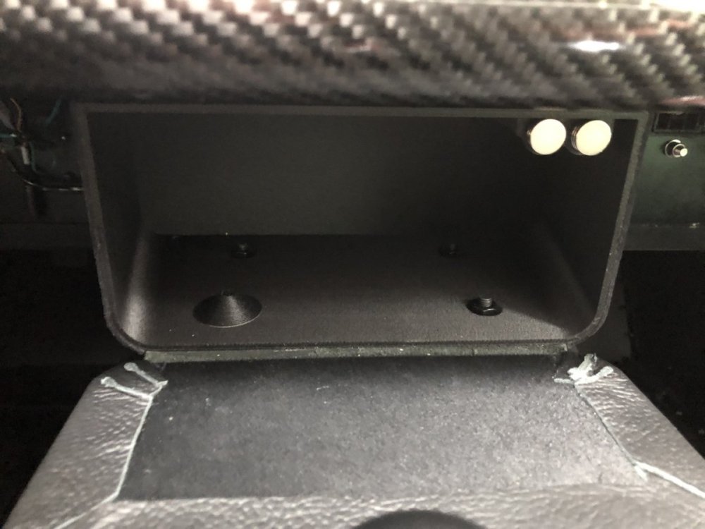

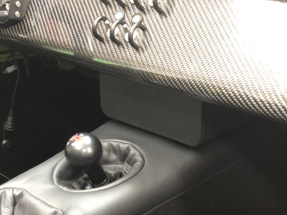

Next was the 3D printed glove box.  Thundersport, who makes the tunnel covers for Caterham, provided a matching piece of leather with my half hood order.  That covers the outside of the glove box and doubles as the hinge.  Magnets glued into the lid and into an adjustable fixture that bolts to the top of the glove box keep it closed.  I also added a mount for the 12v+ outlet and inserted a USB adapter which is easy to reach from the driver's seat yet not visible from the cabin.  Given the parasitic drain from the USB adapters, a simple on/off switch was added to avoid battery issues.
It turned out ok, but mounting was compromised.  My original plan was to use countersunk screws through the bottom of the glove box, with nuts on the underside of the tunnel top.  Unfortunately, the chassis has a steel plate in that location and clearance between it and the tunnel cover is really tight.  The fix was switching to dome head screws that go up through the bottom of the tunnel cover with the nuts inside the glovebox.  Not optimal, but good enough.  A few printed caps to cover the nuts and screw ends should protect objects from scratches.  V1 of the cap design is shown below.  I might tweak it before printing the final set of four.

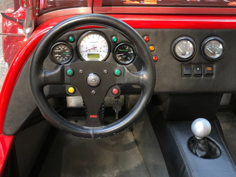

Any plans for a cluster visor? I've used textured abs sheets off ebay, molded in the oven over wood form then allowed to cool to room temp to set but you could print something (add a thicker rolled edge for appearance). Attach with small, velcro, adhesive backed buttons for easy removal.
Test with cereal box and blue painters masking tape (leaves no residue) for best angle to your line of sight and hand clearance when turning.
It's a last resort situation since it would require bringing the steering wheel closer to my body to gain sufficient finger clearance.  I'm hoping the mount that angles the display towards the driver's face will eliminate glare issues in most situations.  The Westfield has a Motogadget tach/speedo unit with an LCD display for speed and various other functions.  The angle is similar to the AiM, but It doesn't have anywhere near the brightness or contrast, yet glare is rarely an issue.  That gives me hope, but the only one way to find out is to drive it in various conditions.

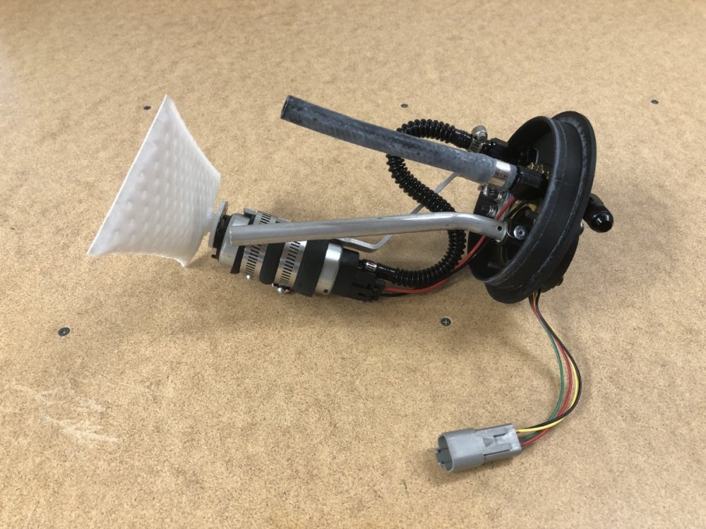

I finally received the various parts required to assemble the redesigned fuel pump module.  The big change is a new, smaller Hydramat that attaches directly to the bottom of the pump, eliminating the restrictions from the earlier design and freeing up a lot of space.  That in turn required a new pump bracket and convoluted PTFE tube on the pump outlet to accommodate the big S bend.  Unfortunately, a quick 200' drive on my property resulted in the same behavior as seen before: full lean, stalls, easily restarts, then repeats about every 200'.  Argh....

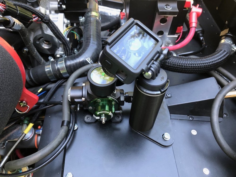

With an action camera livestreaming video of the gauge to my phone and extension cables allowing me to hold the multimeter next to it, I confirmed fuel pressure drops to zero before power is cut.  No doubt. this is not an ECU issue.

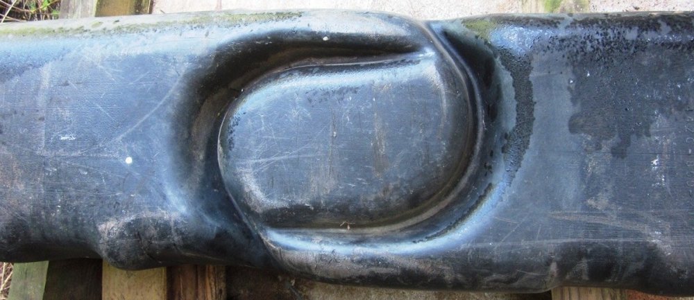

In regard to tanks with no baffles, here is a '90s ranger poly fuel tank (installs longitudinally in the chassis) replacing my '83 carbed v8 ranger steel tank as part of an upgrade. These newer tanks use a single in-tank pump where the earlier tanks have nothing to prevent slosh and used an in-tank lift pump that goes to a quart reservoir that feeds the external high pressure pump. The reservoir has four lines; one from the tank lift pump, one to the high pressure pump, one from the engine fuel rail, and one to the tank as the return. The return and lift pump keep the reservoir full. The return to the tank is the upper most line to carry off excess without increasing the pressure in the reservoir. They make similar reservoirs now with integral pumps, similar to mercedes oem.IMG_3445.thumb.JPG.57e695616bc354755c790c99f6c1f63e.JPG
