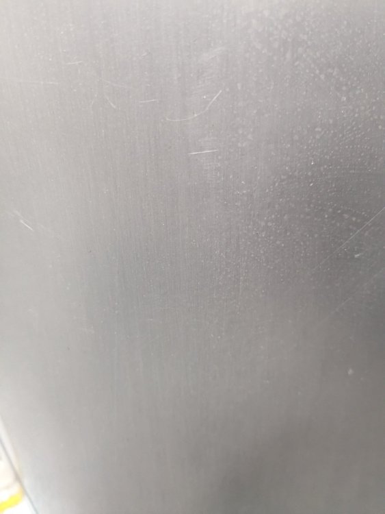

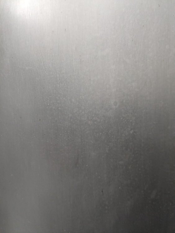

fastg Posted January 6, 2024 Posted January 6, 2024 (edited) I have taken some pics, I am not sure it shows the details, but it's tough to photograph. You can remove light scratches, heavier ones you can use something more abrasive and then use the Scotchbrite. I don't actually remember doing mine in 2023, so it's been a while, you can see a few rain spots and small scratches. You can always go to the local hardware or metal supply store and pick up a piece and experiment. Graham Edited January 6, 2024 by fastg Fix pics 1
