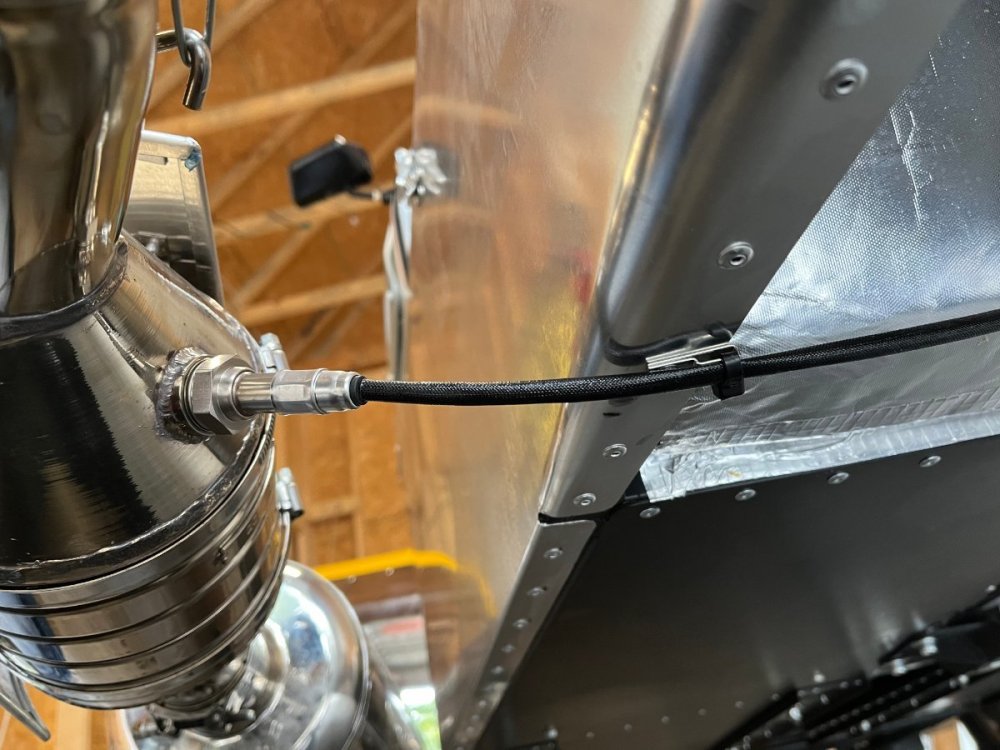

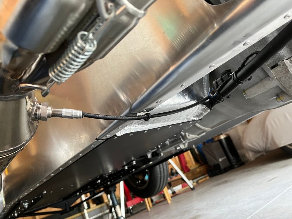

Yoram Posted September 12, 2024 Author Posted September 12, 2024 (edited) On 9/29/2023 at 9:27 AM, JohnCh said: I drilled out a lowered floor rivet, then riveted one of the spare cable tie wrap mounts in its place. Lousy photo, but it should give you an idea. -John Hello John, Resurrecting an old yet unresolved topic... I am now in a tidying up mode, and this loose Lambda sensor wire has been bugging me, even though it does not droop (yet); it hugs the bottom of the body pretty well. But my OCD side keeps nagging that this is still "wrong". So... I would like to implement your solution of drilling out one of the existing skin rivets and riveting in place a zip tie base. I'm thinking of using one of those below as they are stainless steel, sit flush and allow the rivet gun to react against their surface. https://www.digikey.com/en/products/detail/essentra-components/MTH1-1/3814005?utm_adgroup=&utm_source=google&utm_medium=cpc&utm_campaign=PMax Shopping_Product_Category_Cables and Wires&utm_term=&utm_content=&utm_id=go_cmp-20053924771_adg-_ad-__dev-c_ext-_prd-3814005_sig-EAIaIQobChMIgZXJ4de7iAMVFTYIBR1Jtx5BEAQYByABEgLyZfD_BwE&gad_source=1 My struggle is how to remove cleanly the existing body rivet. I did not attempt it on the car yet. I did some trials installing some pop rivets in a 1/8" thick aluminum profile and then trying to drill them out. Using a drill bit just a tad bigger than the hole I end up spinning the rivet in place... What is your trick to remove a pop rivet cleanly? Other folks please chime in as well. Thanks! Edited September 12, 2024 by Yoram
JohnCh Posted September 12, 2024 Posted September 12, 2024 10 minutes ago, Yoram said: My struggle is how to remove cleanly the existing body rivet. I did not attempt it on the car yet. I did some trials installing some pop rivets in a 1/8" thick aluminum profile and then trying to drill them out. Using a drill bit just a tad bigger than the hole I end up spinning the rivet in place. I use a drill bit a bit bigger than the shaft and smaller than the head and rarely run into a spinning head issue. However, in those cases, I've either wedged the head with a chisel to stop it rotating or put some duct tape over the head to hold it in place. Always start with duct tape when cosmetics are a concern. 1
pethier Posted September 12, 2024 Posted September 12, 2024 Tell me again why you don't leave the original rivet in place and put a new rivet near it.
JohnCh Posted September 12, 2024 Posted September 12, 2024 You certainly could drill a new hole. I simply preferred reusing a factory drilled hole.
Yoram Posted September 12, 2024 Author Posted September 12, 2024 1 minute ago, JohnCh said: You certainly could drill a new hole. I simply preferred reusing a factory drilled hole. I feel the same way. Thank you!
Yoram Posted September 12, 2024 Author Posted September 12, 2024 16 minutes ago, pethier said: Tell me again why you don't leave the original rivet in place and put a new rivet near it. Paraphrasing Sir Colin: No rivet shall have a free ride!

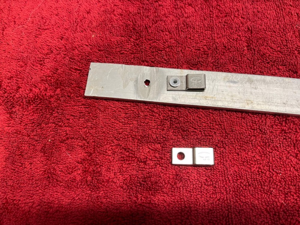

Yoram Posted September 12, 2024 Author Posted September 12, 2024 14 hours ago, JohnCh said: I use a drill bit a bit bigger than the shaft and smaller than the head and rarely run into a spinning head issue. However, in those cases, I've either wedged the head with a chisel to stop it rotating or put some duct tape over the head to hold it in place. Always start with duct tape when cosmetics are a concern. Performed a few more process development trials and established a repeatable, capable process . The secret is patience -- very light drill pressure and very low speed. The drill bit eventually picks up the head off the rivet. Then a light punch tap on the shaft and the clean hole is exposed. Only issue is the shaft and bottom part of the rivet would of course remain inside the chassis tube. This will degrade irreparably our highly refined NVH levels... That's where @pethier's approach offers an advantage. Cheers!
pethier Posted September 12, 2024 Posted September 12, 2024 3 hours ago, Yoram said: Performed a few more process development trials and established a repeatable, capable process . The secret is patience -- very light drill pressure and very low speed. The drill bit eventually picks up the head off the rivet. Then a light punch tap on the shaft and the clean hole is exposed. Only issue is the shaft and bottom part of the rivet would of course remain inside the chassis tube. This will degrade irreparably our highly refined NVH levels... That's where @pethier's approach offers an advantage. Cheers! Bingo.
Yoram Posted September 18, 2024 Author Posted September 18, 2024 (edited) Lambda sensor wire management -- Conclusion Today I drilled out the head and tap-punched the body (unfortunately into the chassis tube) of one of the bottom body skin rivets. In its place I riveted one of the stainless steel zip-tie bases from DigiKey per link a few posts up. I zip-tied the Lambda sensor wire to this base ensuring enough slack to accommodate exhaust motions/vibrations. No problems encountered and I consider the issue closed. Thanks to all who contributed to the solution. The stainless steel zip-tie base, and trial riveting onto a 1/8" thick aluminum profile: Installation on the car: Cheers! Edited September 21, 2024 by Yoram 1

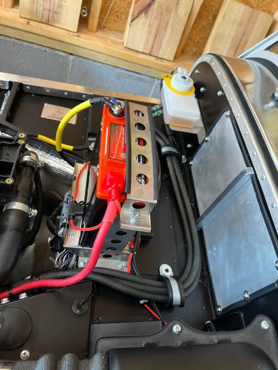

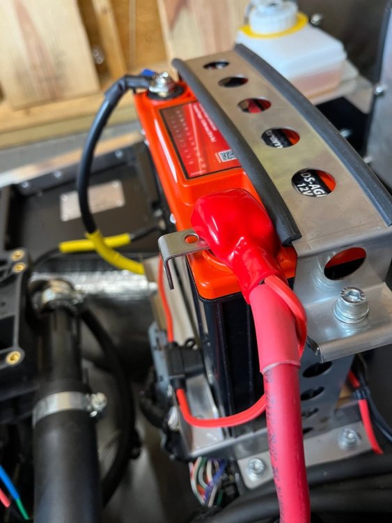

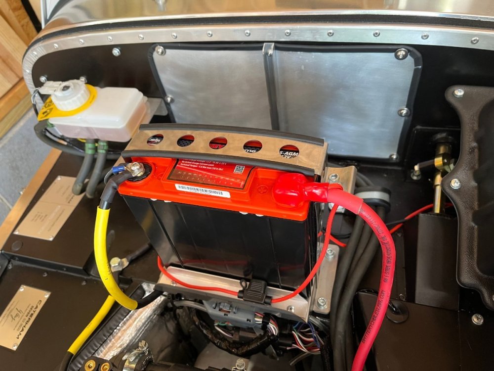

Yoram Posted October 8, 2024 Author Posted October 8, 2024 (edited) How to jump an Odyssey PC680 battery Before I get to this topic I want to first send a shout out of hope and encouragement to all those of us in the SE USA who endured Helene. I hope y'all and your loved ones are safe and well, your pets and homes intact, and your Se7ens unscathed. Here in the Greenville SC area we suffered considerable wind damage with several large trees fallen on our property, one damaging the detached garage housing Yellowjacket. Fortunately only minor structural damage and the cars are unharmed. One of the effects of Helene was that we lost power for nearly two days (fortunately shorter than many in the area). This power outage triggered the subject of this post. Walking into the garage to take stock of things for the first time after the storm I did my customary Yellowjacket electrics check by switching on the lights rocker (a habit born from the dreaded Banner days). Nothing happened. Another quick check found that when I last pushed the car into position before the storm I accidentally turned on the ignition (to prevent the steering from locking) and left it that way. Now, my Chinese trickle charger does not work during a power outage. It then occurred to me that I had never before thought about jumping the PC680 battery. Now that I did, I realized that it is impossible for regular jumper cables to clamp onto those M6 button screw heads on top. Which brought about another mini-project -- the subject of this post. The ground side was easy. There is an M8 chassis ground bolt on top of the passenger foot well. I replaced it with a longer (40mm) one and a quasi-jam nut. The nut clamps the battery and engine cable ends to the chassis. I first screwed the bolt in until it bottomed out, then backed it up a couple turns and tightened the nut. Done. The positive side is more tricky. After thinking about it for a couple of days I ended up with the current solution. It involves clamping under the positive screw of the battery, on top of the cable ends, a 1-1/2 x 1/2" L bracket with the vertical leg shortened (to reduce protrusion and flex). At present the drawback is that I have not figured out yet a handy removable insulating cover, but the bracket is not at risk of touching the bonnet or anything else. Nevertheless ideas for how to cover it are welcome (other than by electrical tape...). Cheers! Edited October 15, 2024 by Yoram
IamScotticus Posted October 8, 2024 Posted October 8, 2024 Thanks. I hope the ignition coils didn't suffer too much.
Yoram Posted October 8, 2024 Author Posted October 8, 2024 (edited) 1 hour ago, IamScotticus said: Thanks. I hope the ignition coils didn't suffer too much. I know.... Car started and ran fine afterwards. Could there be hidden damage like shorter coil life, or reduced engine performance due to reduced spark voltage? Edited October 8, 2024 by Yoram
CBuff Posted October 8, 2024 Posted October 8, 2024 I think a silicone cap would conform to the rectangular tab. https://www.stockcap.com/silicone-caps.html or you could plastic dip the upper part and have a silicone cap for the vertical end.
Yoram Posted October 9, 2024 Author Posted October 9, 2024 4 hours ago, CBuff said: I think a silicone cap would conform to the rectangular tab. https://www.stockcap.com/silicone-caps.html or you could plastic dip the upper part and have a silicone cap for the vertical end. Great find, @CBuff ! They even have rectangular section sizes. Not sure yet how/whether can order one or a few, but will look into it. Will report. Thanks!
CBuff Posted October 9, 2024 Posted October 9, 2024 Also thinking if you got some heavy duty shrink tube. If you wanted to make it removable just er on a bigger size with smaller shrink ratio and non adhesive. https://a.co/d/684EZvT They have it in red. 1
Yoram Posted October 15, 2024 Author Posted October 15, 2024 (edited) On 10/8/2024 at 5:09 PM, CBuff said: I think a silicone cap would conform to the rectangular tab. https://www.stockcap.com/silicone-caps.html or you could plastic dip the upper part and have a silicone cap for the vertical end. Talked to the StockCap sales person today after browsing through their website. She told me that they do not carry stock of any of the options I identified and that this would be a production order with a minimum quantity. Routed me to leave a voice message for another person who is supposed to know what they may have lying on the shelf, which I did. Hoping to hear back. Very impressive company for production/industrial business from what I've seen, not geared for retail walk-ins. Will report further progress. Thanks for the lead! Edited October 15, 2024 by Yoram
JohnCh Posted October 15, 2024 Posted October 15, 2024 If you want to approach the problem from a different perspective, consider buying motorcycle jumper cables. Their smaller clamps work well with the bolt heads on the battery. I carry these on tour and have jumped a Caterham with a PC680. https://www.amazon.com/gp/product/B000UKD6II/ 1
