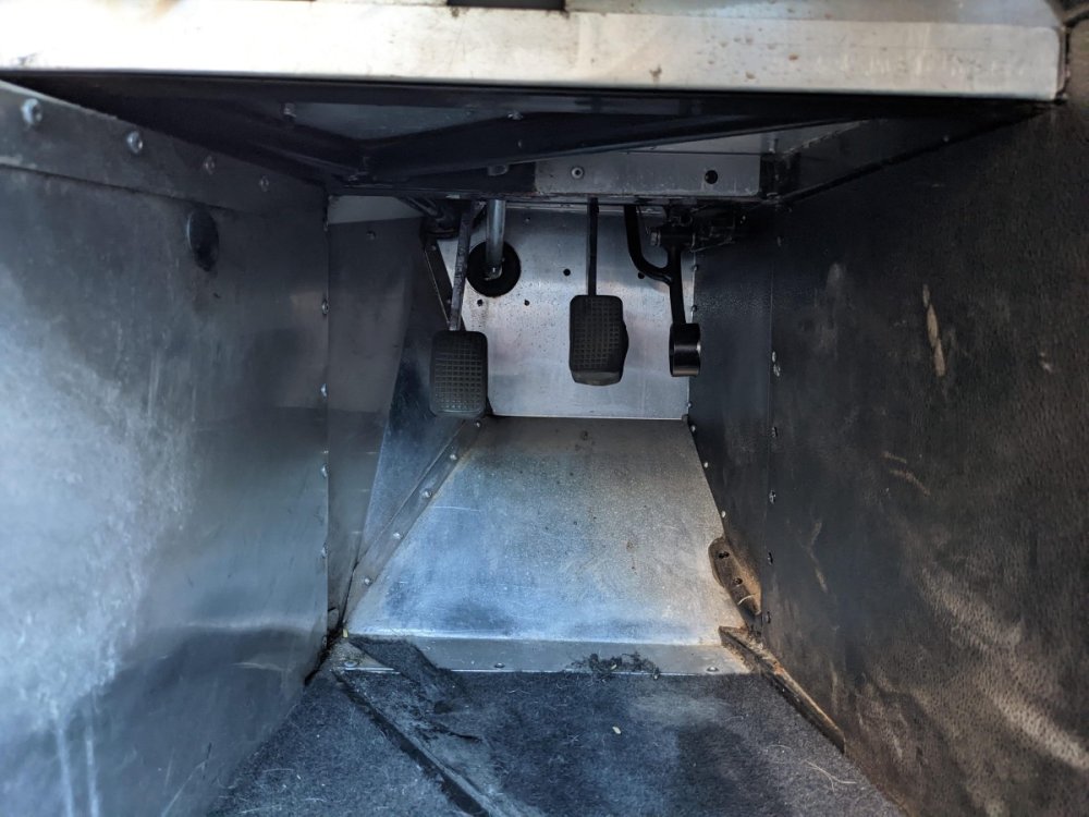

CharlesG Posted December 29, 2022 Author Posted December 29, 2022 This is my pedal box. I have no problem with the clutch pedal, but I will have to modify the brake pedal.
MV8 Posted December 30, 2022 Posted December 30, 2022 Seems like a good time to move the pads on all the pedals up to where the ball of your foot is with a shoe or sock on. Don't see any benefit to an up stop on the throttle but it could also be for that.

escondidoron Posted December 30, 2022 Posted December 30, 2022 Hi Charles and welcome aboard. I have similar footwell issues as you; I too am afflicted with size 13 feet. Here's a pic of the footwell in my car after a bit of careful rework / adaptation. I can operate it effectively with driving shoes. An important part of the revision on my '62 was moving the pedals forward to accommodate my 6'-4" height. I fabricated a spacer block for the master cylinders. By moving the master cylinders back it allowed the pedals to be positioned further forward. Also note the 3 mounting positions I welded to the chassis for the throttle pedal visible on the side of the footwell to allow me to get the position of the gas pedal oriented correctly for proper heel and toe operation once the brake pedal height was set.
