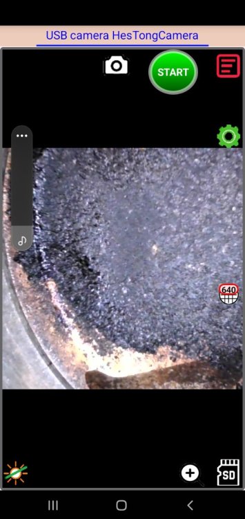

slowdude Posted May 8, 2023 Author Posted May 8, 2023 Update, replaced plugs, ran liquimoly engine flush+ new filter. Put new oil in +marvel and the engine is a bit quieter. Quieter to notice the the rear a arm bushings need to be replaced. On a side note, I'm burning oil a little bit under heavy acceleration (4k and above). Cheap $20 amazon boroscope is showing some gnarly carbon build up. Send photos to engine builder, he said pistons look good, so reccomended valve stem seals. He's sending me an emerald K6 with some tunes as well, as I am stumbling at idle with the rover MEMS, then I can run diagnostics. This weekends plan is a leak down test to confirm suspicions. Then it's just new tappets, head gasket, valve stems and getting the car to the mechanic. I'm hoping I can get the car buttoned up while I am overseas, so it's ready when I am back in August.
