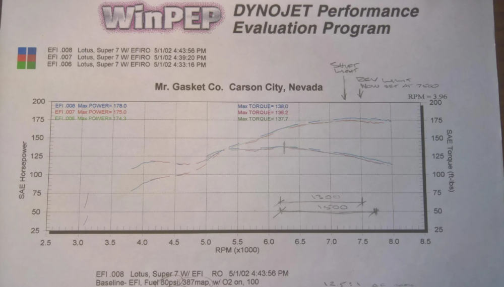

Vovchandr Posted May 29, 2023 Author Posted May 29, 2023 Here is a detailed one for the SVT blue one labeled as "Doug" (2nd down on the list) Very similar to the other one posted above Zetec SVT Engine with Jenvey throttle bodies. 176hp at wheels
MV8 Posted May 29, 2023 Posted May 29, 2023 Completely apples to oranges of course, but it is interesting to compare to a mildy tweaked slant six with a single carb. Very similar hp curve up to 5500 rpm but the torque curve is more like a table around 160 ft lbs. Much heavier engine too (high nickel blocks) though some were aluminum.
Vovchandr Posted May 30, 2023 Author Posted May 30, 2023 I plotted mine against all those others for fun...
