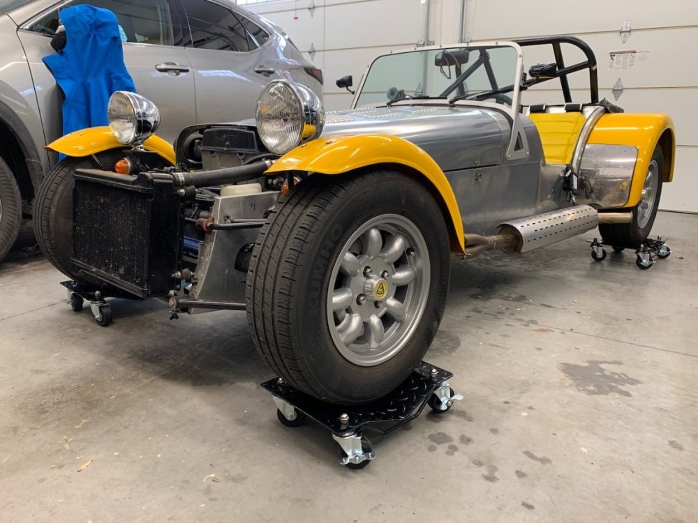

wdb Posted January 11, 2024 Author Posted January 11, 2024 (edited) On 1/11/2024 at 2:40 AM, IamScotticus said: Expand Those oil pans won't fit my engine, although the wheels do look like they'd be a handy addition! The car rolls very easily. The issue is getting it on the lift. The sloped driveway makes it so that I don't quite have the horsepower to push it up the ramps. I get it up to them and then have to winch it on. Edited January 11, 2024 by wdb

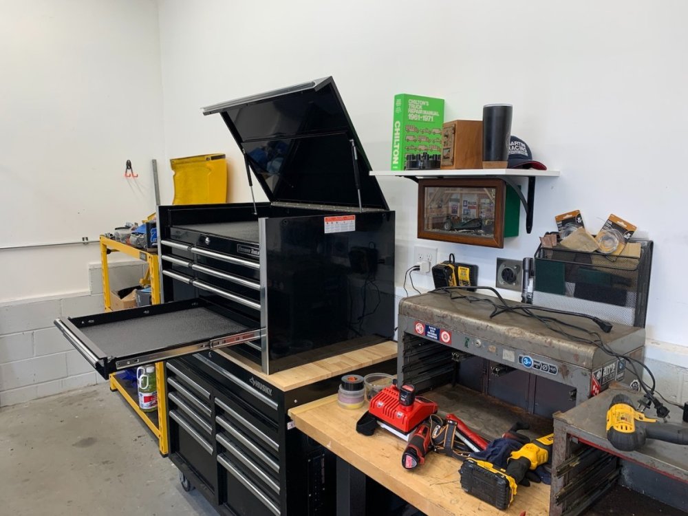

wdb Posted March 14, 2024 Author Posted March 14, 2024 I finally bought a toolbox big enough to hold my metric tools as well as my English stuff. Picked it up yesterday. I swear they packed it to go into a war zone. Shipping weight 302 lbs., toolbox weight 199 lbs. That's a lot of protection. Good thing too, because someone bashed the pallet up pretty well but failed to make it through the layers of plastic, particleboard, cardboard, and air that surrounded the thing during shipment. To my great good fortune it was at the perfect height on the bed of the Taco to slide right over onto the bottom box. Never had to try to lift the beast. The next big challenge is going to be remembering where I put everything...! 3 1
Vinman1 Posted March 14, 2024 Posted March 14, 2024 Looks like a great set up! Just in time for Spring and prepping for first Blat! 1

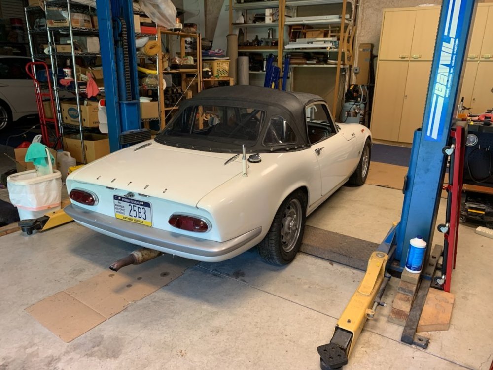

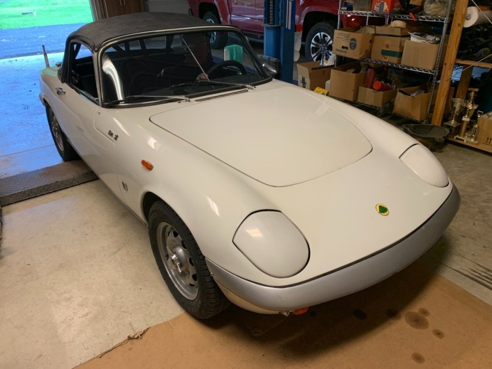

wdb Posted August 11, 2024 Author Posted August 11, 2024 It's been a little while since I've updated this thread. Elsewhere I am discussing the ongoing dry sump conversion, which I hope to have moving forward again very soon. In the meantime this happened. 1967 Lotus Elan S3 SE. It's owned by the same gentleman who previously owned my se7en. Largely original. Comes with 1.5 spare engines and two metric buttloads of other spare stuff. He has owned the car from new(!!!) which helps explain the spares. It was his family's only transportation for a while. He brought his daughters home from the hospital in this car when they were born. Raced it in local hillclimbs. It's literally a family member. Age is catching up to him however and he can no longer care for the car. I feel flattered and very honored that he and his family are entrusting it to my care. I'll do my best. 1
