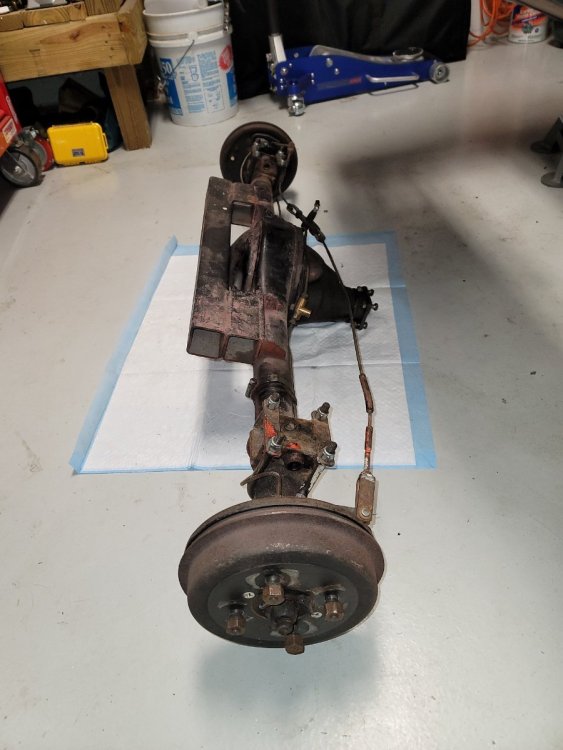

MV8 Posted January 19 Posted January 19 (edited) It would be based on the installed axle flange and wheels with the same tolerance as an alignment. Flange runout is typically less than .010". I forget the wheel run out. There is no need to fully weld a brace. 1/2 to one inch stitches every three inches is plenty for a brace. Long beads are more likely to warp. Weld a few, wait a few, wet towels to suck the heat out faster. Alternate between axle ends. Use enough heat for a fairly fast weld instead of a slow weld that has a greater heat affected area. Edited January 19 by MV8 1
ianashdown Posted January 19 Author Posted January 19 2 hours ago, anduril3019 said: If the goal is zero toe and zero camber, what's a reasonable tolerance? The Lotus S2 owners manual doesn’t quote any alignment figures for the rear suspension, probably because there is no adjustment. It’ll be whatever the manufacturing tolerances of the Axle were. I am certain that what the welding is likely to do, induce toe-out, is bad. Some induced positive camber is not preferable, and I’ve heard of some deliberately inducing a small amount of negative camber. Probably a trade of performance for potentially shorter life. Ian
ianashdown Posted January 19 Author Posted January 19 (edited) 2 hours ago, MV8 said: It would be based on the installed axle flange and wheels with the same tolerance as an alignment. Flange runout is typically less than .010". I forget the wheel run out. There is no need to fully weld a brace. 1/2 to one inch stitches every three inches is plenty for a brace. Long beads are more likely to warp. Weld a few, wait a few, wet towels to suck the heat out faster. Alternate between axle ends. Use enough heat for a fairly fast weld instead of a slow weld that has a greater heat affected area. All good advice, thank you. If I have to do this myself, which is looking increasingly likely, then I will build some kind of fixture. I hoped to avoid this. I’m going to follow the advice of Chris Beebe and use rectangular tubing rather than the 1/4”, or whatever, steel plate. Too agricultural for my preference. So there will be a minimum of welding and therefore less shrinkage. All my fabrication experience has taught me that welds always have shrinkage and it’s better to build compensating for that rather than trying to correct afterwards. Straightening is doable, stretching not so much! Shrinkage in this case will induce toe-out what is never good in my experience. I’ll have to think about how much toe-in to build in to the fixture unless anyone who has done this can relate past experience. All part of the journey! Ian Edited January 19 by ianashdown

SENC Posted January 20 Posted January 20 Here's how mine was done (likely when it lived in Australia), in the event it helps...
pethier Posted January 21 Posted January 21 16 hours ago, SENC said: Here's how mine was done (likely when it lived in Australia), in the event it helps... I don't think that would clear the fuel tank on my 1979 car. All in all, I'm happy to have the deDion setup on my 1991.
