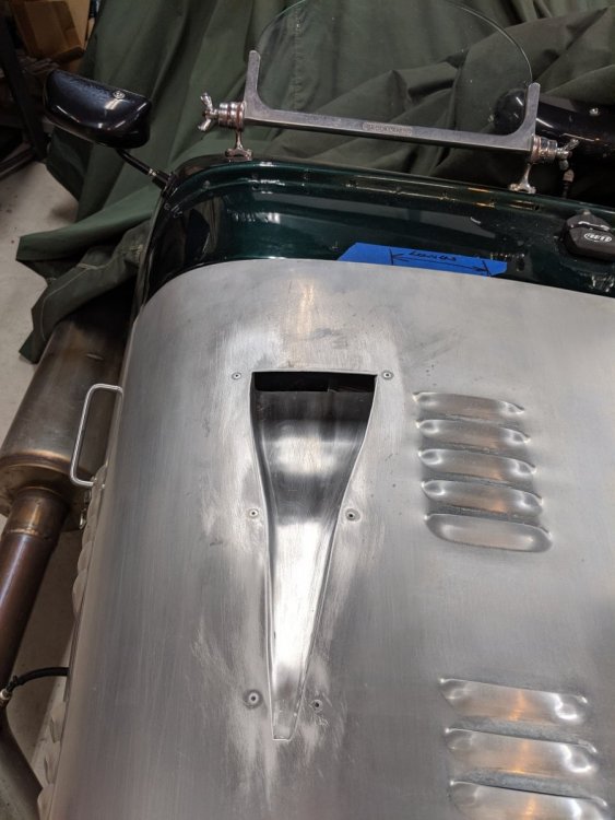

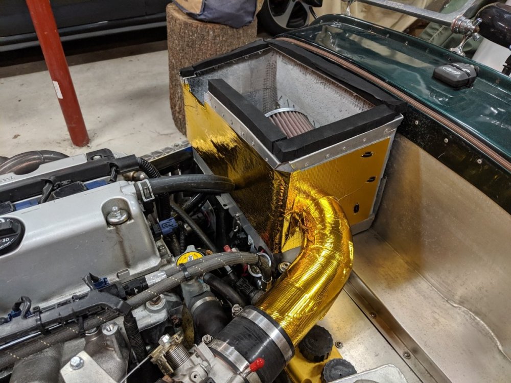

Added Skunk2 intake manifold and a NACA duct to feed it some cool air:
Nice work, very similar to my setup, check you driving IAT. Mine is normally just a couple of degrees above ambient. If it still high build a airbox around the filter, There is a LOT of heat in a 7 engine bay.
Graham
