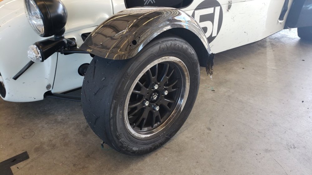

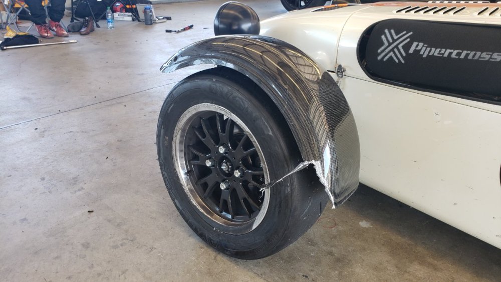

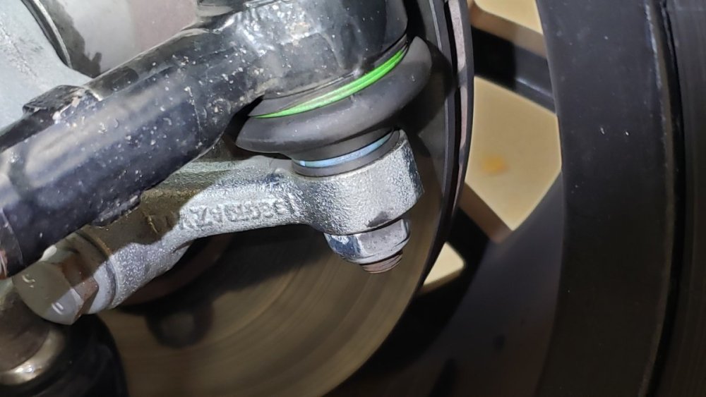

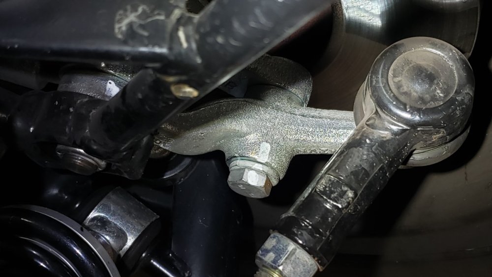

KnifeySpoony Posted September 26, 2023 Posted September 26, 2023 (edited) I was involved in an incident at Sonoma yesterday, sustained some light damage to my left front wheel/wing. Video of incident and pics below. After the incident while driving back to the paddock, the steering wheel was turned slightly to the left (maybe 10 degrees?) to travel in a straight line. Looking at the front suspension after the incident, there was no play in the wheel/hub. Everything seemed tight. I don't see anything obviously bent. Steering arms looks straight, but there is a slightly shiny area on the front left arm (tried to photograph it). I don't know if this is just an irregular area in the casting, or if it is evidence of bent/stretched metal there. You can see from the video that the right front was hit as well, but only on the inside of the tire sidewall. Before driving home from the track, I adjusted the toe on the left front (just by feel, testing by driving up/down the paddock) until the car tracked straight. I had to turn the tie rod about 1.5 turns (pushing the steering arm outward (pushing the toe out on the left front, which I figured was necessary given the prior steering wheel position). Today I checked the toe with the steering wheel straight and there is 1/2" (12mm) of toe out. Previously the car was set for zero toe. So I'm not sure what exactly was bent, or what I should replace. Should I just realign it and run as is? Or do I need to replace the steering arm(s)? Anything else that could've been damaged? The steering seems smooth but could the rack be damaged? There was a slight shimmy in the wheel at freeway speeds on the way home, speed dependent, felt like a tire slightly out of balance. The wheel itself is scuffed but looks straight though might not be. Or it could just be tires flat spotted. Thanks! Edited September 26, 2023 by KnifeySpoony

7Westfield Posted September 26, 2023 Posted September 26, 2023 I've seen those Spitfire steering arms bend under impact. Pop the tie rod ends off and measure to something, like the brake rotor or tire
MV8 Posted September 26, 2023 Posted September 26, 2023 Ditto on a slightly shifted on the mounts yet undamaged rack. I don't think the toe link is bent but it could be slightly. I think one of the control arms are slightly bent and/or bushing damage, with the wheelbase slightly shorter on the left side. Looseness can be difficult to determine with the suspension loaded.
Christopher smith Posted September 26, 2023 Posted September 26, 2023 Unfortunate incident. Perhaps some of the parts now deserve crack inspection with at least penetrant dye kit? Lucky that many 7 parts are from cars with almost 2x the weight so usually pretty sturdy. But still might be good to check as the parts were not designed for big impact loads. Having a front spindle snap on a street driven MGTC at 5 mph sold me on crack testing. The hidden crack looked to be over 50% of the cross section.
empti Posted September 26, 2023 Posted September 26, 2023 16 hours ago, KnifeySpoony said: I was involved in an incident at Sonoma yesterday, sustained some light damage to my left front wheel/wing. Video of incident and pics below. After the incident while driving back to the paddock, the steering wheel was turned slightly to the left (maybe 10 degrees?) to travel in a straight line. Looking at the front suspension after the incident, there was no play in the wheel/hub. Everything seemed tight. I don't see anything obviously bent. Steering arms looks straight, but there is a slightly shiny area on the front left arm (tried to photograph it). I don't know if this is just an irregular area in the casting, or if it is evidence of bent/stretched metal there. You can see from the video that the right front was hit as well, but only on the inside of the tire sidewall. Before driving home from the track, I adjusted the toe on the left front (just by feel, testing by driving up/down the paddock) until the car tracked straight. I had to turn the tie rod about 1.5 turns (pushing the steering arm outward (pushing the toe out on the left front, which I figured was necessary given the prior steering wheel position). Today I checked the toe with the steering wheel straight and there is 1/2" (12mm) of toe out. Previously the car was set for zero toe. Thanks for showing me your 420R last weekend. It was such unfortunate that this happened.

KnifeySpoony Posted August 6, 2025 Author Posted August 6, 2025 14 hours ago, Slonie said: You know I just stumbled on this old thread @KnifeySpoony, but now I'm curious — What did your investigation reveal afterwards? Basically there was nothing visible or measurable wrt damage. (other than the rashed wheel and broken wing). I replaced the wing and wheel, then aligned the car. Was found to have increased caster on the left front (went from 7.1 to 7.7deg. So either the control arm bent slightly or the chassis mount deflect back, resulting in more caster. The car does indeed pull slightly to the right now, but not bad. Could move caster washers to try to decrease the asymmetry but haven't bothered. Car feels fine and has been worked hard since without issues. 1
