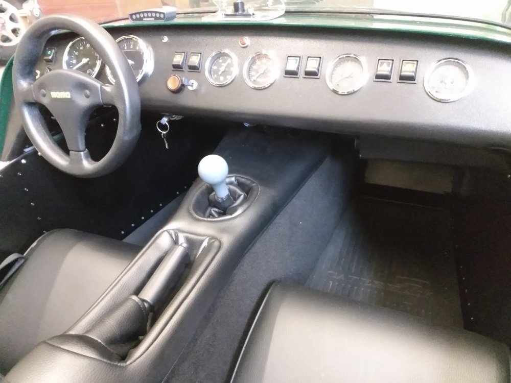

11Budlite Posted October 1, 2023 Share Posted October 1, 2023 I wanted to match the Stack Classic gauges (WT, OP, Fuel, Volt) with a nearly identical looking Tach and Speedo and went with Speedhut. The Speedo is a GPS unit and has worked flawlessly so far. You can configure the gauges with different faces, bezels, needles, lighting, etc, to get look you're after. Sorry for the crappy photo. 2 Link to comment Share on other sites More sharing options...
