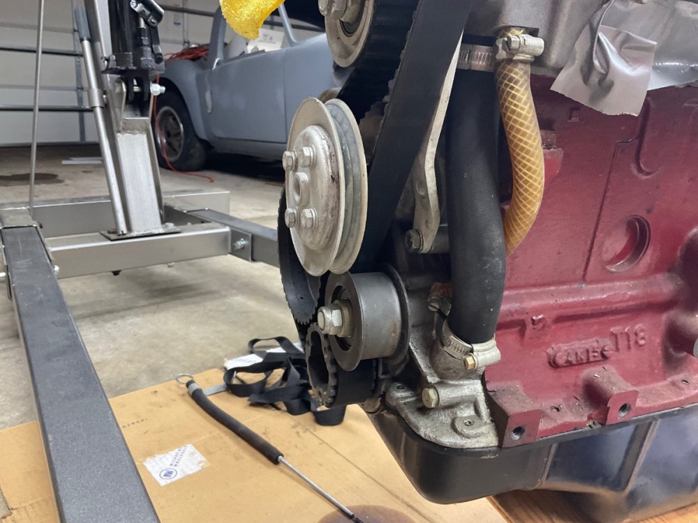

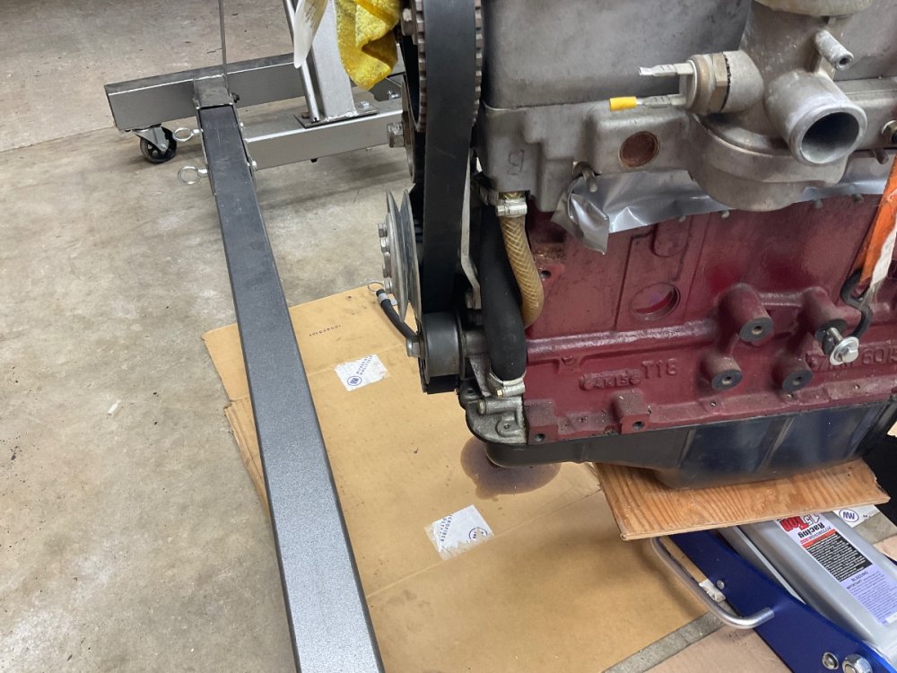

Wayne Stambaugh Posted November 9, 2023 Author Posted November 9, 2023 Here are pictures of the oil drain hose and the crankcase vent hose. As you can see the oil drain return hose is fairly large maybe 1 1/4” in diameter. Since the car only had 31 miles on it I have to believe both these hoses are original. They are both hard as glass. I added these pictures for those who may not be familiar with the BDA engine’s features. I worked on the gearbox this evening briefly. I gently pried the gears back and forth while putting a little pressure on the shifter after spraying the rods with WD40 and all of a sudden it shifted. I put the top cover back on and it shifts just fine in all the gears including reverse! I kept shifting it for several minutes and never had a problem. Looks like I’m over that hurdle now. Now it’s time to change the timing belt and get the engine sealed. 1
MV8 Posted November 9, 2023 Posted November 9, 2023 That's great news on the trans. No pics but I am assuming that is the outside diameter that is 1-1/4 and may just be a very thick wall. If you wish to reuse the fittings and replace just the hose, the crimped shell can be cut straight across with a die grinder (just deep enough to see the rubber) to use a screw driver to split it off, releasing the hose and making the fittings reusable and indexable (with the clamps loose). It can be difficult to remove the crimp collar so remove the hose from the car and cooler and put the fitting nut in a vice to hold it (not too tight). Once removed, you can measure the fittings for the right size hose. The hose can then be replaced and a radiator hose clamp or a crimp collar/oeticker can be used. Sae30R7 fuel/evap/oil hose comes up to 3/4 ID (heavy truck supplier).

MV8 Posted November 9, 2023 Posted November 9, 2023 Replace the reinforced pvc drain hose (available at Home Depot for sinks) with R7 fuel/oil hose. Need to measure the barb or hose id. Though it would see only crankcase pressure, it would be nice to have a pressure rated (reinforced) hose but those have a thicker wall, so if 1-1/4 od, then it will likely be less than 1 inch id. If it is 3/4 od, you can use R7.
inchoate Posted November 10, 2023 Posted November 10, 2023 Your hoses look exactly like mine. I've never had any leakage or issues of any kind with them. I guess you could replace them if you're taking the heads off but I've never seen the need.

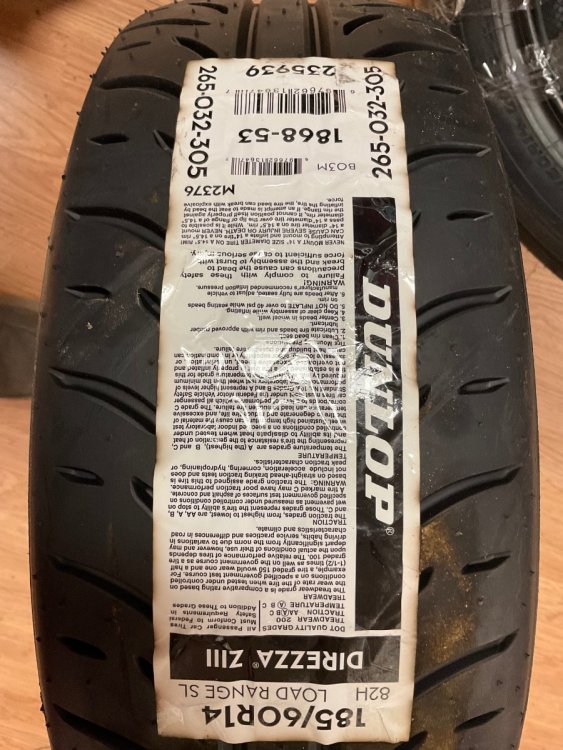

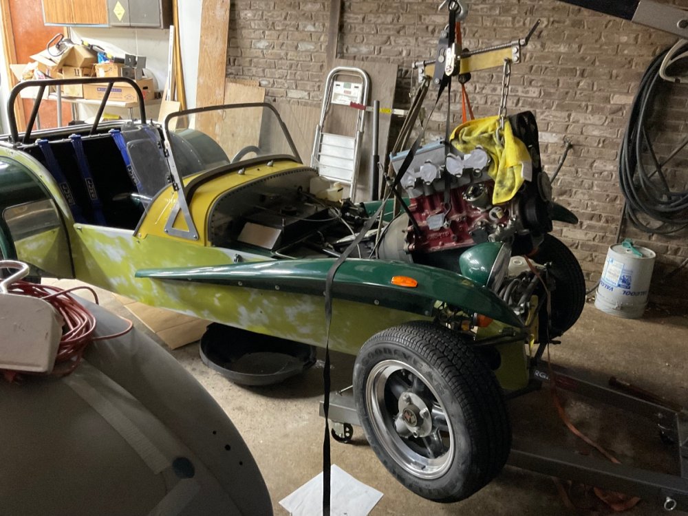

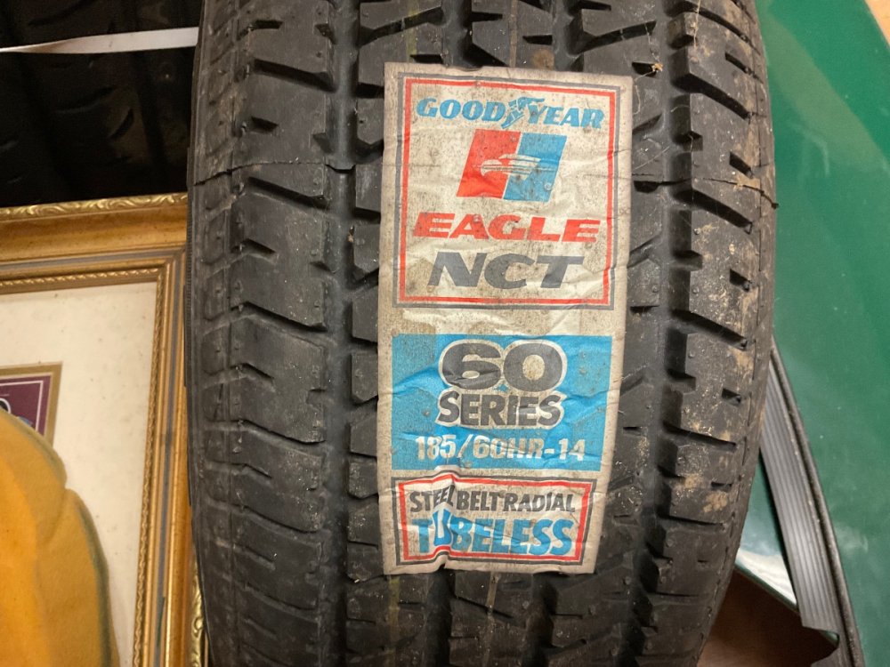

Wayne Stambaugh Posted November 10, 2023 Author Posted November 10, 2023 Today, I’m doing a variety of different things. The car is up on stands wheels off. I’m looking at fuel line routing and determined that nylon or plastic of some kind is used to go from the tank to the engine bay. As MV8 stated steel line of NiCop is probably the best thing to use. Looks like I’ll have to remove a few panels inside the car over the tunnel to acomplish replacing the line. I removed the wings front and rear to prepare the body for paint. I have talked about replacing all things rubber and while I was taking wht wheels off I got to thinking about tires. I have attached two pictures of tires the Goodyear Eagles are what went on the car in 1986. Needless to say regardless as to whether they were exposed to UV or not, I’m not going to run them. The second picture is the new tires that came with the car. They are two years old which is probably fine. I have been told to save those tires for purposes other than daily street driving. My question is, what is a good tire for everyday use on this car? As you can see in the pictures I have 14” wheels and at this point in time I want to stick with 14s. I will not be trying to shave a couple of 1/10s of a second off my lap times or anything of the sort. All I want is a decent tire to drive the streets with. Any recommendations? I hope to get to the engine today and get some pictures of the insides of the cylinders, so back to work. a
IamScotticus Posted November 10, 2023 Posted November 10, 2023 (edited) I would use what you have. Probably better to be on rims moving around or sold off than sitting. Edited November 10, 2023 by IamScotticus
MV8 Posted November 10, 2023 Posted November 10, 2023 I like these, but I carry out since I have the equipment: https://www.walmart.com/ip/Waterfall-Eco-Dynamic-185-60R14-All-Season-Tire/454885257?from=/search I second running the dunlops. Tires have a shelf life. Check the date codes on the side walls. If over 4 years old (no matter when they were sold), you might want to pass and buy new.
panamericano Posted November 10, 2023 Posted November 10, 2023 I had both those Dunpops and Falken Azenis (sp?) 650K (?) on a Miata for autocross and street. Felt and scored the same. Falkens cheaper.
Wayne Stambaugh Posted November 10, 2023 Author Posted November 10, 2023 1 hour ago, MV8 said: I like these, but I carry out since I have the equipment: https://www.walmart.com/ip/Waterfall-Eco-Dynamic-185-60R14-All-Season-Tire/454885257?from=/search I second running the dunlops. Tires have a shelf life. Check the date codes on the side walls. If over 4 years old (no matter when they were sold), you might want to pass and buy new. They are almost 2 years old.
