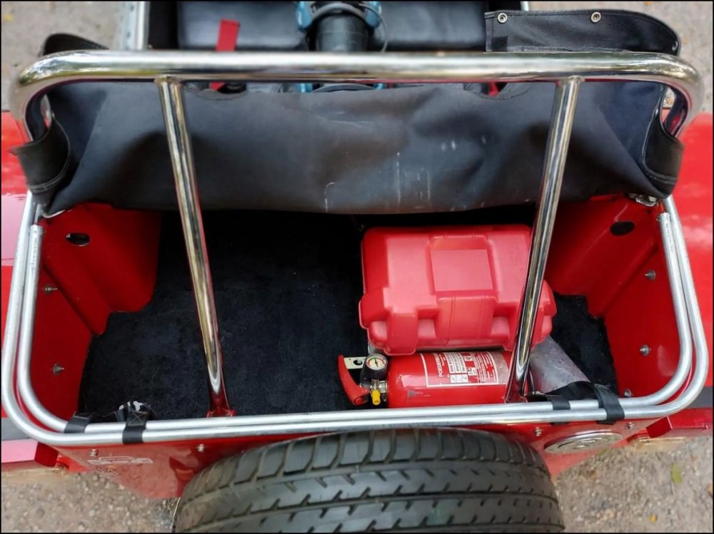

theDreamer Posted January 5, 2024 Posted January 5, 2024 I think moving a big, heavy battery to the opposite side from the driver near the rear axle has some merit. Although, I’ll bow to MV8’s wisdom on best location for polar moment and CG. You asked for photos and so here is one I know and have seen IRL. This is by no means an ideal installation but will give you an idea of how much space a full size car battery will take up in that small boot. I believe there are better, smaller sized batteries on the market today. If this is you location of choice I’d look at motorcycle batteries. A big “L” or “V” twin needs lots of juice to fit in a smaller space. This photo is from the on-line auction site Bring a Trailer. Look here for more images between #76 and #79: https://bringatrailer.com/listing/caterham-super-7-2/ 1
EdWills Posted January 16, 2024 Posted January 16, 2024 Hi Scott. The Series 1 and Series IV Seven had the battery mounted in the boot. It would probably require a smaller capacity fuel tank to accommodate the battery as per the Series 1 unless you can mount a fuel tank above it as in the Series IV. In the photo above, it appears that the boot board is sitting much lower than normal for a Seven, so allowing the battery and fire extinguisher to be fitted there. With the de-Dion set-up on this particular car, there should not be a problem of the differential case hitting the underside of the lowered boot board (a definite possibility with a solid rear axle car) as in the de-Dion set-up, the diff case is bolted firmly in place. You can check SimpleSevens.org, and search the 'History' section, click on 'David Porter's 7/20' article, and at the very bottom of this section there are photographs of the bare chassis of a 7/20 look-alike race car. In one of the photos it shows the bracket for installing a battery at the rear on the opposite side from the driver. The fuel tank in the 7/20 is smaller than the regular Seven Series 2 or 3 tank. Caterham had a battery bracket manufactured by Arch for their Sevens that fitted on the passenger side of the car in front of the firewall in the lower engine bay area. Tony Weale noted that it may be difficult to service the battery in this location, and Caterham resorted to using a 'no maintenance battery'. If you check the Odyssey Battery web site, there are various sizes of dry cell batteries that may be suitable for your use. USA7s has a forum page detailing various batteries for the Seven with recommendations from owners. Cheers, Bill
