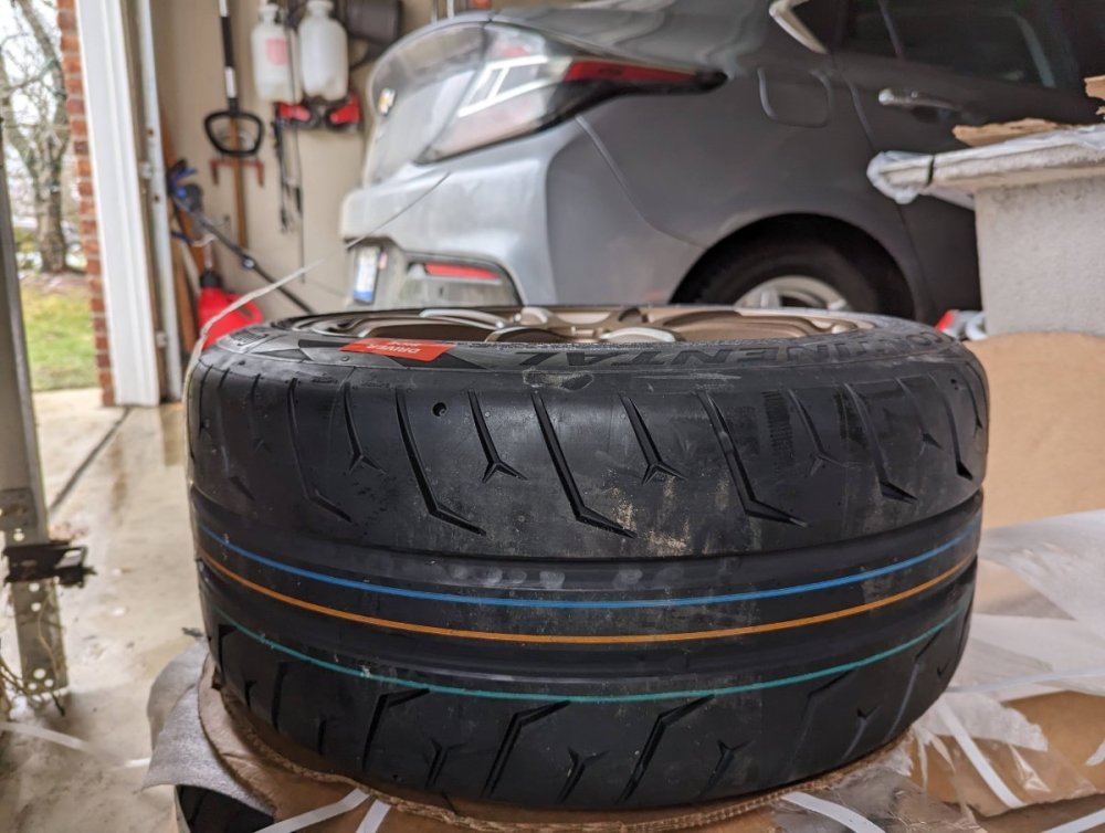

I ended up getting the Continental "ExtremeContact Force" for my WCM this year.  225/40/17 front (8 inch wheels) 245/40/17 rear (9 inch wheels).  They are supposed to be on par with the Hankook's but a little lower profile and less expensive.  Less grippy than the Falkens, but not as sensitive to heat cycling out.  These should work for me driving from home to the track, doing some hot laps, then driving home.
@Croc Hankook RS4's may also need to go on the list of options.  Tire rack doesn't seem to stock all of the sizes at the moment.
PXL_20240127_174820082.thumb.jpg.7bb9d2f8e1f1bdb4b5f860f078ee6790.jpgPXL_20240127_175038977.thumb.jpg.8d81e65bb5f04b1cf5fc5314e42d96b9.jpg
