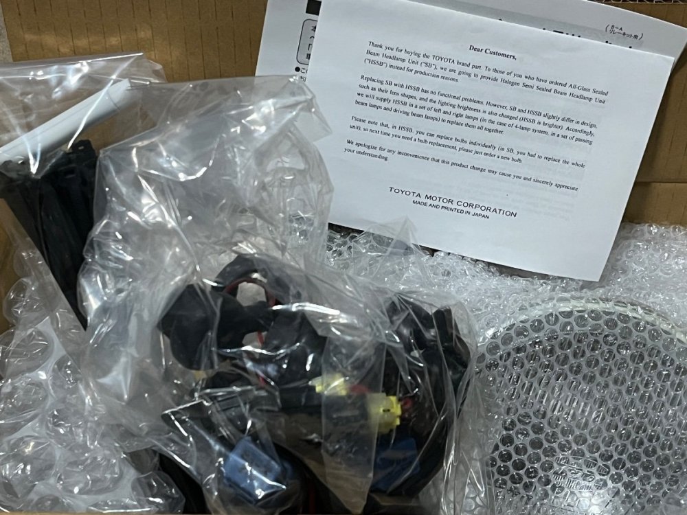

Apparently Toyota never sold H4 housings before, only sealed beams, and production constraints have kept them from being able to supply the old part number and they're shipping these instead.  I've ordered a set from my local dealer, just to have a spare set... Hopefully it will actually come through!
Bonus: It comes with a letter of apology from Toyota!

So, I can confirm this deal is real, not bad for $16! Also came with inline fuse holders and fuses, about 40 zipties, and dielectric grease. The relays are not made in Japan but they are Omrons.

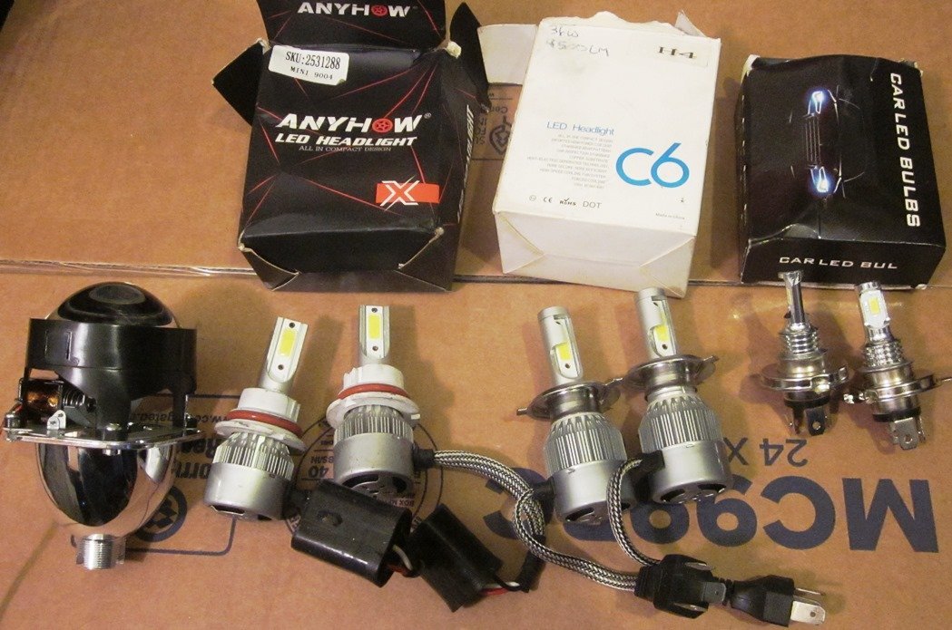

For reliability, due to the confined space available to fit led chips most leds made to fit a head light bulb socket have integral fans on the back. The seven bucket makes this more critical as there is zero airflow available at the back of the light housing inside the mounting bucket. Select an led equivalent to the bulb watts for higher reliability and less glare in the eyes of other drivers.
Glare can be from excess output but also from the direction the leds shine compared to the bulb the housing was designed for. The leds usually have an adjustable clocking in the housing to get the best balance of glare and distance. A light can appear very bright yet the distance compared to a halogen is much less.
Some led conversion lights have zero discernable difference when switching between high beam and low beam.

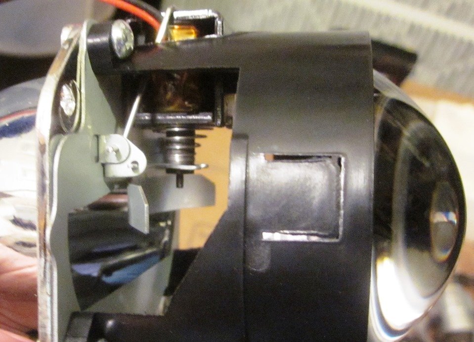

The best replaceable bulb conversion housing is a projector with a servo door inside that blocks part of the beam for low beam situations. They make kits for converting oem assemblies to this but I've not seen this in a 6014/6024 H4 conversion; probably due to insufficient space for the kit.

I can post some pics as I have examples in hand of everything.
These are 9004 and H4 leds. Note the large finned heat sinks and internal fans on the higher output leds. The mounting ring can be rotated to adjust the led clocking. The retrofit projector clamps into an existing oem head light opening and requires a small led lamp due to the small opening available. Note the servo door that blocks part of the beam and is opened for high beam.
