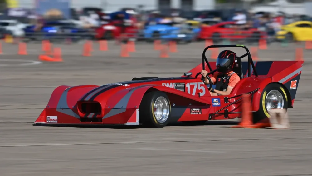

panamericano Posted June 26, 2024 Posted June 26, 2024 Check the SCCA website for the car that usually wins DM at Nationals and see what is running at other national tour stops. From the few photos I recall, I would bet you are up against 200 HP (bike) and 900 pounds. Like Bernie said, the cars are custom built race cars. A WCM should be able to hold its own in Region, Division and no idea about Pro and Tour stuff. Just depends on who shows up. I wouldn't let all that be too big a concern in buying a good WCM.
11Budlite Posted June 27, 2024 Posted June 27, 2024 (edited) I have no experience with autocross, but I agree with what's been said previously. Looking at the results from last year, it looks like an Ultralite would be a good starting point to build a competitive D-mod car. I think you'd have to modify it to the limit of the rules, and then develop the suspension, drivetrain, and aero to gain every advantage of the platform. It should be a fun endeavor. Here's a photo of what I believe is last year's winner. Edited June 27, 2024 by 11Budlite
