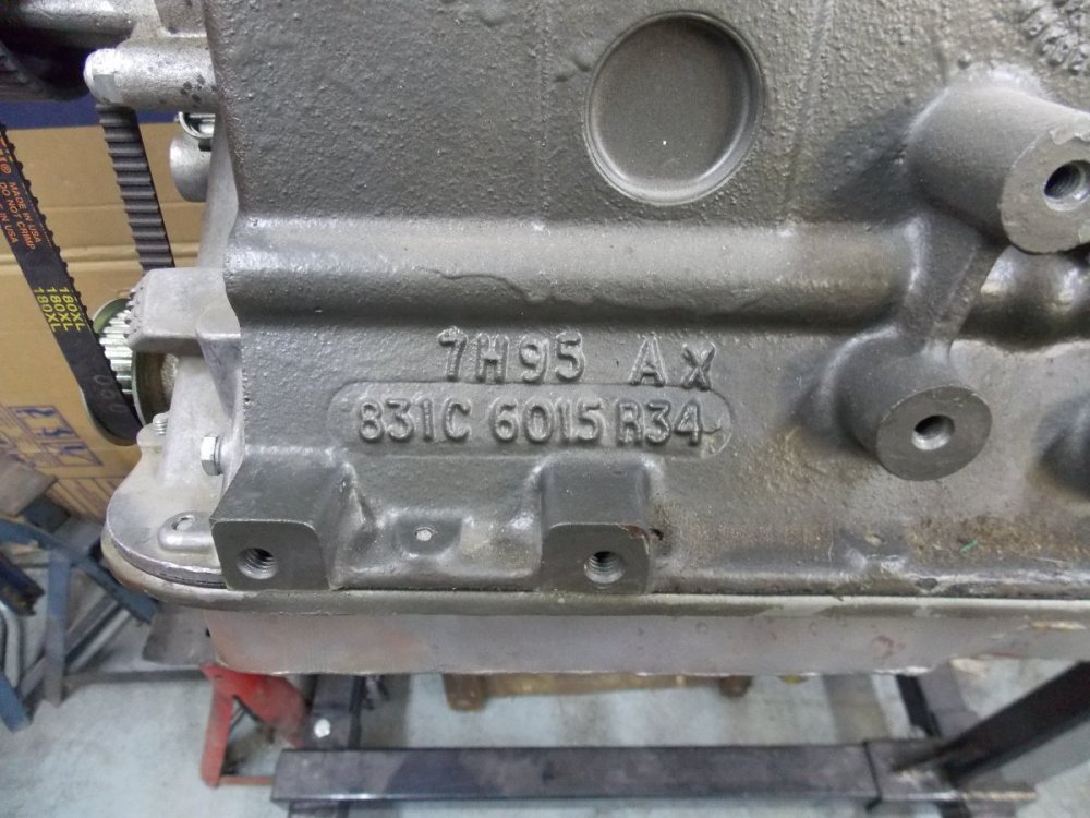

7Westfield Posted August 25, 2024 Posted August 25, 2024 I picked up a trailer full of formula ford parts the other day, and this xflow was in the mix No numbers at the back, where you find 711M, etc But, at the front end.... Is this what it looks like? Seems overkill for a 115hp FF engine
7Westfield Posted August 25, 2024 Author Posted August 25, 2024 thanks MV any idea what the difference would be, vs a 711? obviously not much, or it couldn't be a FF block
MV8 Posted August 25, 2024 Posted August 25, 2024 I expect it has higher nickel content (stronger and heavier) plus it can be bored larger than a 711 safely.
IamScotticus Posted August 25, 2024 Posted August 25, 2024 (edited) This is the golden boy, AX block. Very valuable. Get a head with it? Edited August 25, 2024 by IamScotticus
7Westfield Posted August 25, 2024 Author Posted August 25, 2024 better than that, according to some paper with it, it's a fresh Arnie Lyoning FF build

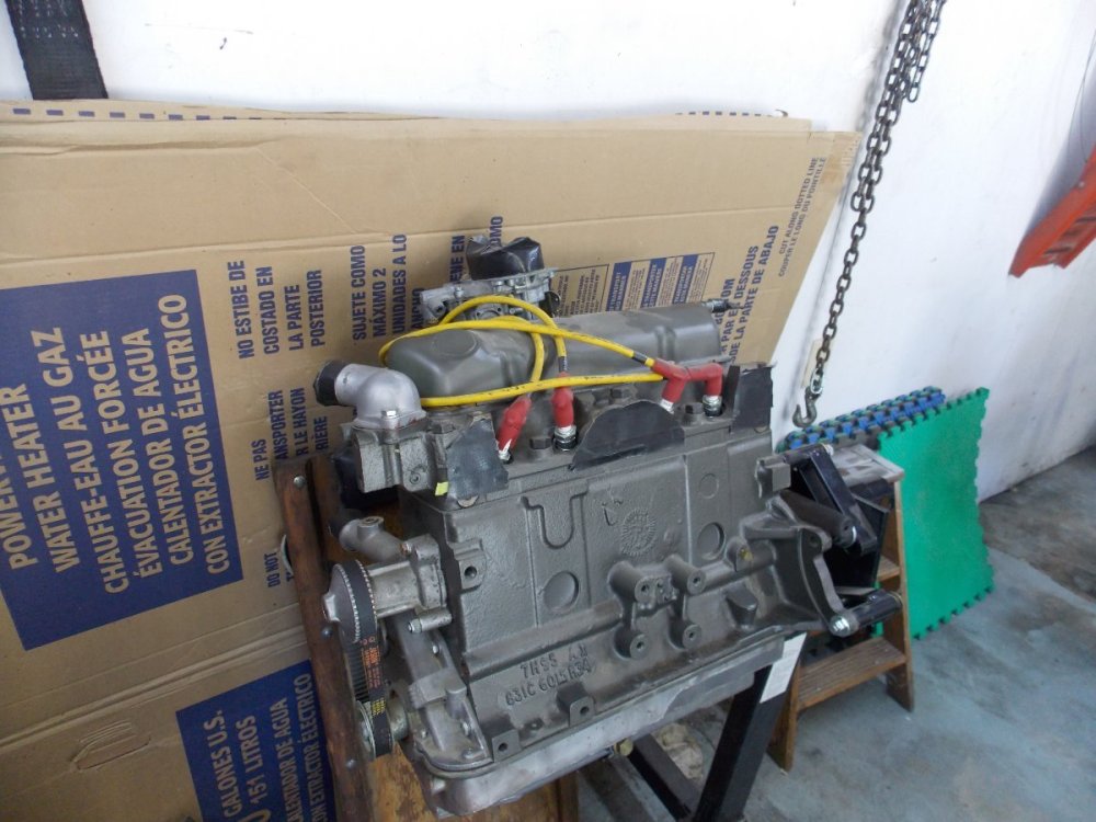

7Westfield Posted November 27, 2024 Author Posted November 27, 2024 So, an update first, it's def not an Arnie motor it is a fresh build, but prob 20 years ago still has the Ford pistons, not the current CP items had an oil pressure issue, as in none priming pump on dyno wouldn't put up any pressure finally figured out the plug in the oil gallery right behind the cam gear was missing able to fix it without pulling the gear and every gasket leaks whoever built it only put sealer on one side after all that, it did fire right up 108hp so prob a good number back then, but not now but it has a new home with a friend who's going to refresh it for his Dulon
