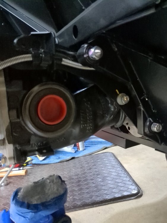

Legs Posted June 17 Author Posted June 17 Well I got the front weeping sorted by flushing the system, undoing the adapter, heating the washer with a hair drier, then retorquing the adapter. So that's a win! Back to the brake travel, since I flushed the system, I filled it back up and also got an adapter for our power bleeder, so hooked that up and did two rounds of full bleeds. Brake pedal feels the same, very soft until it walls, still seems to be about 5cm. So, I put wheels on the front and lowered that down, undid the slide pins on the rears and tilted the caliper while I bled it, also giving some taps with a mallet. I can't get one of the rear calipers back on, it seems I may need a wide back tool, so I have yet to test if it's made any bit of difference, but there was only a small amount of air I got from the left rear. Right rear didn't yield any. Tomorrow's another day!

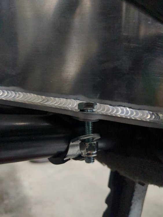

Legs Posted Sunday at 04:57 PM Author Posted Sunday at 04:57 PM Yea, no dice. But I was able to get some from McMaster. Onwards and upwards.. to the next road block: oil tank P-clips. I'm told 'the P-clips that come in the kit are not quite right." WTF! If that's a known thing, why is it still a thing 😭 I understand if the car cost a small amount, but it's way expensive imo to have faults like this. *Sigh* Ok rant over, I do need to secure this oil tank down. Several of the go-to build blogs have no mention of needing to bend the pclips, nor did they have any issues installing them, their pictures look like a correct pclip. So am I being gaslit!? 😄 The kit comes m6x20 bolts. This picture is with M6x30 bolts that I purchased, and I'm not comfortable with how it is. I don't think longer bolts will make any difference because the nut will always cause the pclip tab to bend. The issue is the pclip size. I did try to purchase some larger ones online, but they turned out to be too big, which causes a separate issue. Local hardware store only has p clips that are too small or far too large. My micrometer decided to malfunction in the move, so I'm awaiting on a new one. Might anyone know the correct size clip needed?
KnifeySpoony Posted Sunday at 05:21 PM Posted Sunday at 05:21 PM I had to buy some different P clips and custom bend them to work well. The top mount of oil tank was still too high so I shimmed it with some washers
Legs Posted Sunday at 05:27 PM Author Posted Sunday at 05:27 PM 5 minutes ago, KnifeySpoony said: I had to buy some different P clips and custom bend them to work well. The top mount of oil tank was still too high so I shimmed it with some washers Thank you @KnifeySpoony - any idea what size pclip worked for you?
KnifeySpoony Posted Sunday at 07:53 PM Posted Sunday at 07:53 PM Not sure, it was a few years ago. IIRC I went to hardware store and got a few sizes to experiment with.
