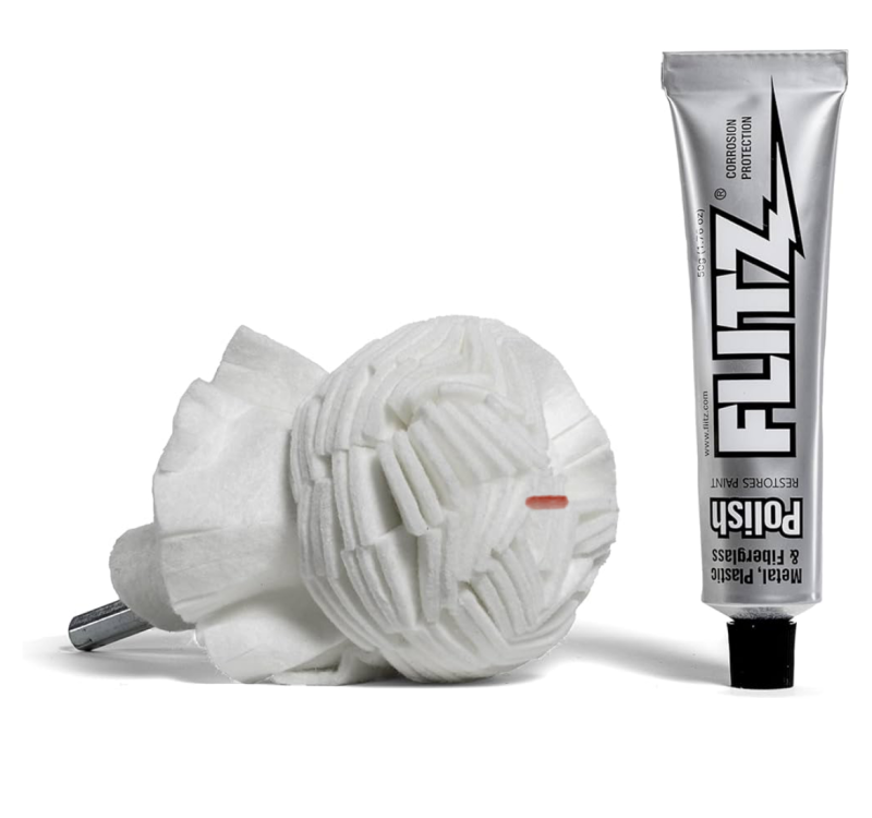

CBuff Posted October 11, 2024 Share Posted October 11, 2024 After last weekends track day I did a deal clean and started wondering about the exhaust. My car was new in June and the exhaust slowly turned blue and now a bronze with some of those colored spots on the collector. Well went down the rabbit hole on polishing. It was fairly straightforward and worked well. before: after Loosened the heat shield to access the cat. used this: Flitz Buff Ball Car Buffer Drill... https://www.amazon.com/dp/B002RCVQM0?ref=ppx_pop_mob_ap_share even with the drill buff ball took some elbow grease but not horrible. Buffed with soft plush micro fiber. I also got some smaller buff balls for in between the primaries. Link to comment Share on other sites More sharing options...

11Budlite Posted October 11, 2024 Share Posted October 11, 2024 That came out really nice! Link to comment Share on other sites More sharing options...
