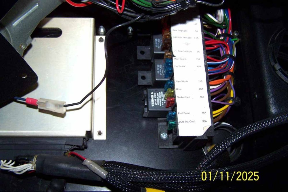

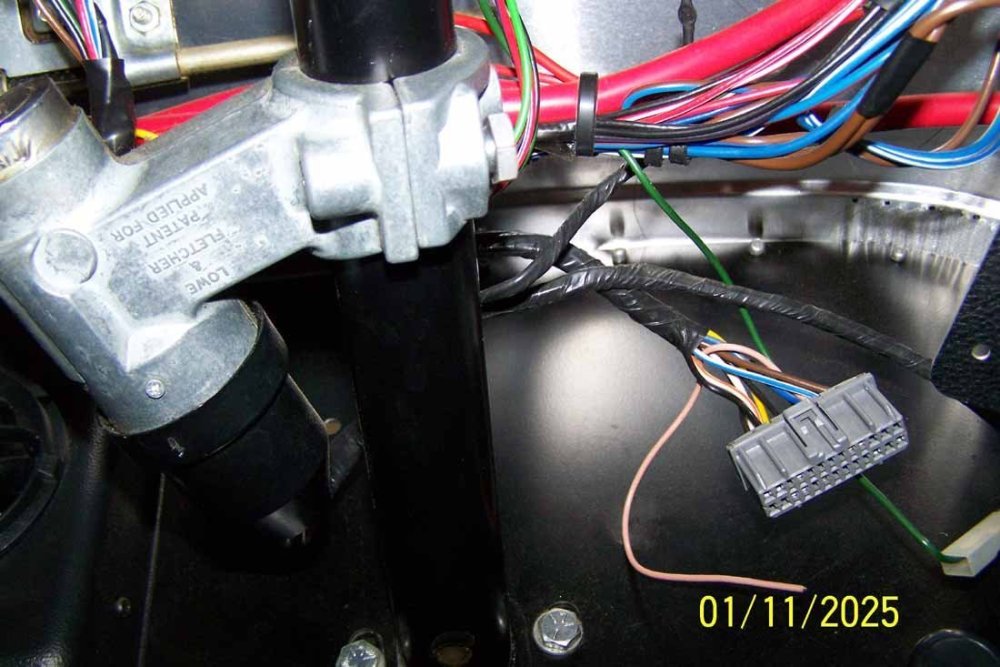

Apparently, with motivation from your post above, it did get me off my behind and out to the cold garage this AM where I stuck a camera under the dash and took some raw shots. The two from the drivers (RH) side answered some of my questions as to fuse/relay location. Now I just need a day of 50 degree temps and I'll be able to further motivate myself into getting the car up on stands so I can get underneath to review everything else.
Appreciate the assistance
Bill
fusebox1.thumb.jpg.f6427dff9b0a74767249ea431ace9490.jpgwiring2.thumb.jpg.2d18dc84fe9a7f007b3b8ee6101787b6.jpg

  On 1/11/2025 at 2:38 PM, mrmustang said:
Uncertain of the model of Pectel right now, as I have not delved in to the files to review everything.
Bill
Expand
if you got the car to run, albeit rough, I would suspect the pump is OK. Whenever I pick up a car like this(classic or used); no matter what the previous owner states(especially if not verifiably documented) I would replace all consumables/wear- plugs, filters, cap/rotor if equipped, tstat, water pump if car has been sitting long.
They’re cheap and It’s critical for me to baseline a car so I can maintain going forward; it’s been my experience personally and helping others that the one or two things you don’t replace are the very ones that will leave you stranded on your “new” car when you least expect.
Relay/Fuses- can locate relay even without diagram- there will likely have one for fan, horn, pump, injectors, coil(s). Once you locate the cluster of relay and fuses, quick process of elimination to remove each one and map which deactivates what. (Same applies for fuses btw if no manual on hand)

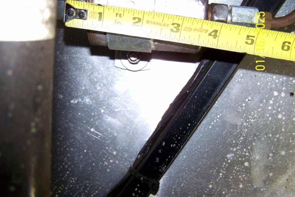

Motivated after a full pot of coffee and a bagel this am, the car is now up in the air (or as far as I can get it), hood is off, and I've had a chance to crawl under to look things over. Found a nice tidy Caterham sump, really nice install of the harnesses, although I've got a drop of oil on the floor, but it's not coming from the pan, I'll figure that one out.
Injectors are a "D1610BA" which translate to a 30lb/hr low impedance unit, I'm wondering how long they have been installed, too clean to be the originals, but they have to go as the Percel unit specifies high impedance injectors.
Fuel filter is a mystery item, as I cannot find a part number on it, the body itself is 3" long, have not figured out threading yet, almost afraid to take it off as it may be under pressure. Don't want to spray myself with fuel.

Looks like a Chevrolet fuel filter common through the late 90s, plus adapters to fit the hard lines. Look up a 1990 c1500 pickup for an application. Wix 33481 and Fram G3727 are a couple part numbers. The rubber fuel hose near the filter can be replaced by cutting the sleeve over the end, then use a flat screwdriver to bend the edges out and pull it off with pliers. Use a hose clamp.
If you wanted to rearrange, you could use a late 80s s10 fuel filter with a hose barb on the tank end and an inverted flare brake line on the fuel rail end, wix 33483 or use the ranger filter. Many options.

Really hate to cut a line with a factory end on it, however, I think you are on to something with the Fram G3727 , I had thought about a ACDelco GF952,(5.75 x 2.44 x 2.37 inches) might grab both and see which fits better, with less adapters. May bite the bullet and pull the old one to see if there is a part number on the back of it. Doubt it, but you never know
Two new pictures showing actual length (not the 6.5" with all the adapters) but a hair over 4", real close to the Fram 4.35" height
