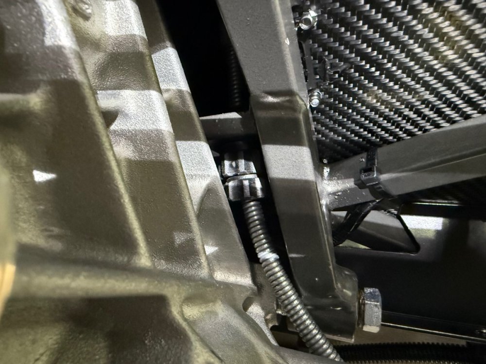

Adjust the handbrake … Oh my god!! … what a sh*t show!
For the uninitiated, there is a plastic adjustment ring and locking nut that you hand crank in and out to tighten or loosen the hand brake, it is situated on a clamp aside the rear diff. Laying under the car (With no access to your beer!)  you tighten several turns and then extricate yourself … test… return to previous position … rinse and repeat. Unfortunately, on mine, there was small hose clamp tightened on the cable behind the plastic locking nut. It was positioned in such a way that is preventing moving the adjuster as it was up against the Diff and Chassis tubing. Also it was rotated so that I could not get a screwdriver or wrench on the loosening bolt.
After struggling for a few hours, a lot of cursing and a few beers, I had no alternative to now start dismantling the assembled chassis; I exaggerate, but I did have to remove the passenger seat and the gear tunnel top to get access to the other side of the brake cable.

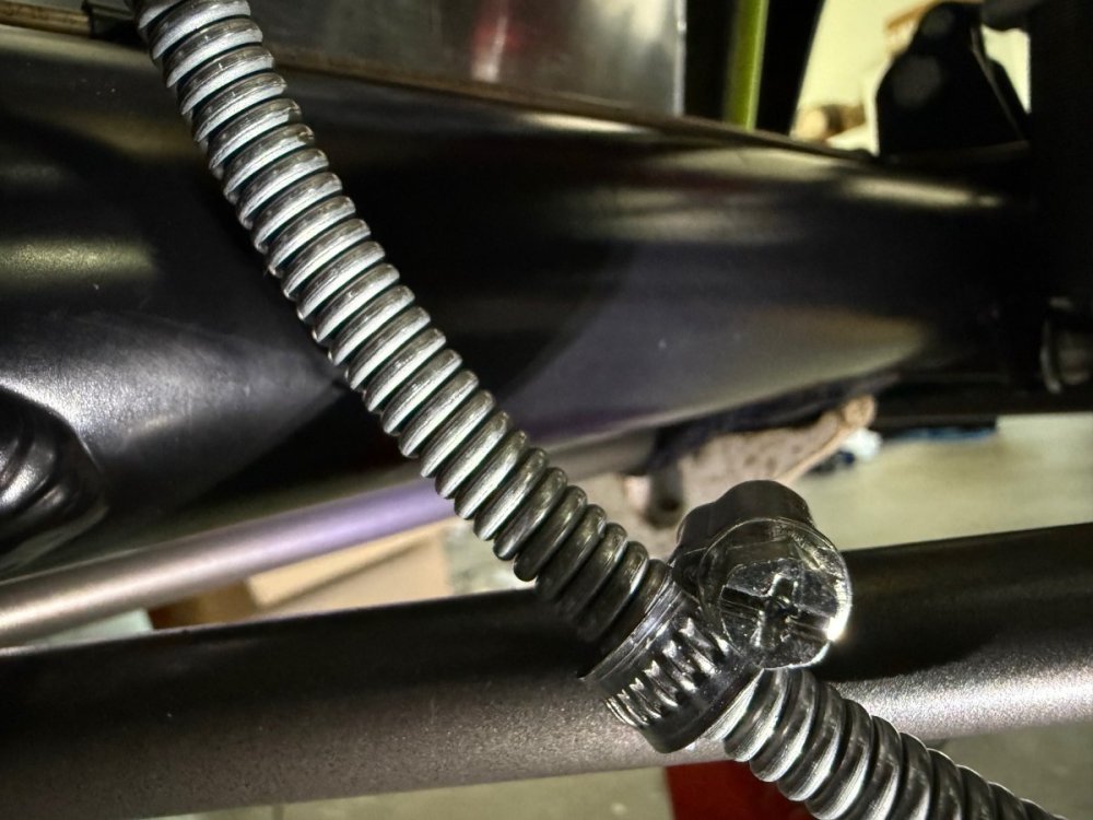

The Adjuster and locking ring and the offending hose clamp once I was able to finally loosen it ... suffice to say will ditch the clamp and replace with a large cable tie which can then be cut off easily for future adjustments.

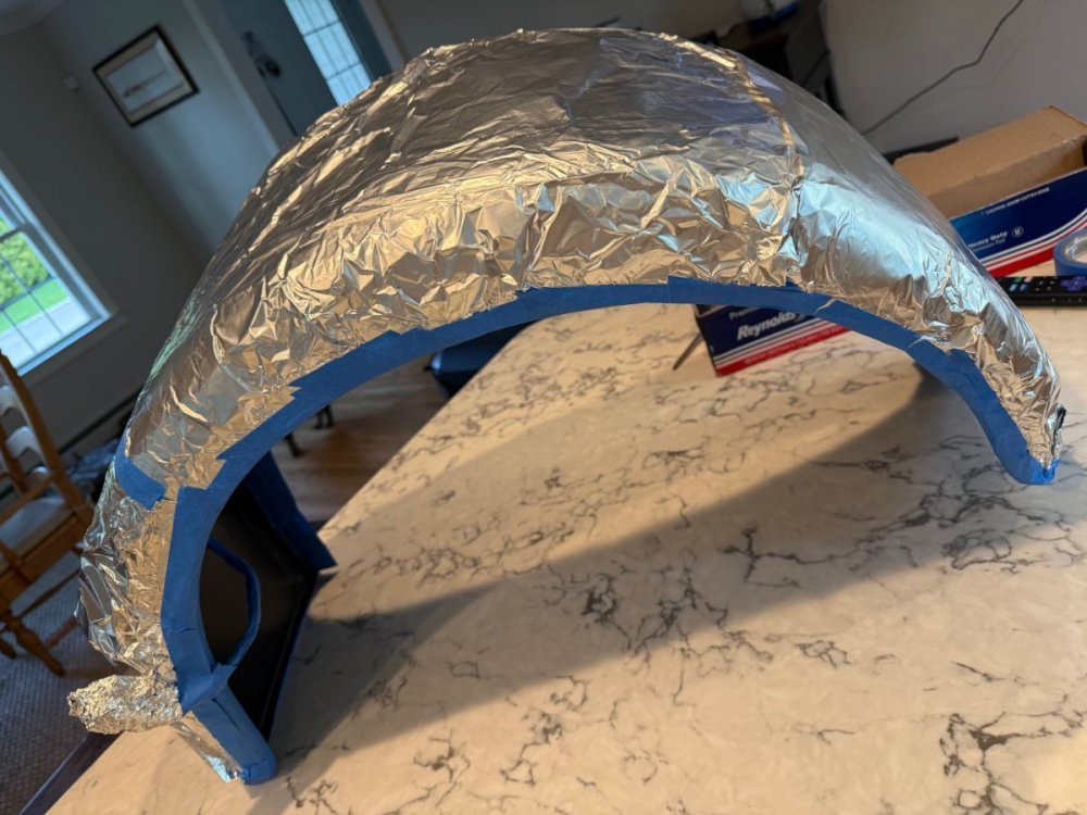

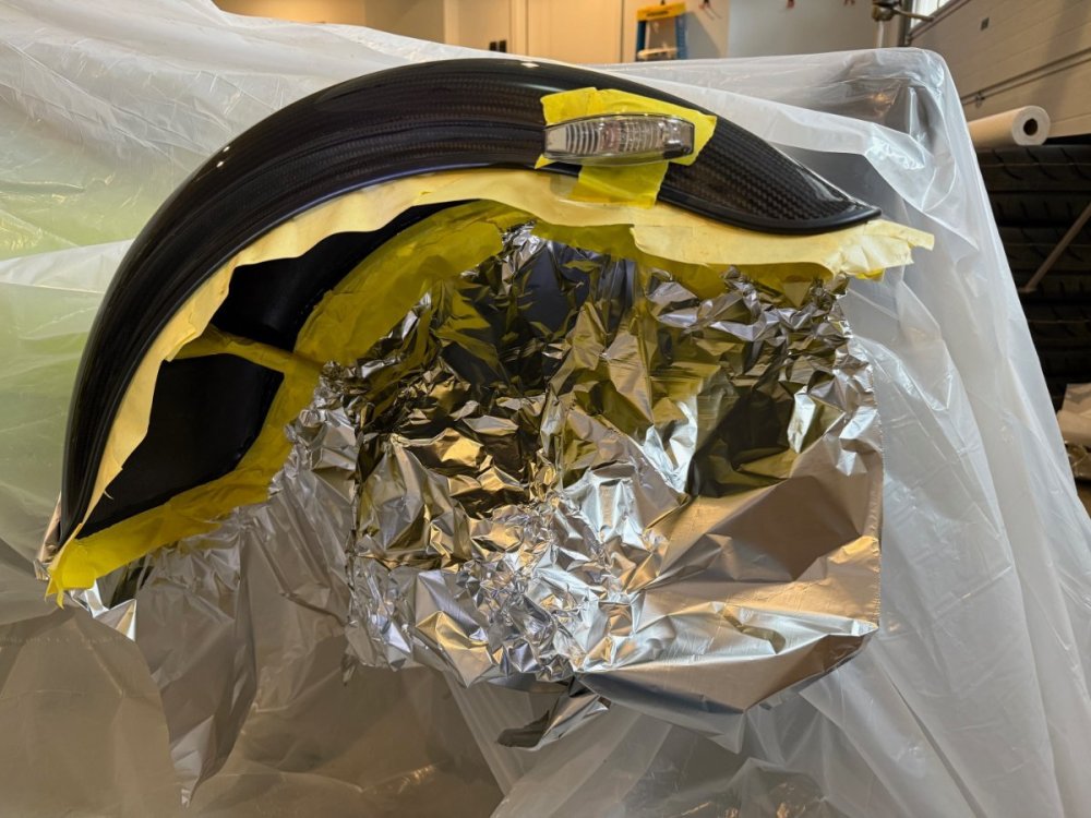

Sprayed the underside of the mudguards with 3M Rubberized undercoating to prevent spider cracking from stone damage. Just removed the rear and masked and then cursed the front ones for being such a pain to remove, then I masked the whole car. My previous build I used 'Big Heads' on the front cycle wings which meant they were easy to remove. I know someone will ask ... Why are you using 'Cooking Foil' as paint masking ... trust me ... try it ... makes things soooooooo much easier!!
Hi CarYenta
Probably more so in the sense that a fiberglass wing is not as strong as CF. I chose rubber spray coating but others have used stick on foam lining which works really well. Sort of a dense  black foam about ¼’ thick.
Pickles

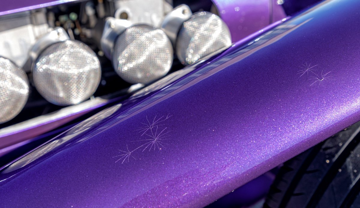

Highly recommended. My car has no visible stars on the rears but multiples on each front fender. It was part of the 30+ years of patina so I was not worried about it. Now I’m not sure if I’ll get both touched up or leave ‘em.
  • Shocked 1
This has been my method. Works pretty well, but I've also mostly avoided being in the water with the car

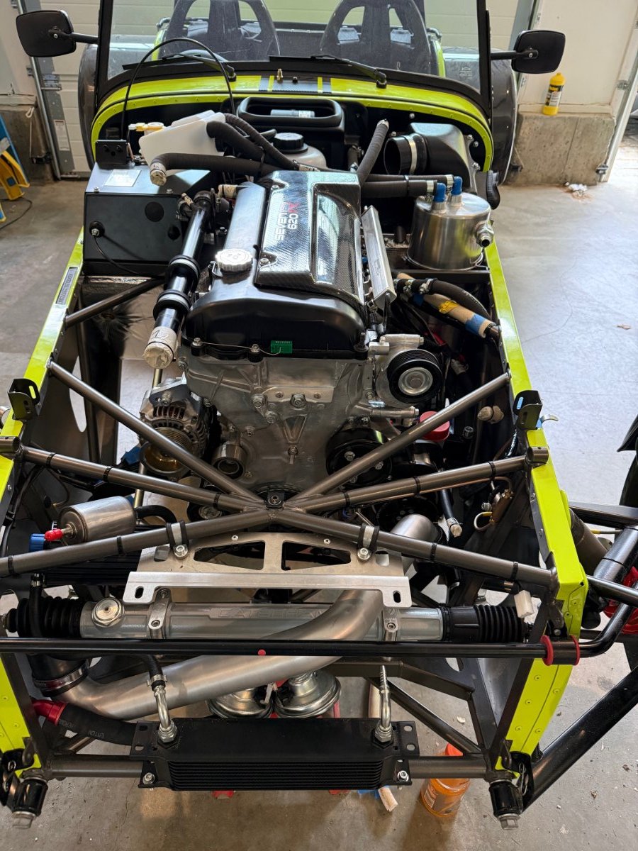

What a PITA! I have done a 360 build before, so thought I knew what we were in for, but this was a different dimension.
The main issue ... this was already a rolling chassis ... sounds like it should be easy but Nah!
I thought I was prepared
Removed intake / Super charger / alternator / starter / most of the 4 radiators (Engine, Oil, Super Charger, Inter-cooler)
I knew the tilt/lower/move forward the engine/gearbox assembly ballet. But the curve ball here was the prop shaft (loose in the tunnel) and the rear diff already on the vehicle added a fourth and maybe fifth dimension. Spent 2 hours trying to align the gearbox spline and prop shaft, until finally it just went into place. No idea what the magic sauce was but it worked!
Then the next hurdle, which I have currently not solved. I have the SADEV gearbox, there are a couple of electrical connections on top of the gearbox housing. The car loom has these hanging down in the tunnel ... so short you can't connect during the install, and so short that I need child hands to connect afterwards. But hey we spent another 2 hours trying and gave up to hit the booze.
But that being said the Engine/Gearbox are in!!
