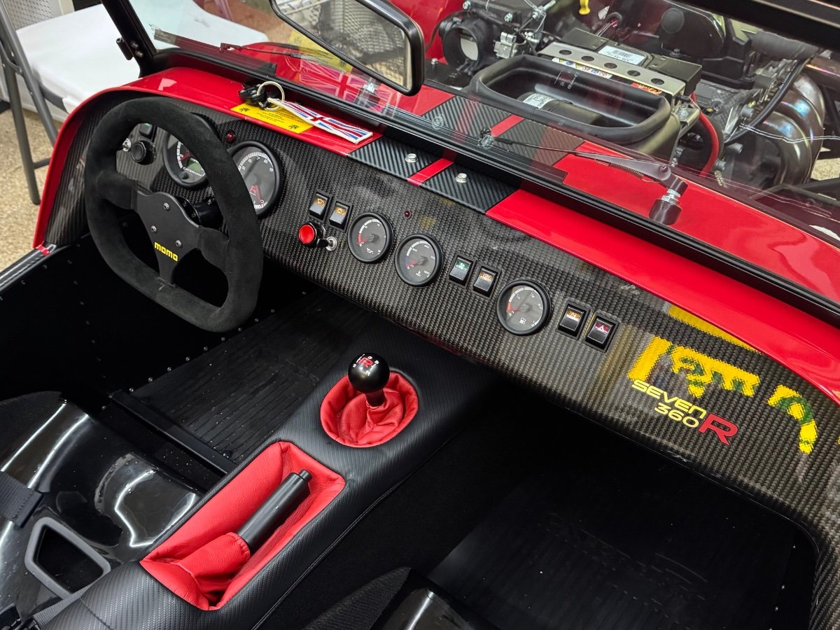

The car came with the good looking wood rimmed Caterham wheel, non removable.  It’s nice to look at but not so comfy to drive, and does not suit the rest of this particular car.  I have a nice alcantara OMP on the track Elise, feels so good especially with gloves on.  Today I received a nice little MOMO removable and the upper steering colume.  Looks pretty straight forward but two questions.
* I don’t have a shop manual for this car, can someone show a link to this procedure?
* What to lubricate the bushing in the instrument panel?  The one I have now is quite squeaky.

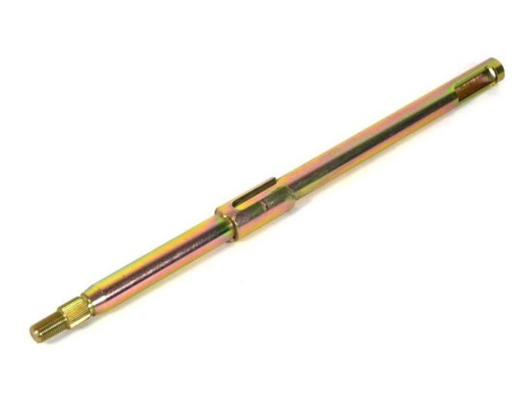

Your shaft, if typical, should have these specs:
Center nut: 9/16 X 27 TP
Shaft: 5/8 x 36 spline same as Lotus 7 and
Austin Healy Sprite S1 & 2

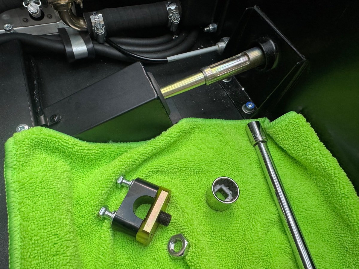

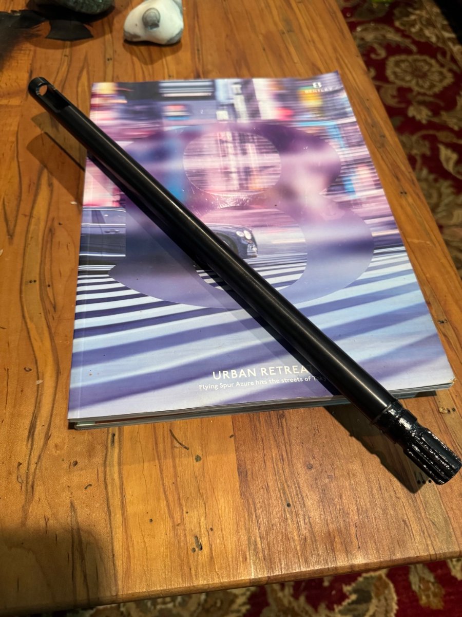

Here’s the new upper steering column.  Apparently the one I need to remove is made differently?  Have something cleverly welded to it to impede doing anything with it?

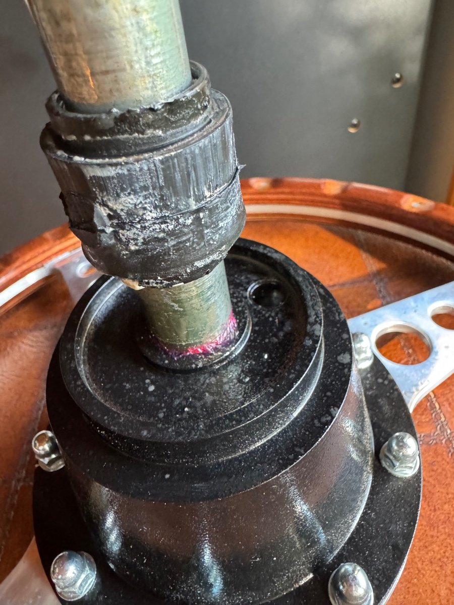

And here’s the “factory” OEM piece.  A nice looking something has somehow become welded to the poor innocent shaft.
Josh is sending a bag of bushings for me to trundle through.   I’ve given the water feature my all and time will reveal the depth of my folly with that.
And to complete the circle, there is something of a reason it’s there, knowing this will help me reat better:
”It's for the steering column lock off of whatever original Thatcher-era British Leyland horror the original upper column is from. (UK road inspection requirement.)
As the QR version is custom, it consciously omits the lock as everyone loathes it: pushing the Seven around the garage is impossible with the lock unless the ignition is turned on. And of course one immediately forgets the keys are in the lock barrel -- upon finally remembering, comes back to find a dead battery.)

Yup, you’ve discovered the infamous column lock, which you will be rid of after swapping columns! Don’t worry, the old one will come out with a bang given enough encouragement. But again, make sure your key is in the unlocked position first or the lock itself will be preventing removal (or so I’ve read). The second stop is when the collar hits the bushing. At that point you’re gonna need to apply force or push and then yank.
And it’s done.  The little pond is holding water at a test level, and the steering column is out!  Did just what y’all said, a penetrating bath every 30 minutes, opened the key and out she came.

Next hurdle,retrieve the bushing.  Red lock tite is evident….

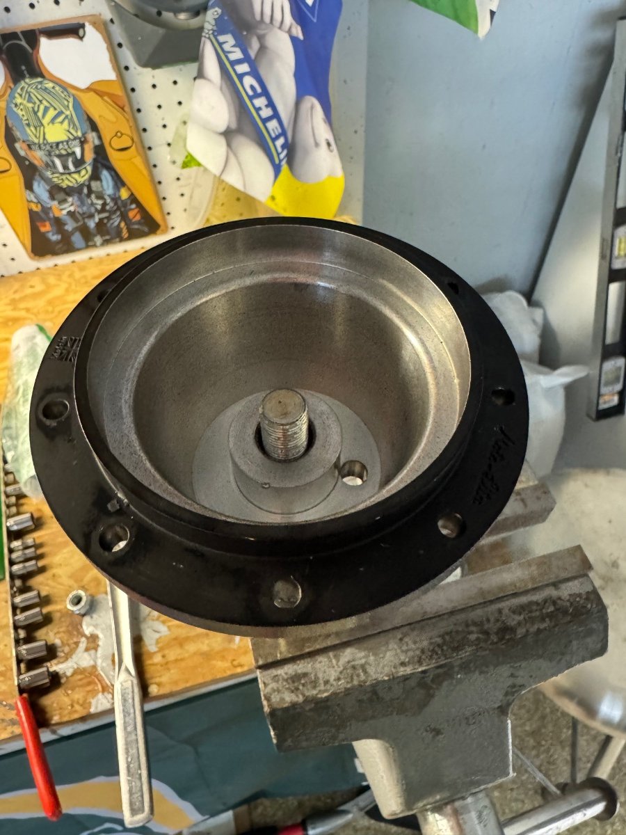

This is how far I got disassembling the wooden steering wheel to retrieve that bushing.  It looks fine, both dogears intact as new.
i got the locknot off from inside the set up dut can’t decide if this housing is rhreaded on or friction fit.
Or should I just leave it on there for the next owner of the wheel?  I have one on the way and am now seem to think I’m fairly knowledgeable.

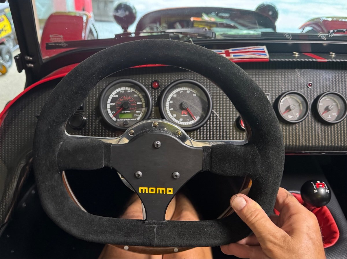

And it seems like we’re fairly close to center, not driven yet to test.  I’d rather not learn about splines in the steering rack this week if possible.  Much less alignment suspension settings….😱
Notice reflection of Lotus sign
I’m going to investigate having it recovered in red alcantara with black stitching and yellow stripe on top.  And pad it out with tennis racquet grip to better fit my hands large palms smaller fingers) under the new covering.  Easy to leave it at their shop now.
it’s got splines, if you put it in a vise and re-attach the steering wheel you should be able to pull-and-wiggle it off, I didn’t think of that at the time and instead got a jaw puller to take it off (which worked!)
The second time I did the job (after my first botched install) it came right off without using a jaw puller or anything. You might get lucky and be able to pull the boss off without any help…
