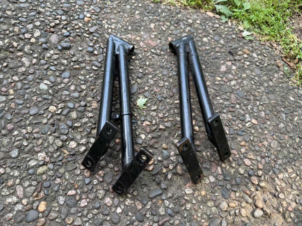

11Budlite Posted August 1, 2025 Posted August 1, 2025 These are the best photos I have of the Birkin mounts for a Zetec if that helps. 1

3Ducs Posted August 1, 2025 Author Posted August 1, 2025 1 hour ago, 11Budlite said: These are the best photos I have of the Birkin mounts for a Zetec if that helps. Thank-you for these excellent photos! I will be using a Kent engine, 1600 or 1700cc. 1

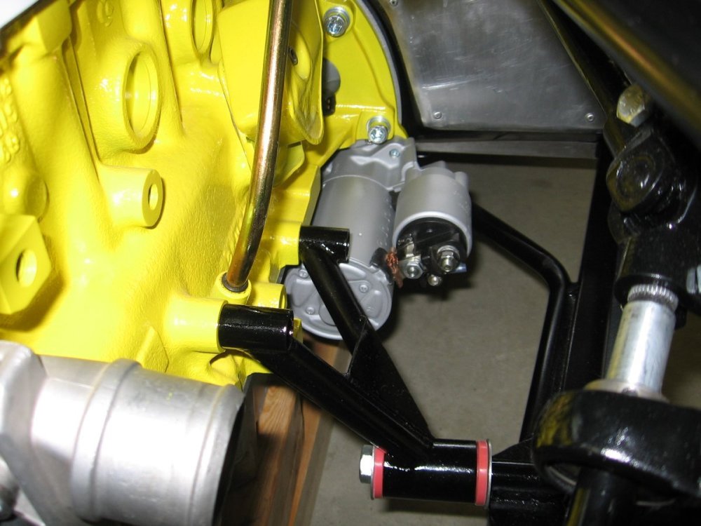

MV8 Posted August 1, 2025 Posted August 1, 2025 Here is a Birkin crossflow left mount. I expect the hidden part is like the zetec. 1

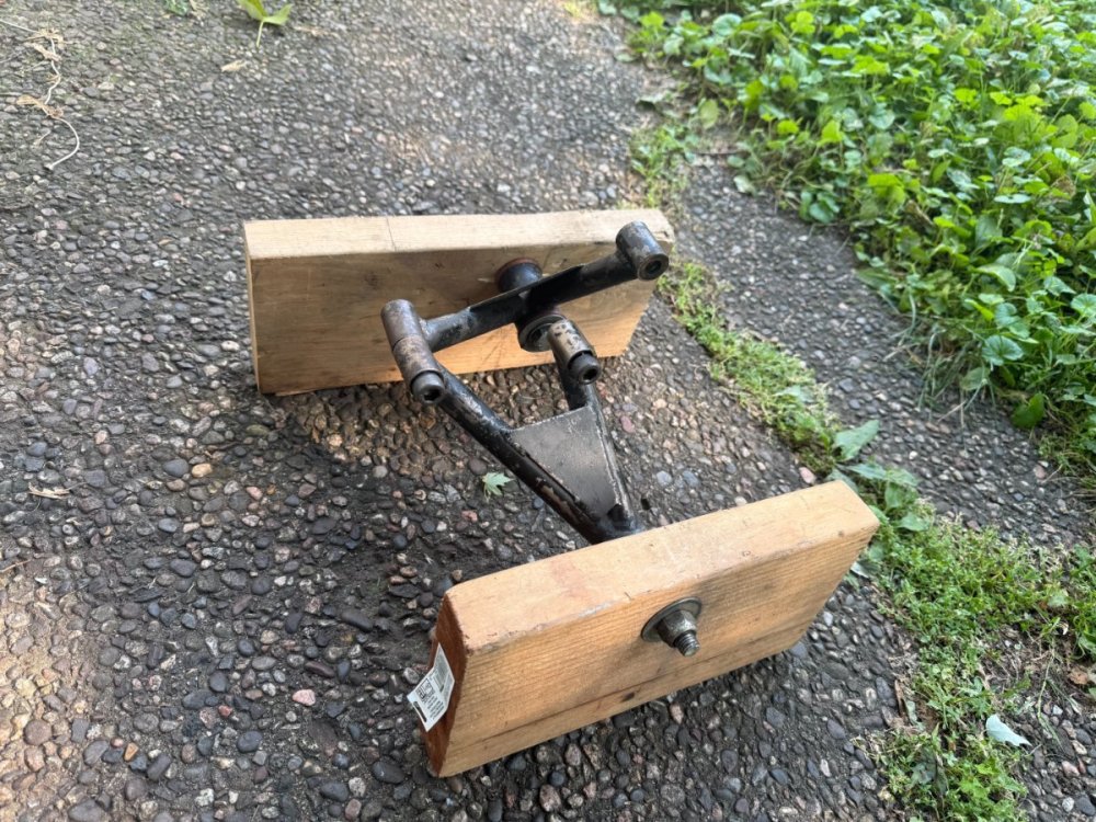

IamScotticus Posted August 2, 2025 Posted August 2, 2025 (edited) Here's a Caterham Xflow mount on a XKE isolator. Yes, those are fan blades. Three holes in the frame. Simple. And you need simple. But the Birkin mount is superior in that it resists sway better. The XKE isolators go soft quickly in this car. But If you can't locate Birkins, I think the Caterham/Lotus type is easier to fab. I will have to see if XKE isolators are available in a more durable rubber. Lately they have been known to be produced taller in height than what 7s use. Either taller or the rubber doesn't compress for the engine to settle at normal height. So I have read. I have new isolators I will have to compare. But this isn't a problem for anyone building new brackets. Edited August 2, 2025 by IamScotticus 1
