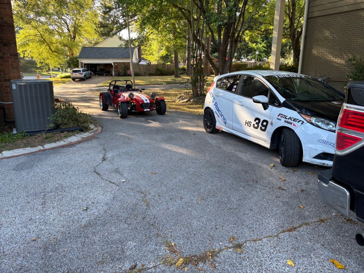

1992 with 1400 K.
Sat for 3 years and change.  Siphoned the old gas out of the tank and replaced with new, changed oil, flushed radiator, etc.
Starts and runs fine for a short drive down the block and back.  After shutting it off and then trying to restart after 5-10 min, it will sputter and die, then not start.  Starts fine after sitting overnight.
I’m thinking the fuel filter needs to be replaced, but maybe the fuel pump relay too?
Been way too long.  Felt good driving it.
