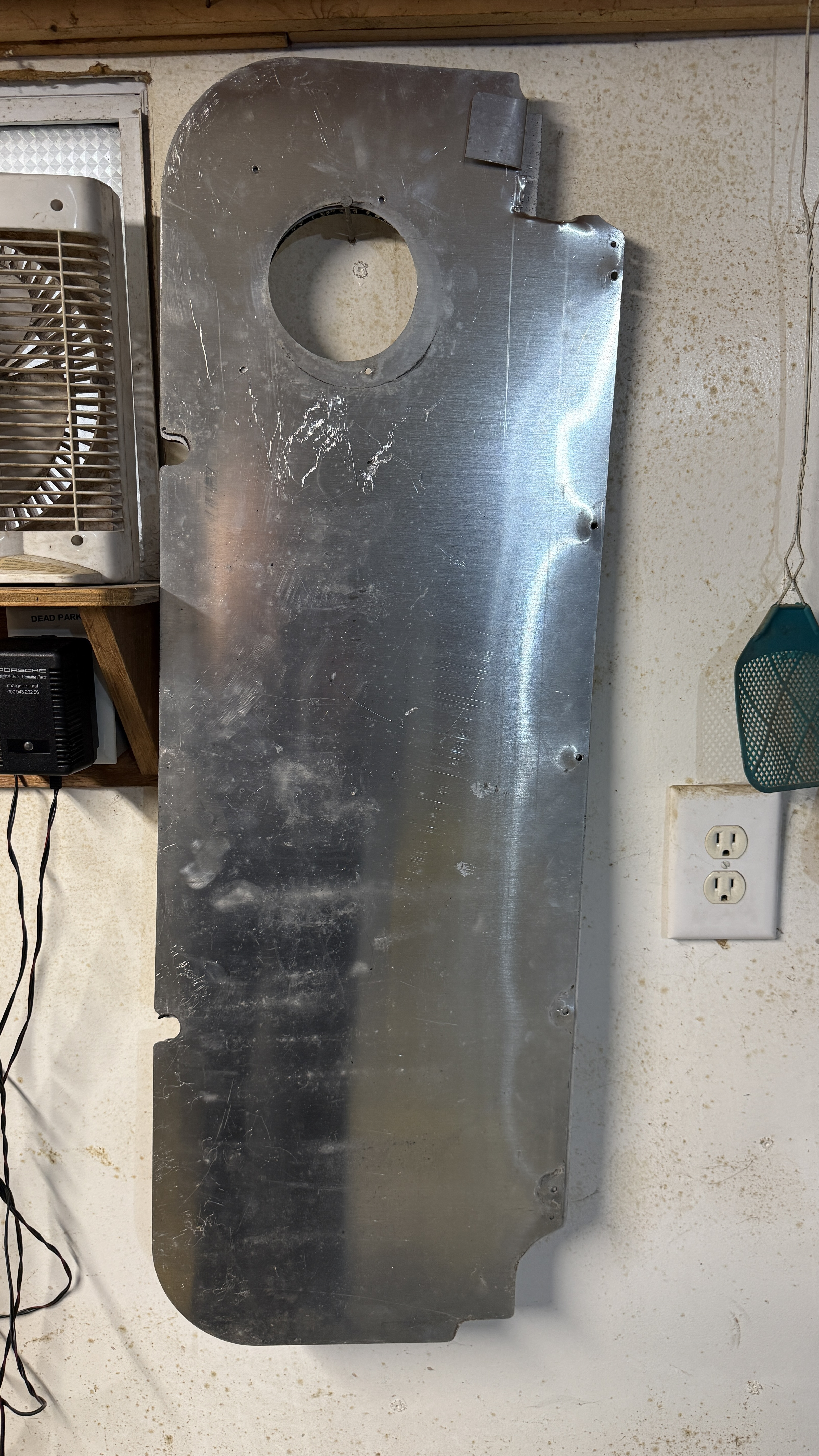

pethier Posted July 2 Author Posted July 2 4 hours ago, KnifeySpoony said: Sounds like a PITA. Would definitely suck to have to pull the rollbar just to take out the boot floor. Not only that. The filler port on the tank is surrounded by the honeycomb, so every time you take out the honeycomb you need to disassemble the filler assembly. Here is my 1991 honeycomb hanging on the wall because I can't reinstall it due to the workaround for the pickup problem in the tank.

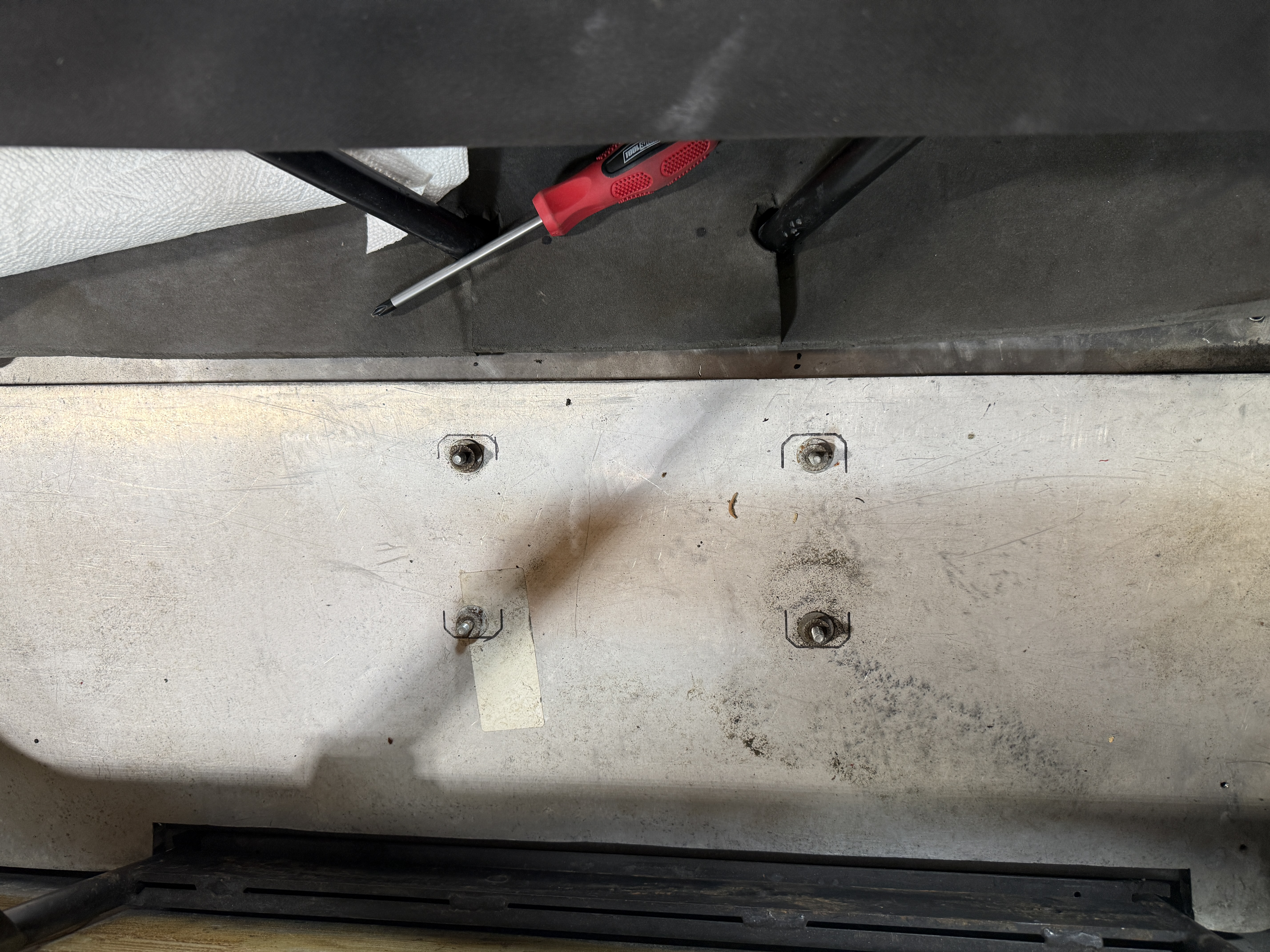

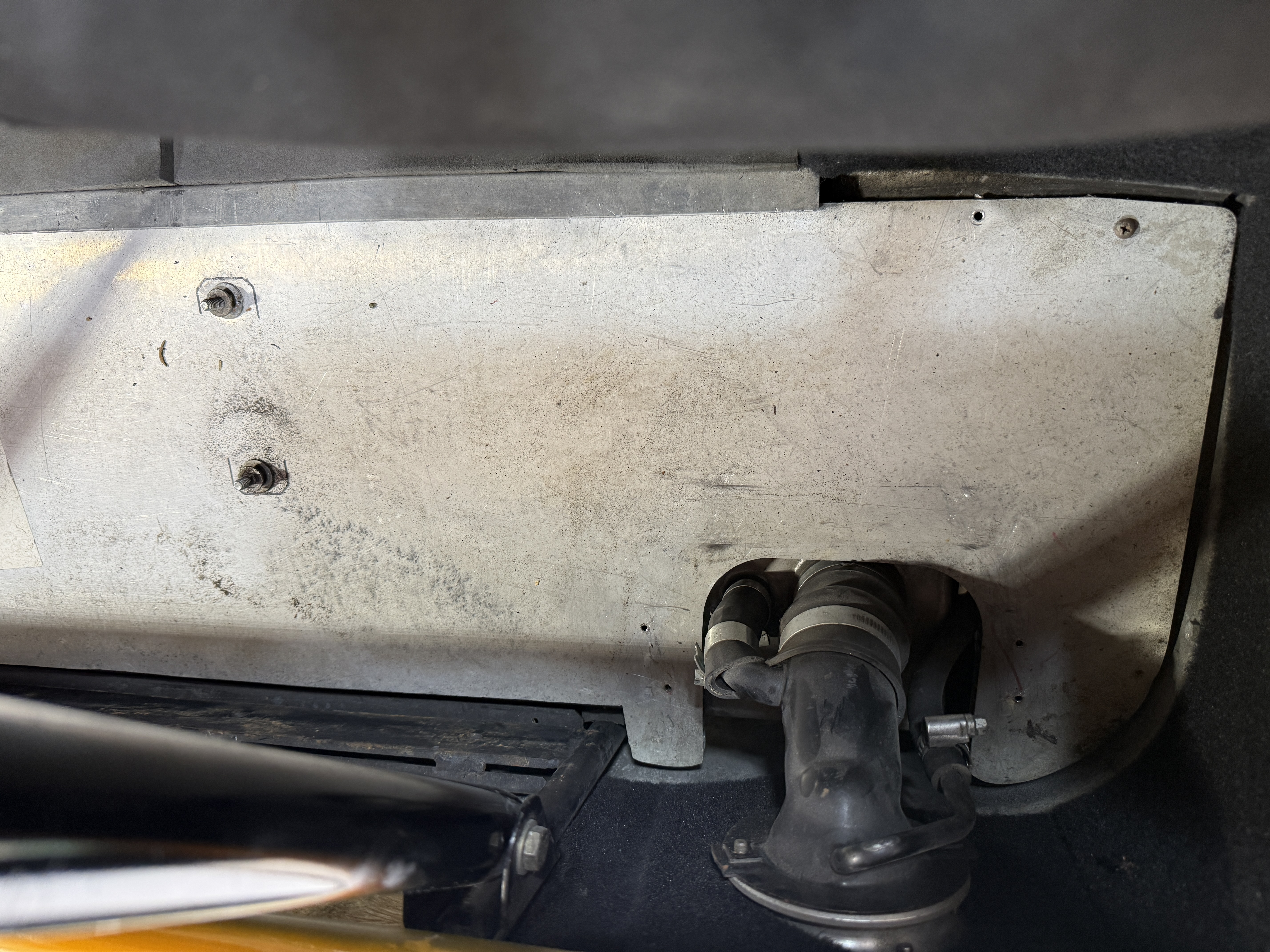

pethier Posted July 2 Author Posted July 2 The honeycomb in the CSR was held in directly only by two screws. Three more screws went through the metal piece which held down the leading edge. These screws did not go through the honeycomb. The trailing edge of the honeycomb had no screws in it all all.

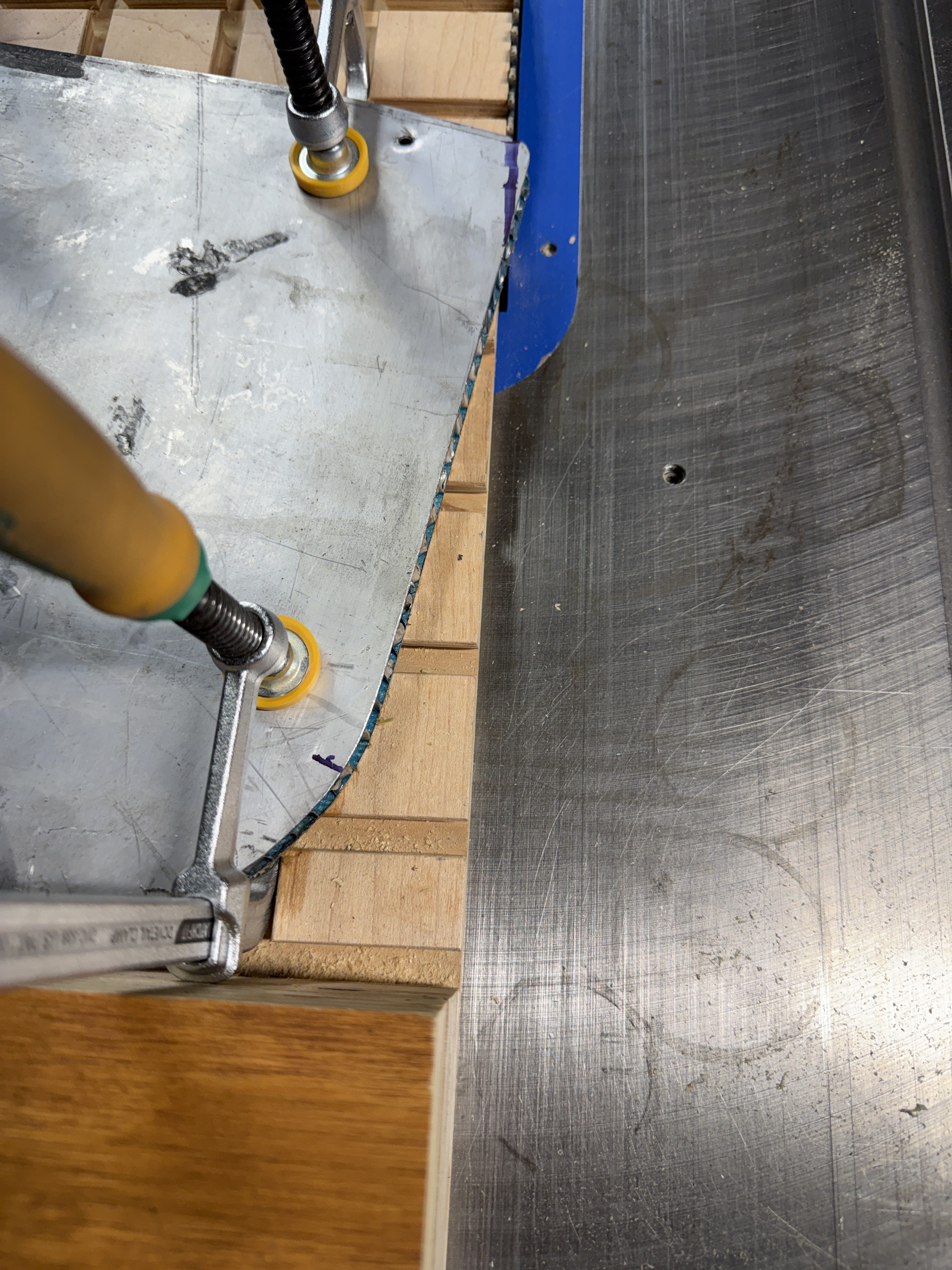

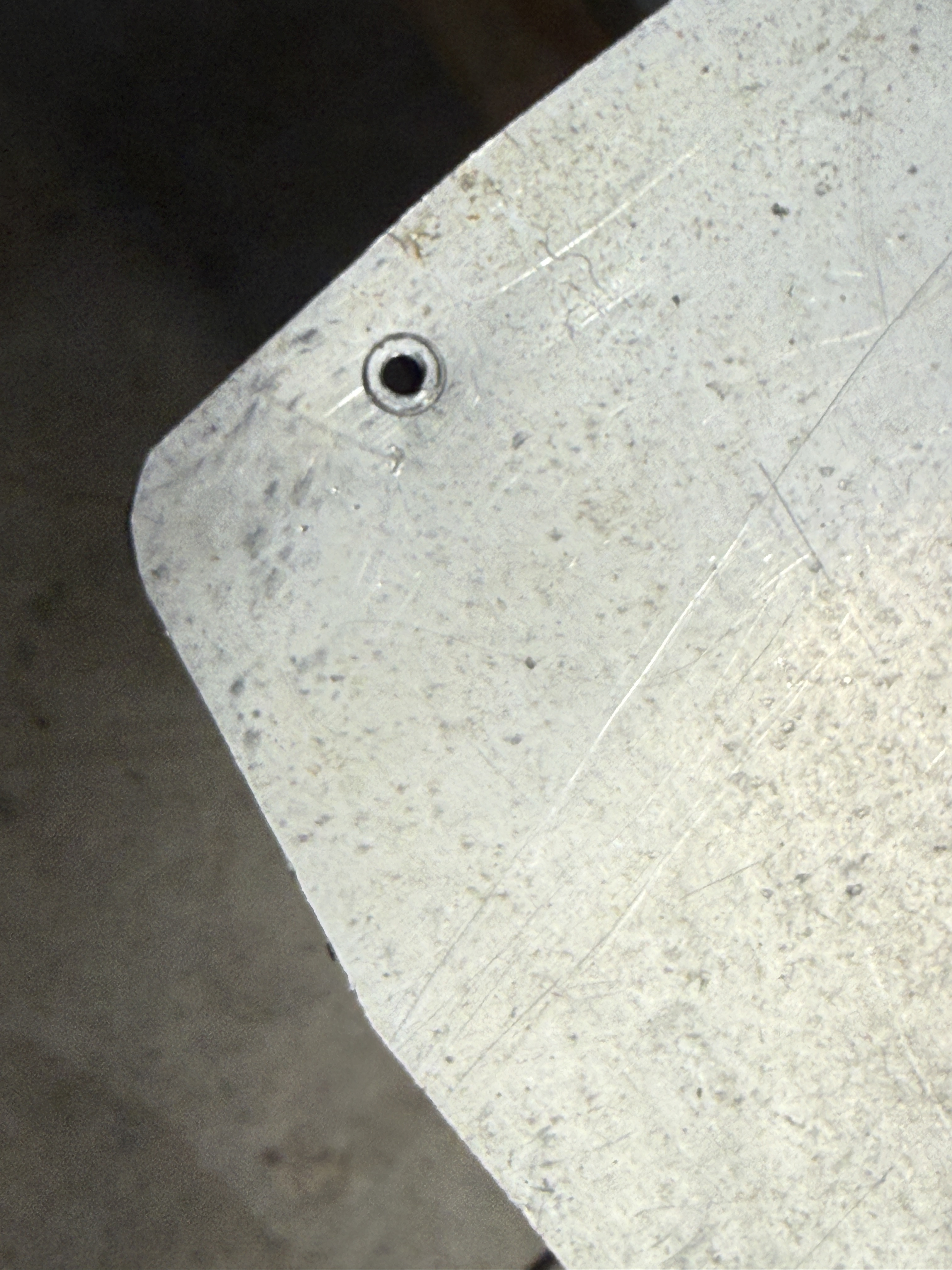

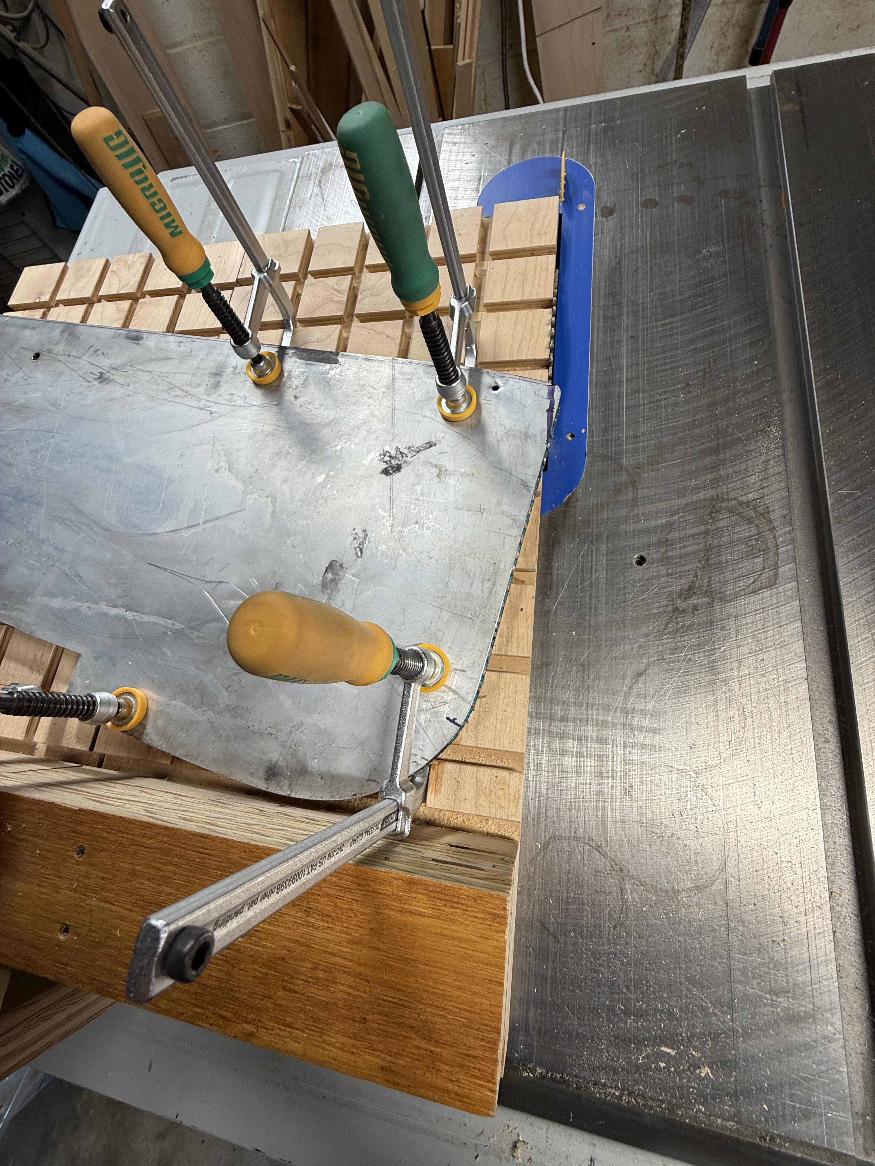

pethier Posted July 2 Author Posted July 2 With some difficulty, the honeycomb did come out of the car. For one thing, the SLR cage does not have the flanges that the FIA rollbar has. To made reinstallation easier, I put the table saw and sled to work. A slight trim to the front corners of the honeycomb should do it. The sharper corner got a bit of rounding from the oscillating drum sander.
