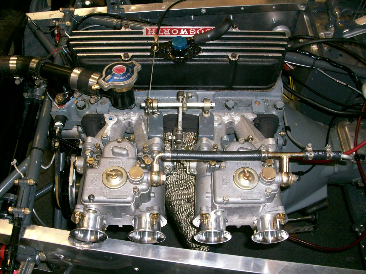

7Westfield Posted Monday at 06:35 PM Posted Monday at 06:35 PM go for it that's how mine is vented, and also most of the Formula Fords in the world it's probably 1/2" npt or maybe 3/8

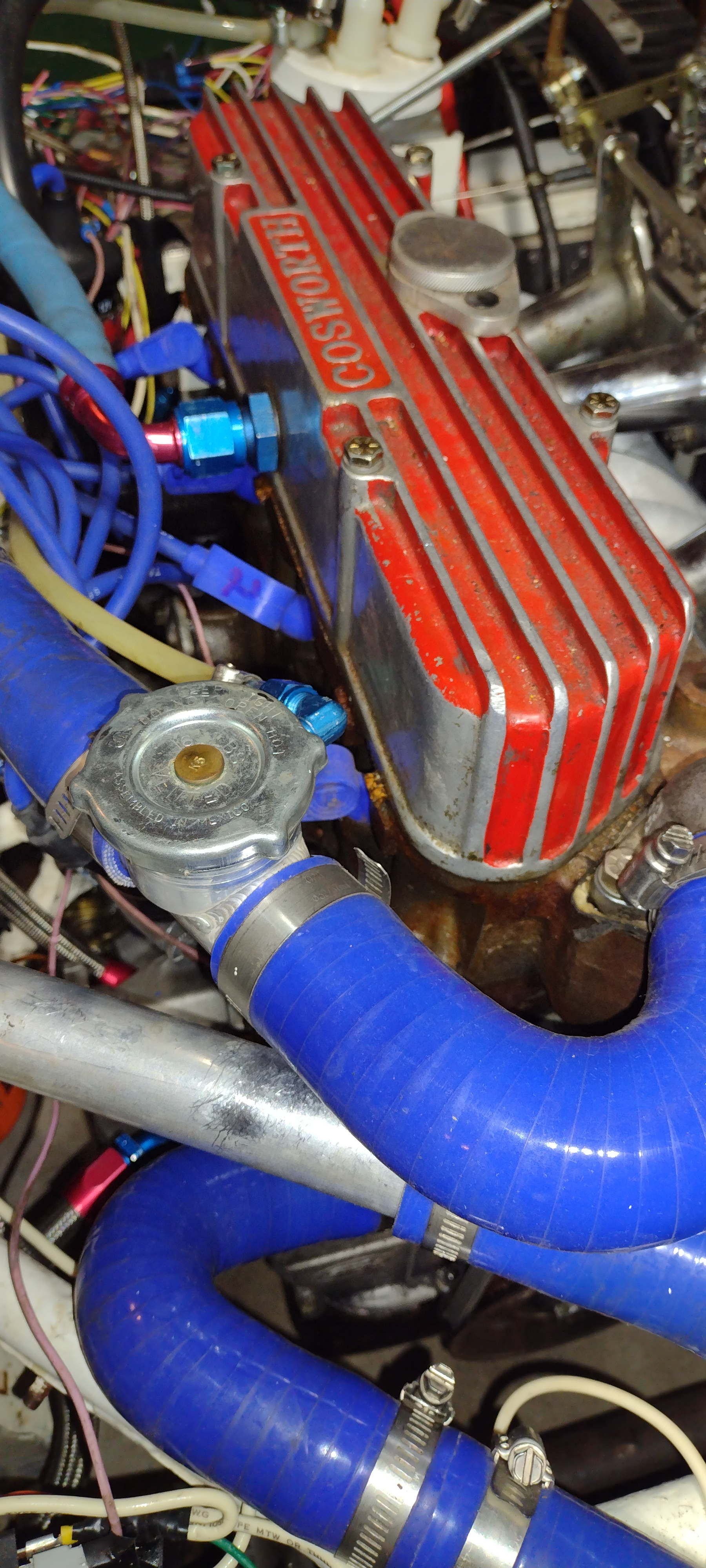

Joe Petty Posted Monday at 06:41 PM Posted Monday at 06:41 PM There is not a lot of room! I had interference with the breather, radiator cap and the corner of the front carburetor. Problem with these Kent motors is that parts get swapped in that are not quite the same as original and you have to make adjustments. Good Luck - Joe 1
Origin7 Posted Monday at 09:45 PM Posted Monday at 09:45 PM 6 hours ago, Rodnok said: My valve cover, a generic finned alloy unit, has a center mounted filler with vent cap that sits too tall, preventing bonnett closure. It has a large threaded hole in the rear with a plug in place. I'm considering finding/making a cap for the filler and using that rear hole in the valve cover as a vent with appropriate piping. Is this a reasonable solution or am I overlooking something? I just installed one of these; it's the most low-profile cap and breather I could find. Still very close to the bonnet. If I had a threaded hole, I'd do it your way.
IamScotticus Posted yesterday at 01:37 AM Posted yesterday at 01:37 AM 9 hours ago, Rodnok said: My valve cover, a generic finned alloy unit, has a center mounted filler with vent cap that sits too tall, preventing bonnett closure. It has a large threaded hole in the rear with a plug in place. I'm considering finding/making a cap for the filler and using that rear hole in the valve cover as a vent with appropriate piping. Is this a reasonable solution or am I overlooking something? Yes. check burton for a blanking solution for dry sump application. Is that a magnet on the freeze plug?
