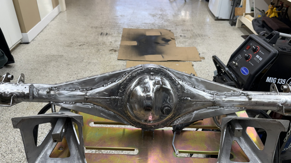

Darcy Posted Saturday at 04:02 PM Author Posted Saturday at 04:02 PM I have been gradually working through the car checking and learning. I purchased on Bring A Trailer. The owner would not allow an inspection of the car and the driving videos were suspiciously short. I knew all was not going to be good. In my only short road test I noticed a nasty clunk under the rear end. I pulled off the A frame and these are probably as bad as you can get without falling off. Searching for parts now... I called Dave Bean, and received a message that they are only open on Mondays and Tuesdays. Are they still supplying bits for Sevens? Their web site is a return to the '90s. I sent a message to Redline, but have had no response. It appears that Caterhamparts.co.uk has some of the parts, but not the bushings at the forward two A frame mounts. Any other suggestions? Any help greatly appreciated.

JohnCh Posted Saturday at 04:12 PM Posted Saturday at 04:12 PM It can be difficult to reach Ken at Dave Bean these days. A few other US sources who may have the parts are: https://rockymountaincaterham.com/ https://www.beachmanracing.com/ https://www.rdent.com/
EdWills Posted Saturday at 05:57 PM Posted Saturday at 05:57 PM 1 hour ago, Darcy said: I have been gradually working through the car checking and learning. I purchased on Bring A Trailer. The owner would not allow an inspection of the car and the driving videos were suspiciously short. I knew all was not going to be good. In my only short road test I noticed a nasty clunk under the rear end. I pulled off the A frame and these are probably as bad as you can get without falling off. Searching for parts now... I called Dave Bean, and received a message that they are only open on Mondays and Tuesdays. Are they still supplying bits for Sevens? Their web site is a return to the '90s. I sent a message to Redline, but have had no response. It appears that Caterhamparts.co.uk has some of the parts, but not the bushings at the forward two A frame mounts. Any other suggestions? Any help greatly appreciated. Hi Darcy. I have brand new spares of the bushes that you require for the 'A' frame, and you can have them for what I paid for them plus postage from Calgary to Kelowna. Let me know if this if of use to you. W
