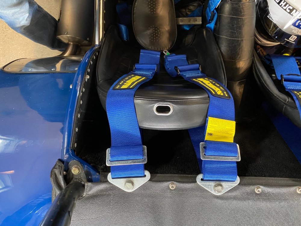

5th and 6th - 6-pt harness.
Makes sense Jim. I had to think about it for a while to understand why 2 plates, but I get it. Nice work. The screws that mount the belts look pretty tiny though?

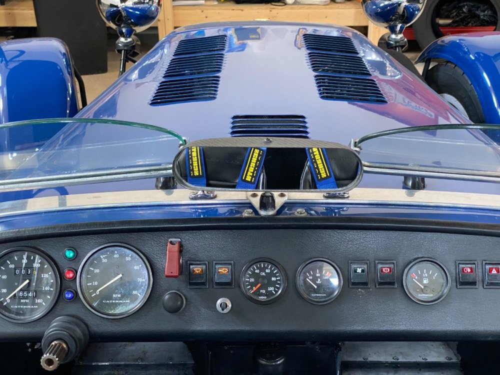

I'd like to raise the rear view mirror that is mounted with my Brookland's screens. I've seen an extender for this on other cars. Is that an off-the-shelf part that I can buy, or do I just make one?

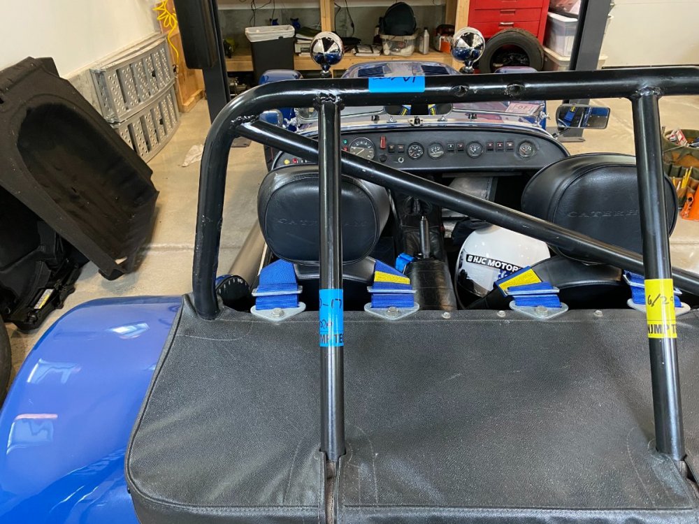

For this season I have bought a new helmet (Snell 2020) and this head and neck support: https://www.schroth.com/en/segments/racing/products/details/show/id-20-shr-evo-medium.html I just tried them out in the seven. I tightened the shoulder belts as tight as I could, and I was surprised at how easy it was to move the shoulder belts around on the HANS (ok - this one is an "SHR"), especially on my right side. I could shift the right belt further to the right, so it was no longer centered on the SHR. Then I realized that the belt mounts are not centered with the seat (see pics). Belt mounts and seat position are standard Caterham S3, so I am guessing that others have encountered this? Advice?
