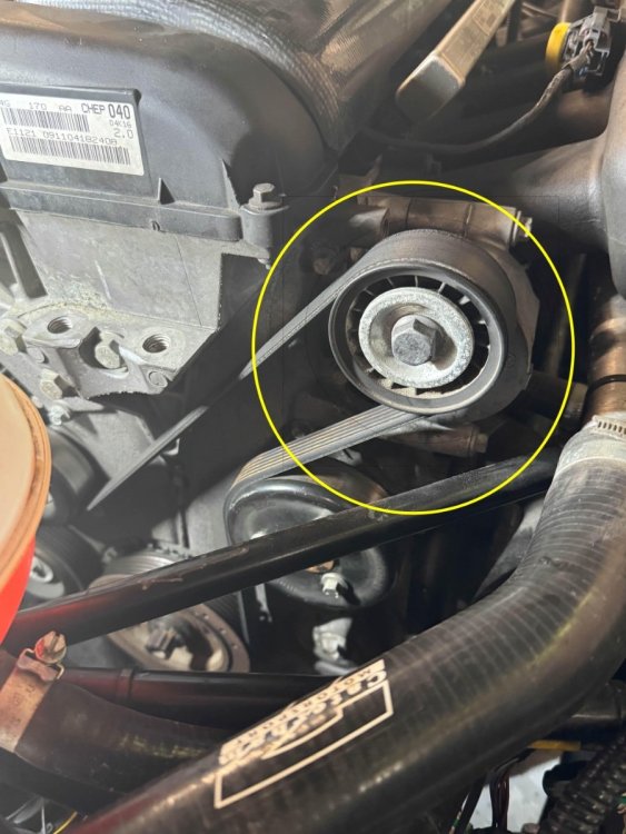

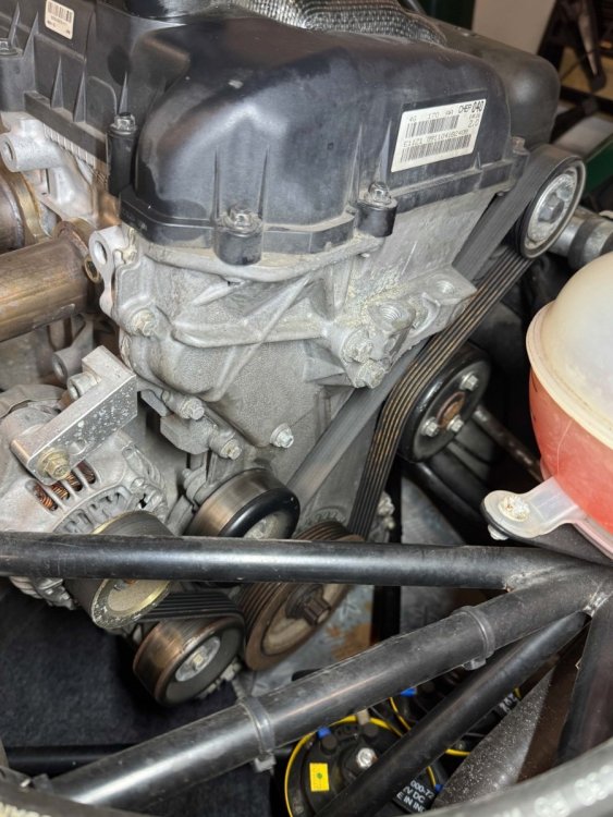

  16. Thank you, I was thinking you may need to loosen the pulley belts before removing the belt. It appears to be coming from behind the water pump pulley so I am pretty sure that is where th problem is. When I looked on line it appears some may have metal impellers. See if you have one in stock
  17. I have developed a coolant leak that is likely from the water pump. Is the yellow circled item in the picture the belt tensioner? If so, do I l just loosen the nut to allow belt removal? Do I need to set the tension on the belt after assembly or is it pressure fed and automatic? A quick search found lots of water pumps at all sorts of prices, any recommendations or are they all pretty similar (or are the cheap ones plastic impellers and some metal?) Thanks Jay
