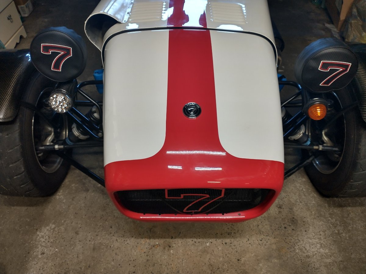

To get my mind off all the other troubleshooting I decided to add some brightness JAL lights. Outstanding customer service and great product. Clear lights are now very visible in the day time.
