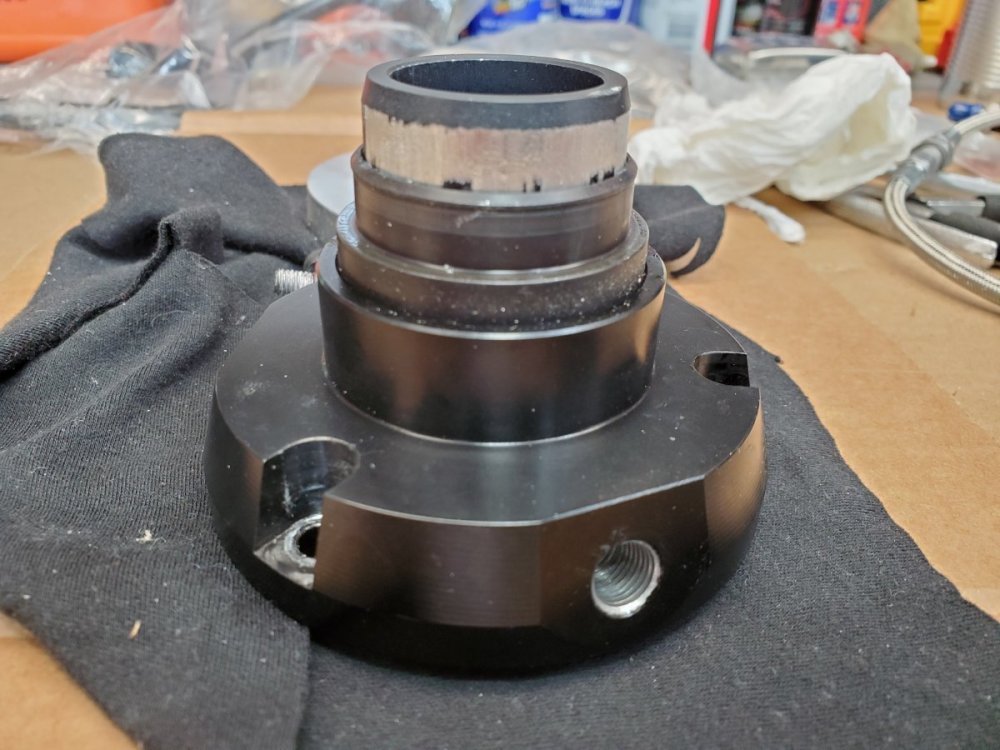

Hope all are doing well. Pulled the Crossflow engine yesterday to see why concentric clutch was leaking, first photo is what I found. Not sure what caused this? Would like to go to an external slave set up, to limit risk of having to pull engine, and my frame does not have the welded bracket for cable type (not that I would want a cable). Car is RHD 79 Seven. Current bell housing is Burton BH6 which is a cable set up one. Been all over various sites trying to find a Bellhousing with starter and external slave mount that will work with my car, engine, trans set up, but all found look like either the starter or external slave mount will interfere with the pedal box. Any inputs greatly appreciated! V

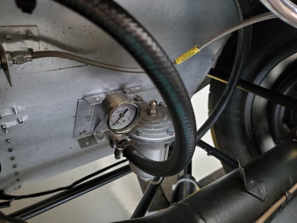

JB, Yes, on the gauge. The pic was taken when installed, and not yet run to set up. The kit comes with a note that the gauge is "for initial set up only" and has the brass plug to go in its place.

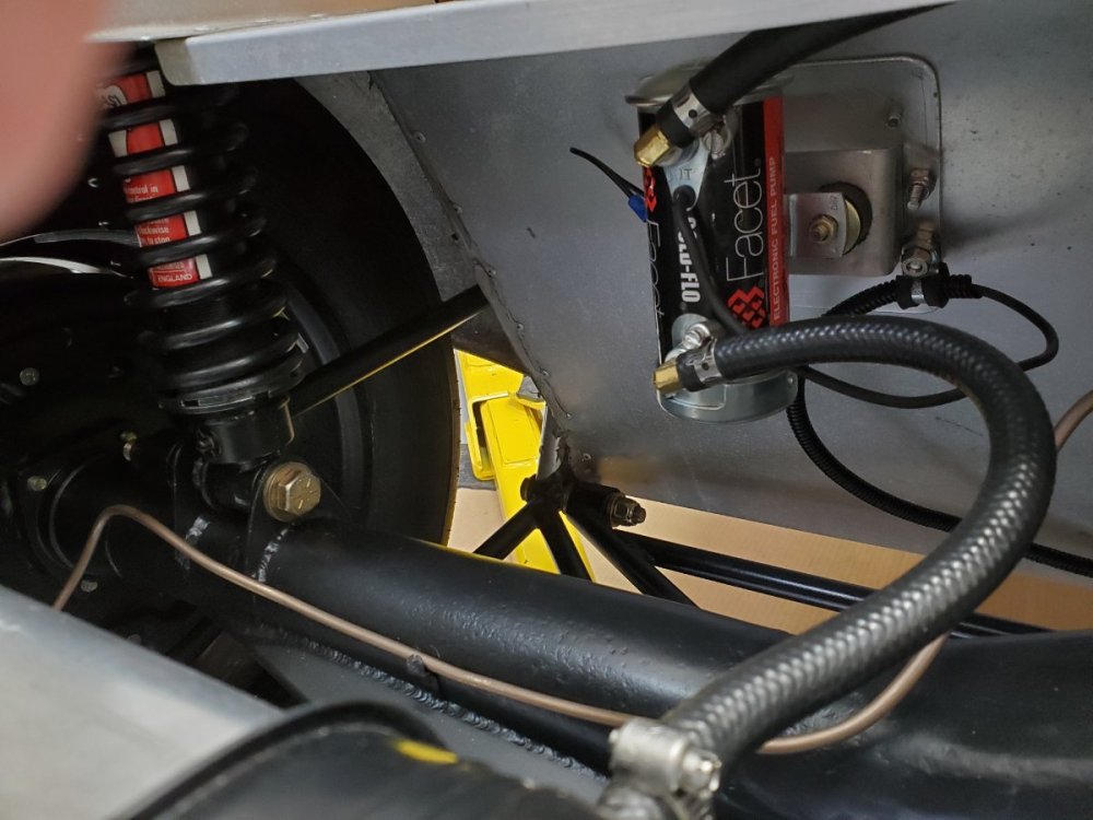

Here is my Facet fuel pump installed on rubber isolators on bracket I made. This feeds regulator / filter set up on the other side w/ fabbed bracket in second pic. Never hear or feel it with car running. Remember to put ground wire on pump when using rubber isolators...

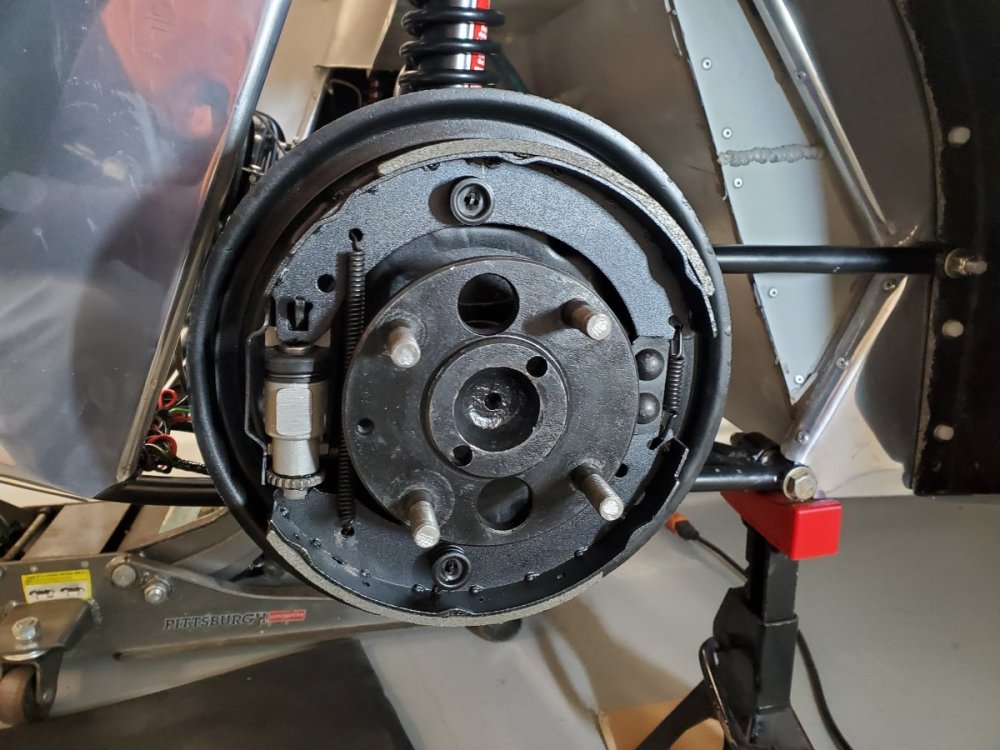

Scoticus, I have gone through quite a bit to get the drum brake set up on my Ford axle. The brake backing plates are 9" from a Mercury Capri 4 cyl. The drums are Cortina MKII GT (9"x2") The wheel cylinders are stock 71 Capri ones. Most of the stuff is Cortina and lots of Capri Stuff is the same. Go to motomobiles web site, lots of info there for reference, but I got the same ones at Rock Auto. I don't know what the original back plates were on a Ford axle Seven, still would like to. Best to you, V

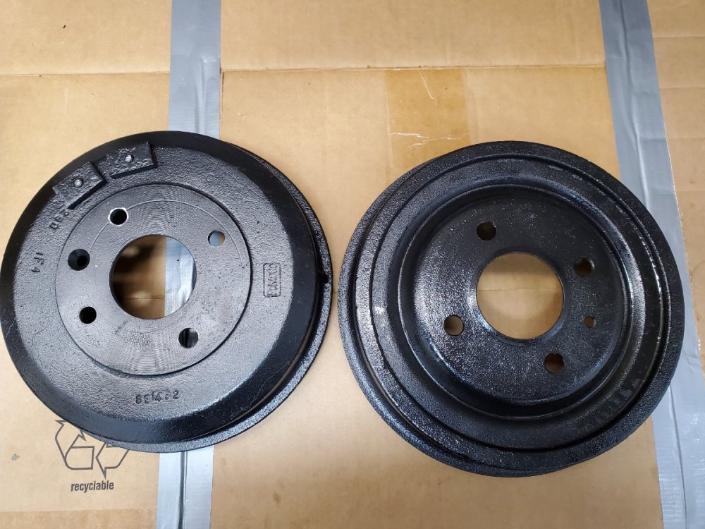

All, I purchased a drum from someone who has 14 Cortinas. Per his expertise and, my measurements, and his review of photos, my axle is MKII Cortina GT which had the 9" x 2" drums shown in the photo above. The drum is exactly the same as the barn parts one and fits perfect. Having it resurfaced today, going to fabricated E brake linkage set up, and rear end issue is resolved. Now onto hydraulic clutch leak, and oil pan ground clearance mods... Cheers, V

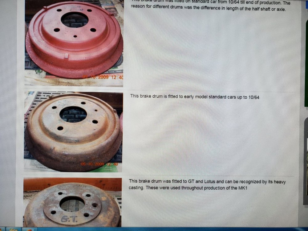

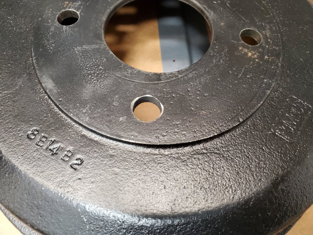

Thanks all for the inputs. I have plenty of company in the parts that don't fit arena, with many friends and car repair shop owners confirming the same, whether new car or classic, rare or common, it is just harder today to get the right part for anything. Not a complaint, just a very well supported fact. Miss the days working at Junkyard looking at a paper cross reference book, hopping in the "torch" car (VW Bug we cut the roof off and stuffed the Ox/Ace set up the back seat) and fetching the right part. As for the Cortina, my research tells me only the GT had 9" (229MM) rear brakes, so that eliminates a huge swath of the production, since all others were 8" (203MM). The rear axle housing has no numbers on it (none do) and is confirmed as GT by its flange to flange width and the flange to axle flange face width. Even better, I have one brake drum that came with the barn find car/parts and fits perfect (using 4 cyl Capri brake backing plate, that after hours of research, are the same as Cortina GT). (See photo with Correct GT drum on left and Capri 4 Cyl drum on right which does not fit). Not sure only one drum was found in the Barn. See also, part #on GT Drum, which no cross reference can be found, and photo from the Cortina owners site, with drum differences. Cheers, V

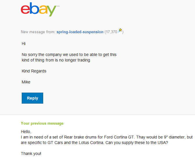

MV8, Saw that in my web search. Photo is for reference only, so I ignored it. I have messaged the company to see if they can confirm it is for the GT. I am returning the third set of drums from various others that do not fit. Thank you for the help! V
Hey all, Looking for one or a set of rear brake drums for a Ford live axle Seven. They need to be Cortina GT 9" type Drums. See photo V

Just refitted rear with the radius arm / shock weld bracket relocated to the 12 O clock position, and Capri 9" drum brake set in place of disc conversion kit. Huge difference in tire clearance! Tunnel clearance is tight as is expected, but looks to be ok. Can't wait to drive It!
