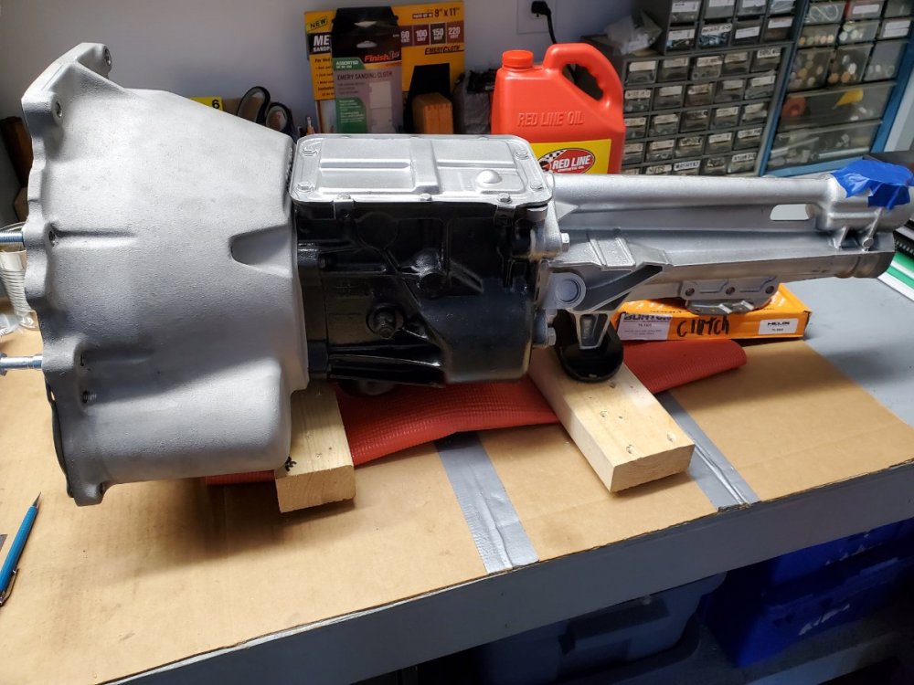

Attached are the trans and bellhousing ready to go in. Mount is the same either way. You are right about the shifter placement too. As another test, I sat in the car and my left hand is under the dash without having my arm full extended, so should not be a problem. Will have to modify the Quaife shifter I bought, cut and/or bend. -

Modified Burton bell housing by rounding off square area of shift for opening. Finally got the engine & trans in car for test fit. Holes on trans mount are about an 1/8" too forward so will drill mount, NP there. The shifter seems way forward, and the engine seems tilted down towards front, making me wish I had a thinner trans mount. It was suggested that I cut some of the V part of that goes in the the trans tail shaft casing to lower it. Does not look like there is much to work with there, so I am reluctant to do that. Research on UK sites, leads me to think Arch had a different frame cross member for Sevens with Type E, Escort, or type 9 trans? -

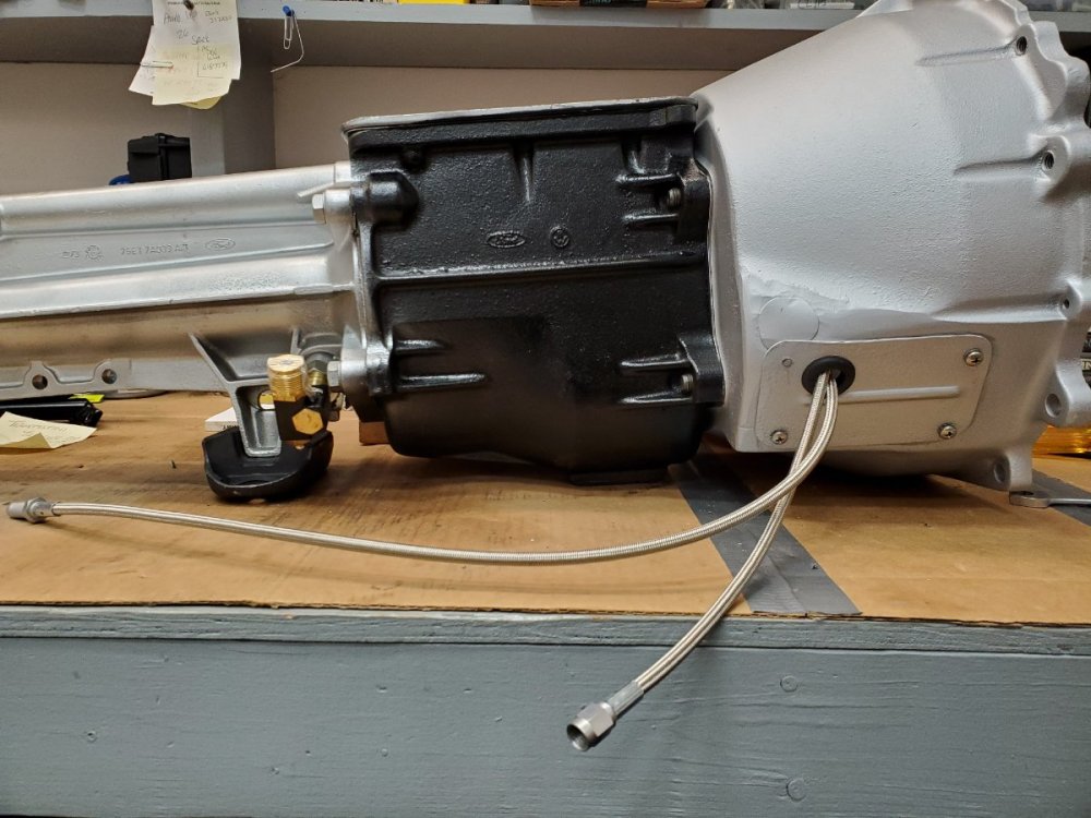

I am thinking since I own the BH6, I will cut away the part of the clutch fork opening and have a piece welded in with a hole & grommet for the hydralic feed and bleed lines. Got nothing to lose by trying. Still curious as to what Lotus, Caterham used with LHD cars with this engine & trans -
Hope all are well, Trying to engine / trans combo. Got a BH6A Bellhousing, which has the starter on the left, from Burton, and does not clear the pedal box. I am using a concentric hydraulic clutch set up, and the raised area where the clutch fork would normally go, is where it hits the pedal box. Hoping someone has run into this and can recommend the correct bellhousing? V

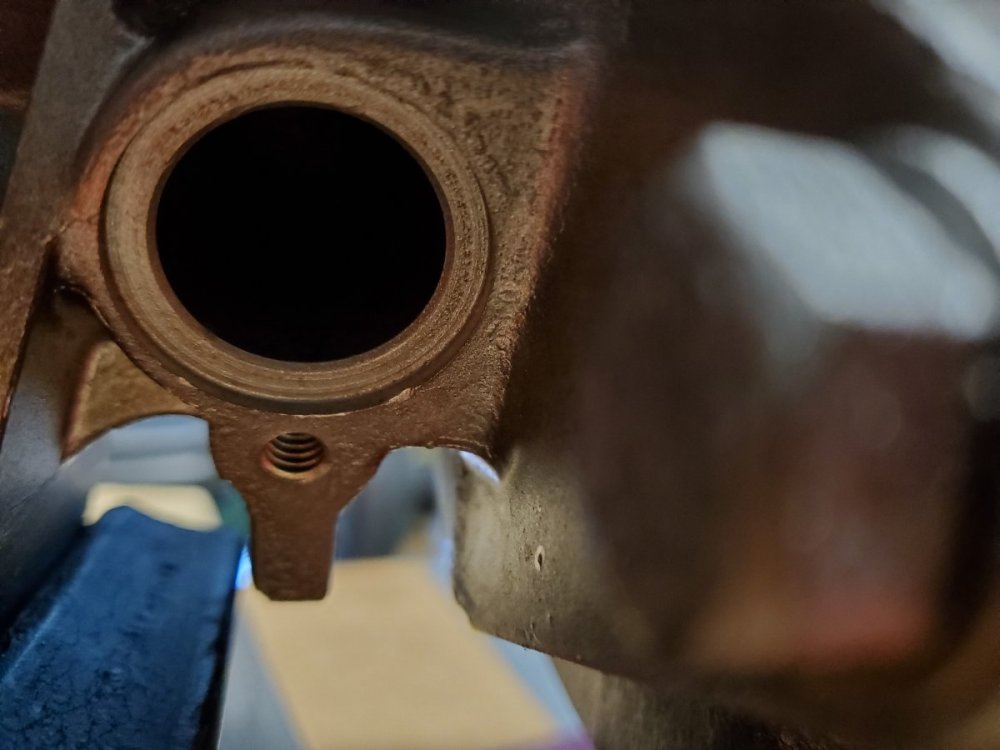

This is the input. Not finding any right angle adapters with this type of cable input, only threaded type. Did find an adapter to go from this Ford type to 7/8" GM. Might have to do in two pieces? Will send pics to Kelvedon..
