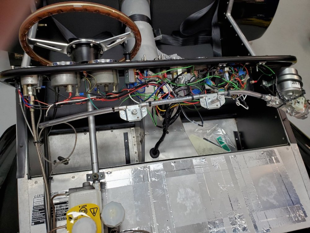

FYI on the pic of the wiper motor set up. I slid tygon tubing over the wiper metal tubes and zip tied them, just for added protection between them and wiring

To follow up. Part # 60027020A from Caterham was made to work with relative ease. Had to shorten and re-flare the tubes between the motor and left wheelbox and the tube between the wheelboxes, and make / flare a longer tube after the right wheelbox. No big deal at all. With shipping, still worked out better than getting just the motor (with no core return) this side of the pond V
