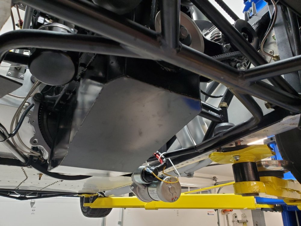

Better pic of Ivey gasket on pan I removed due to ground clearance issue. Twice as thick as the ones that came with stock gasket kit

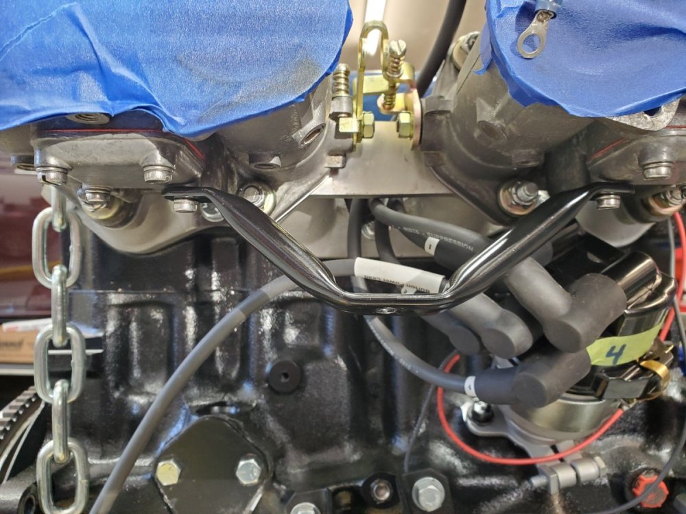

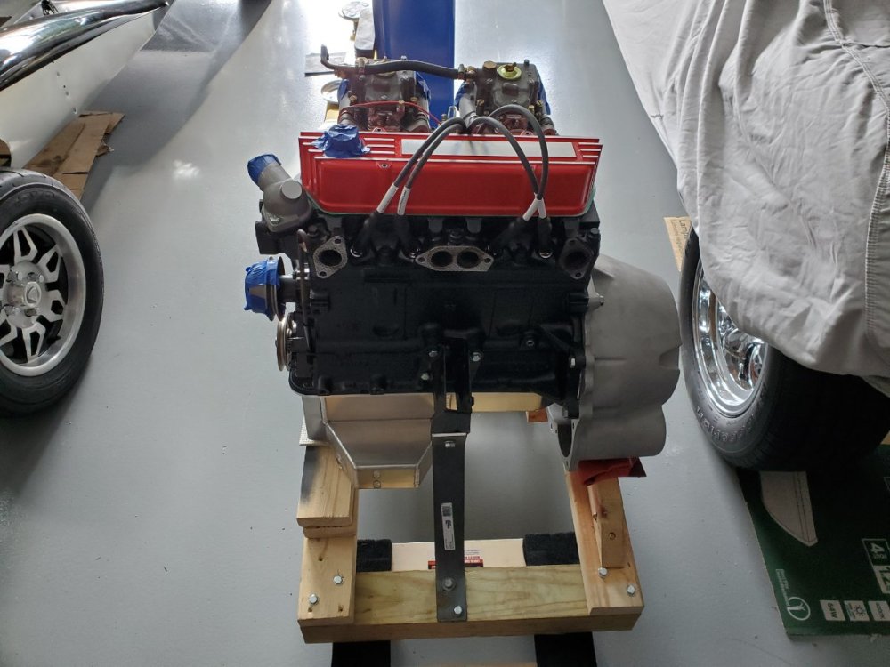

I had to make a throttle cable bracket and a vibration brace for the carbs. Had vacuum leaks at the carb with the soft mount kit. used regular washers with the rubber gaskets, carbs finally leak free and able to be balanced. I managed to get the exact same oil pan you have from a club member. I had to modify the holes on the non carb side to make fit, but has worked out awesome! I used Permatex Ultra black and the front / rear main seals are great stuff I got from Ivey Engines. Although it works, next time I will use Permatex Tack to hold the Ivey gaskets to the block, they overpowered the Ultra, so it two of us to keep them in place when putting the pan on.
The x cross member in front of the engine helps. Mine does not have it, so I had slit a piece black irrigation pipe to protect it. Glad I did, since I had the engine in an out five times.

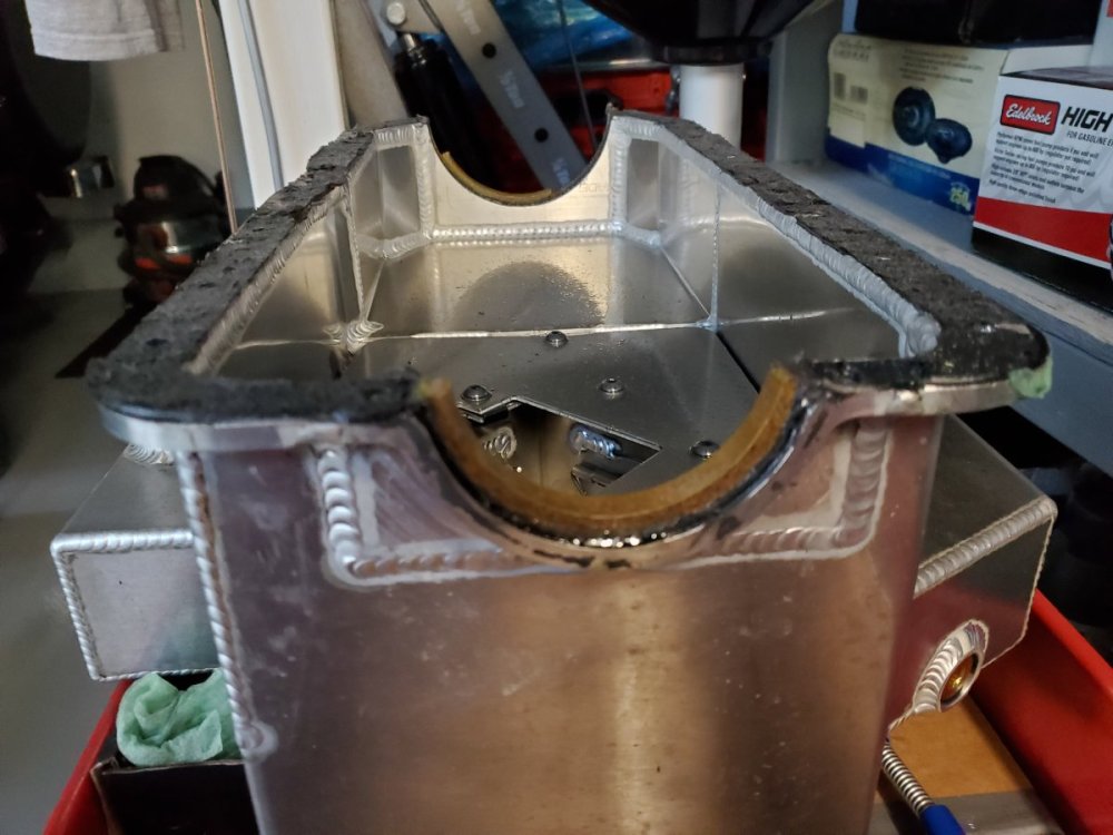

Looks great, I like the baffle set set up. Did you make it?
This is the pan. Has a really nice four way baffle system. Note that, although wider, it is the same height as a stock pan, meaning you will not gain any ground clearance. That is why it is best for track use, or maybe a car that sits higher than mine. The guys at Ivey are great and were a lot of help. Many more photos of this pan on their web site https://iveyengines.com/parts/ I will probably sell mine since I don't see me swapping it back for track days.
